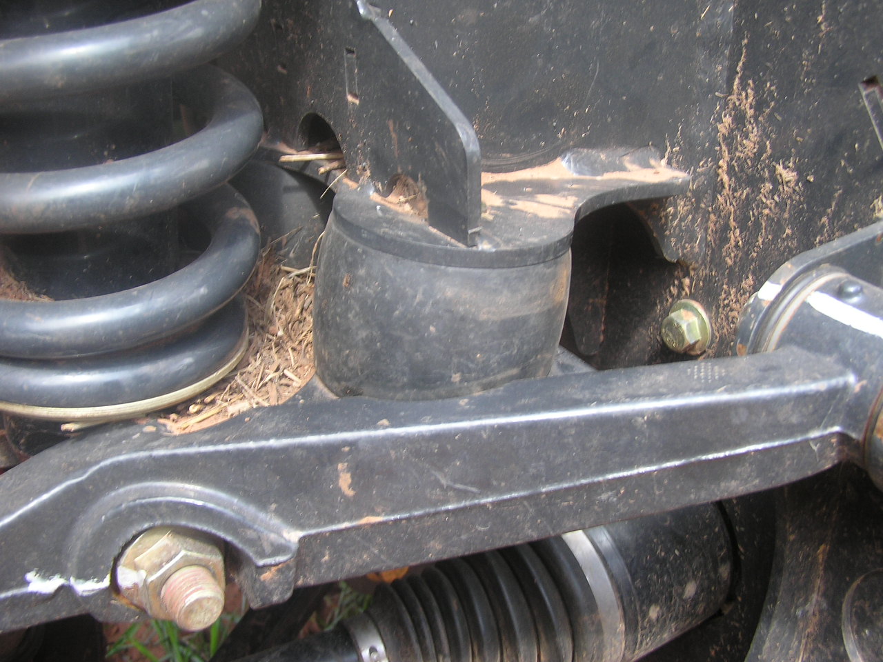

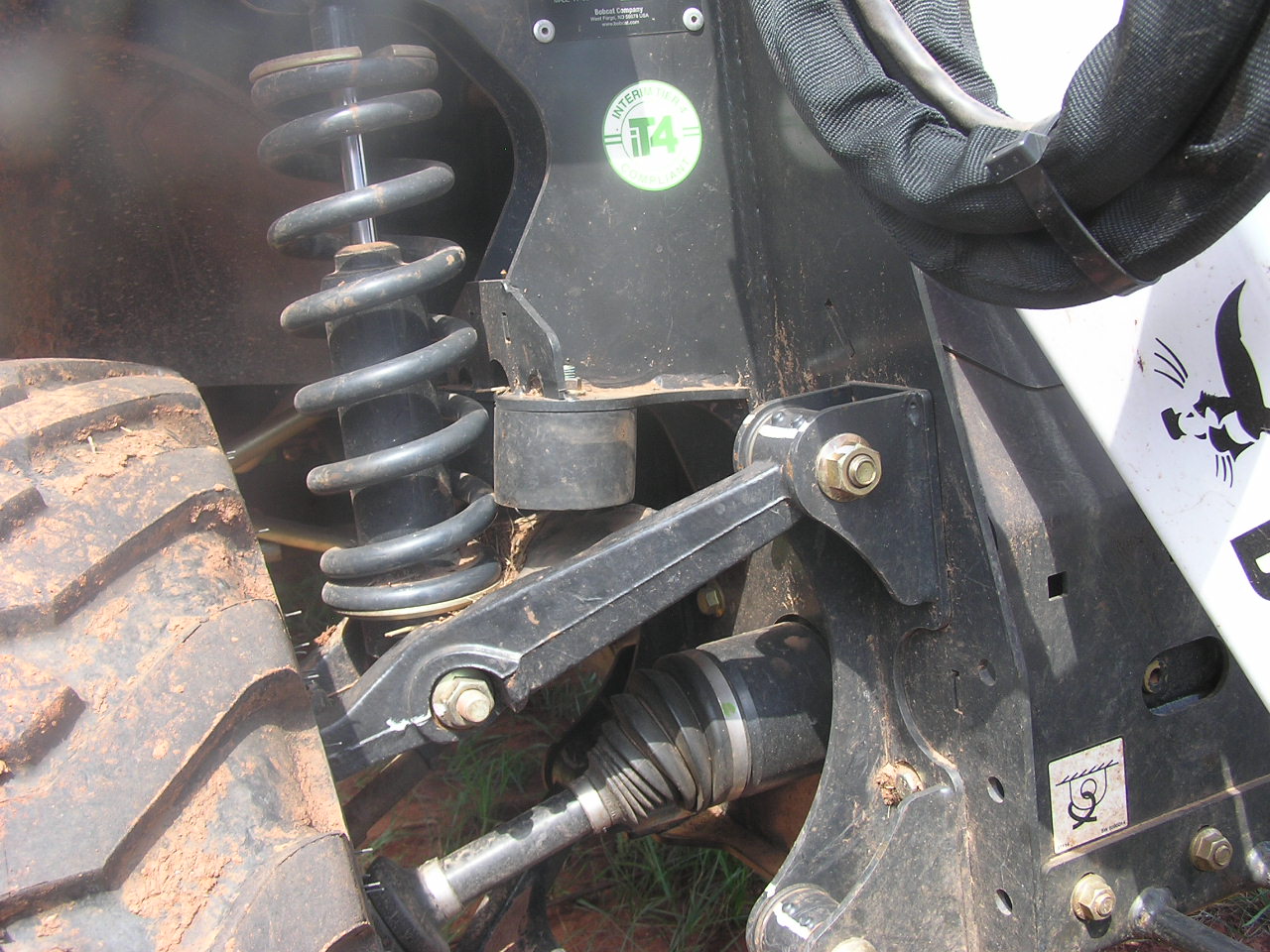

I have thought about cutting off some of the rubber on the A frame stops, to get a little more suspension travel. I think it would lower the height also.
Here it is with the front wheels off of the ground.
And with the wheel on a 4" thick block and the 800 pound bucket in the air.
Quite a bit of compression.

Thanks Xfaxman. Been on this site a long time just never joined. Don't like typing, spelling or computers very much. My tires are r-4. It would be nice if Bobcat could get the specs right. A couple of inches can make a big difference.Mine is almost 2inches taller than spec.I would be careful in shortening the rubber snubbers because the shock travel is minimal. You sure don't want to be bottoming out the shock all the time. I like your rock truck. What year is it?
