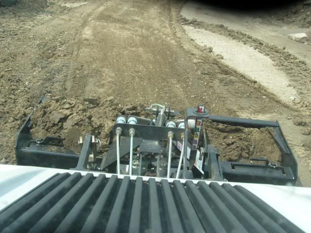

Rear view from the cab.

I'm thinking back to your post of July 17 where you mentioned that there were only 2 rear hydraulic outlets. Don't these rear view photos show 4 outlets?

It looks like there's only one cylinder for the 3-pt hitch lift. Don't tractors usually have two?

I didn't take any pictures inside the cab. The lever that lifted the box on the 5600 is the same lever that now lifts the 3 point. You see 4 connection outlets in the picture. 2 outlets for each cylinder/set of hoses. Can't run 3 separate cylinders. The controls for the rear hydraulics are rocker type switches that sit right behind the 3 point lift lever on the center console. They are run electrically and not mechanically and therefore no "hydraulic lever".
The single lift cylinder on the 3 point is not a bad idea. I see some ag tractors that have a single, assist cylinder on the rockshaft. Bigger tractors needing more lift will have 2 cylinders on the lift. The rockshaft seemed very well built and single cylinder should be fine. No need to 2 small cylinders if one single can do the job.
I didn't think about using the rearview mirror to see the attachment. The pictures I took were taken looking backwards and to the right from the driver's seat. I am 5'10 and want a good representation from the seat. If rearview mirror sits higher and I would think the view would be better or similar.
I would have to believe the higher placement of the fan should be much better for keeping the radiator clean. Ideally, the screen should be much larger and stand several inches away from the radiator like I see on most tractors. This would allow a much larger surface area and slow down the velocity of the air coming through the screen.
Controling the rear hydraulic from outside switches is a nice idea but not available on the 5610. Some cab tractor have switches on the rear fenders but not here. An advantage of a open station tractor is that you can reach from the rear to move the hydraulics. I have a cab CUT and it is a little trial and error on hooking of the hydraulic top link on some implements. In the cab, out of the cab, back in the cab, and out of the cab..... I will still take the cab over that inconvenience.:)

Looking at how far back the 3pt hitch arms extend, I wonder it that was done for some technical reason, or just to make the work area visible? I looks like the links extend just beyond where you can see over the engine cowl.

The lift arms are longer than my JD 3720 which has lift arms about 27-28". The 5610 is probably closer to 33-36" but I didn't specifically measure them. When looking at them they seemed similar in length to a 8N/9N ford lift arms in length and thickness. The rock shaft arms seem a little short. Maybe the longer lift arms are a result of the shorter rock shaft? Longer arms will give more range in the lift. Improved visbility maybe the biggest reason.
