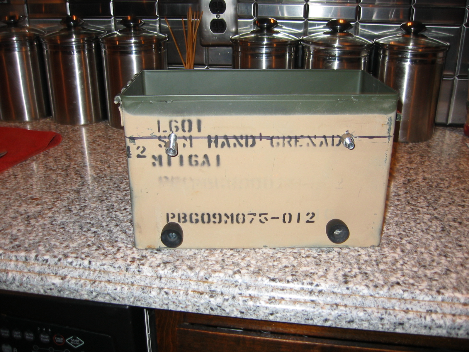

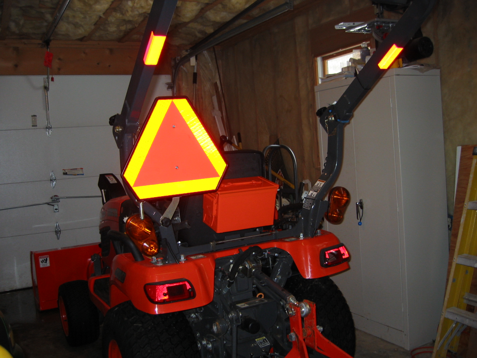

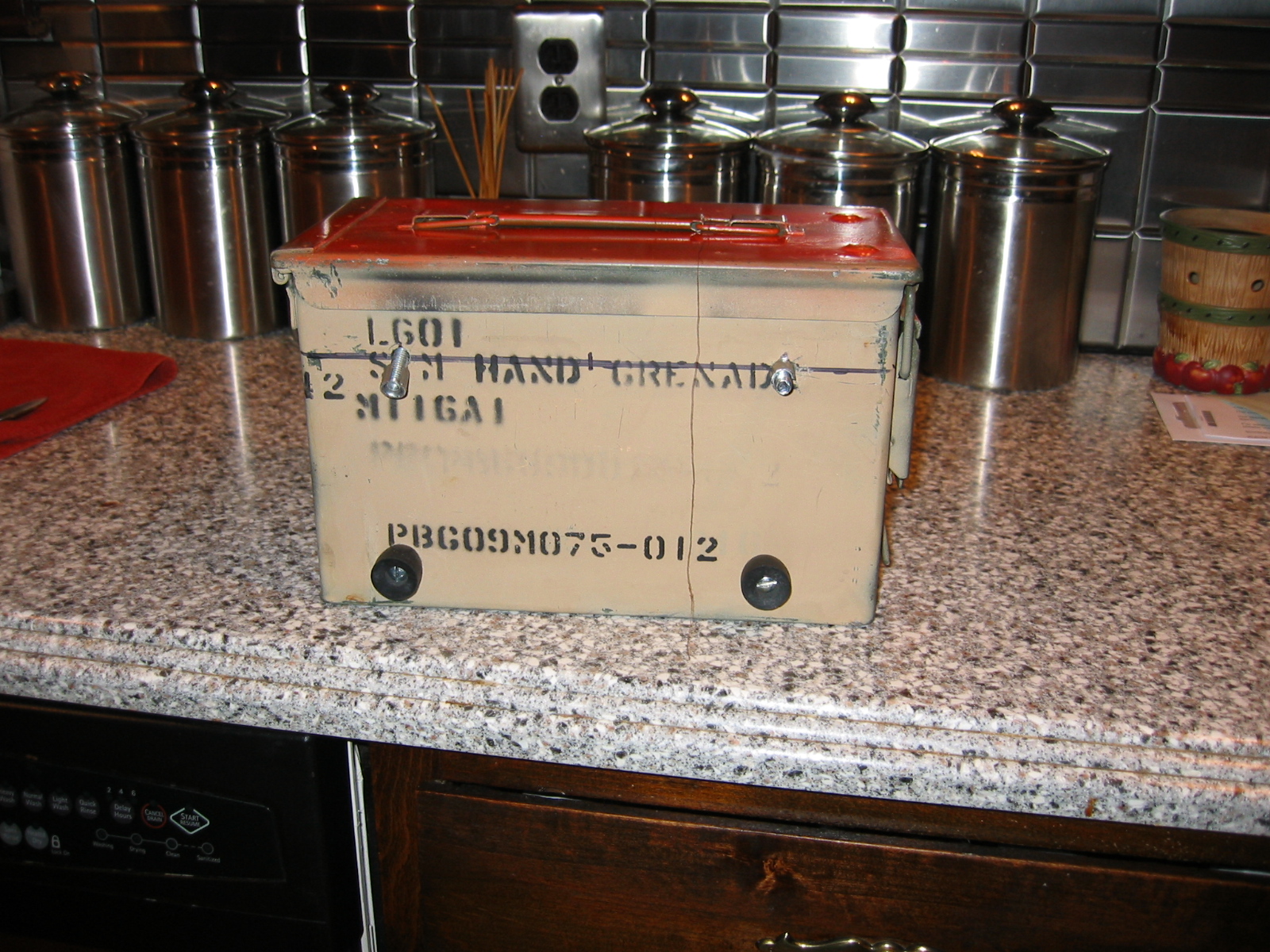

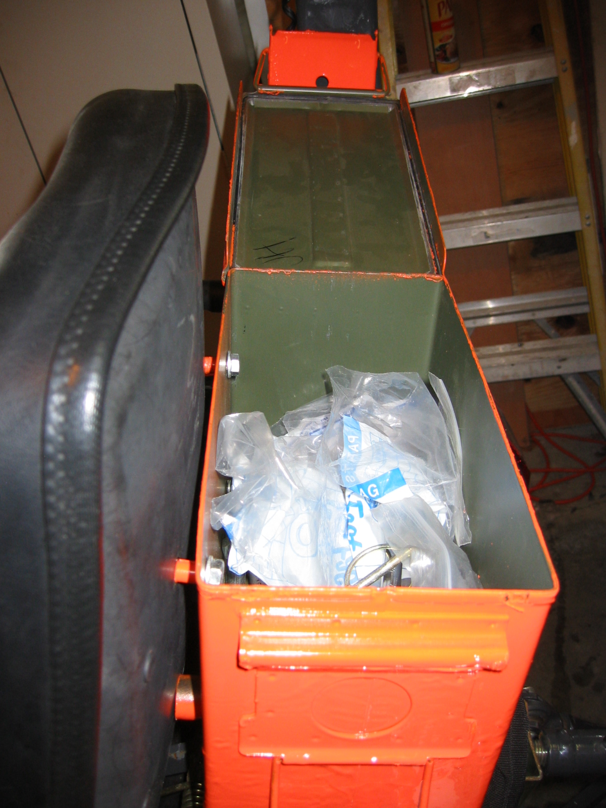

I followed an old post for adding a toolbox to my BX25. I ordered a 50 cal.ammo box from ebay for $12.On the back of the seat you'll find plastic plugs that are set up to receive bolts.The holes I used were 7"on center.I drilled some smaller holes towards the bottom of the box to add rubber bumpers. It's great for storing wrenches,shear pins and misc. stuff and it doesn't get in the way of anything or when turning the seat for using the backhoe. The paint job came out bad,but that's because I was in a hurry,but I'll take it off in the spring and do a nice paint job on it then.
