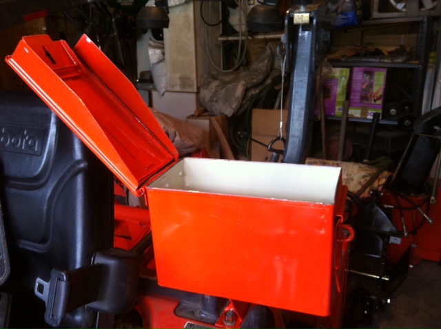

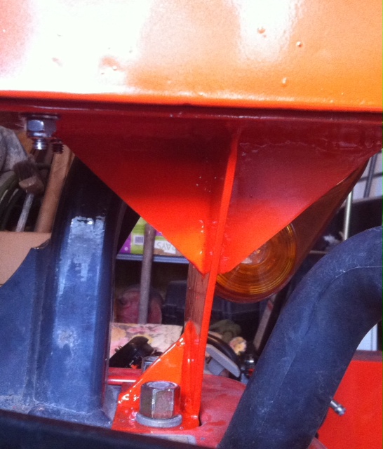

Couple of quickie pictures of the toolbox and bracket fabricated for my BX. It's an ammo box bolted to a 3/16" plate steel bracket. The box and bracket were sand blasted, 2 coats of POR 15, 2 coats of spray bomb gray primer, and 3 finish coats of Kubota orange. Actually twisted apart my 1/2-3/8 reducer to get the 3/4" nut off the base of the ROPS. Gott er torqued back in though! toobox 1.JPGtoolbox 2.JPGtoolbox 3.JPG
   / Toolbox finally completed! #2
Nice job :thumbsup: I really like that bracket you fabbed up.
   / Toolbox finally completed! #4
Nice, the bracket looks stout enough to compliment the ROPS!
   / Toolbox finally completed! #6
Nice work! Like that you painted the inside of the box white (cream?) as well--that will make it easier to see small items, especially in low-light conditions.
   / Toolbox finally completed! #7
Looks good and strong.
   / Toolbox finally completed! #9
Looks good
   / Toolbox finally completed! #10
That's a good design, and well executed. :thumbsup:
