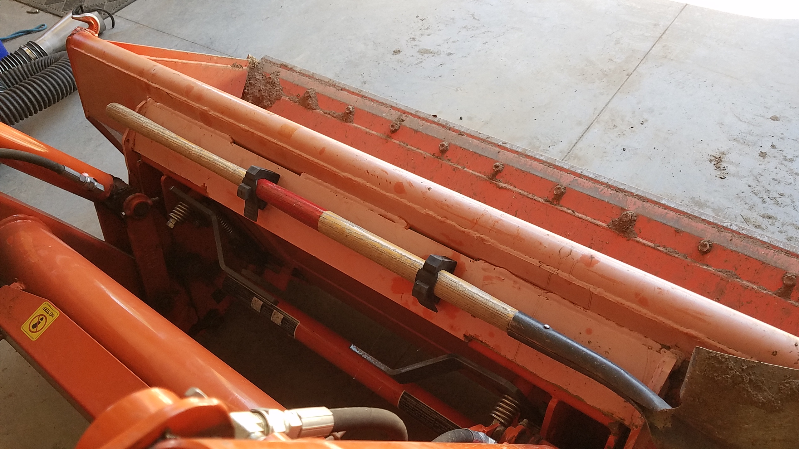

I mounted a pair of Quick Fists on my bucket for long handled tools.

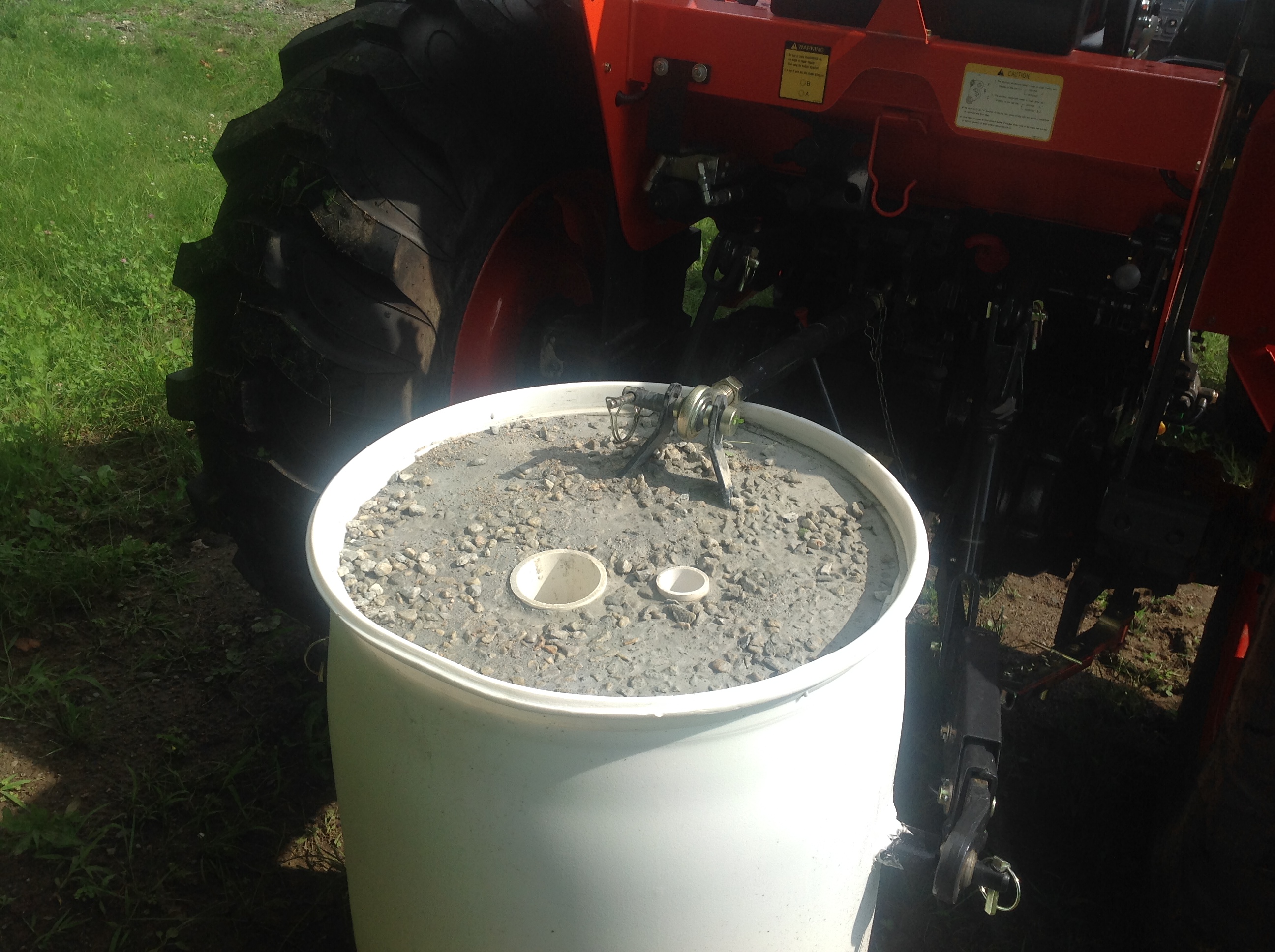

Built a ballast barrel yet?

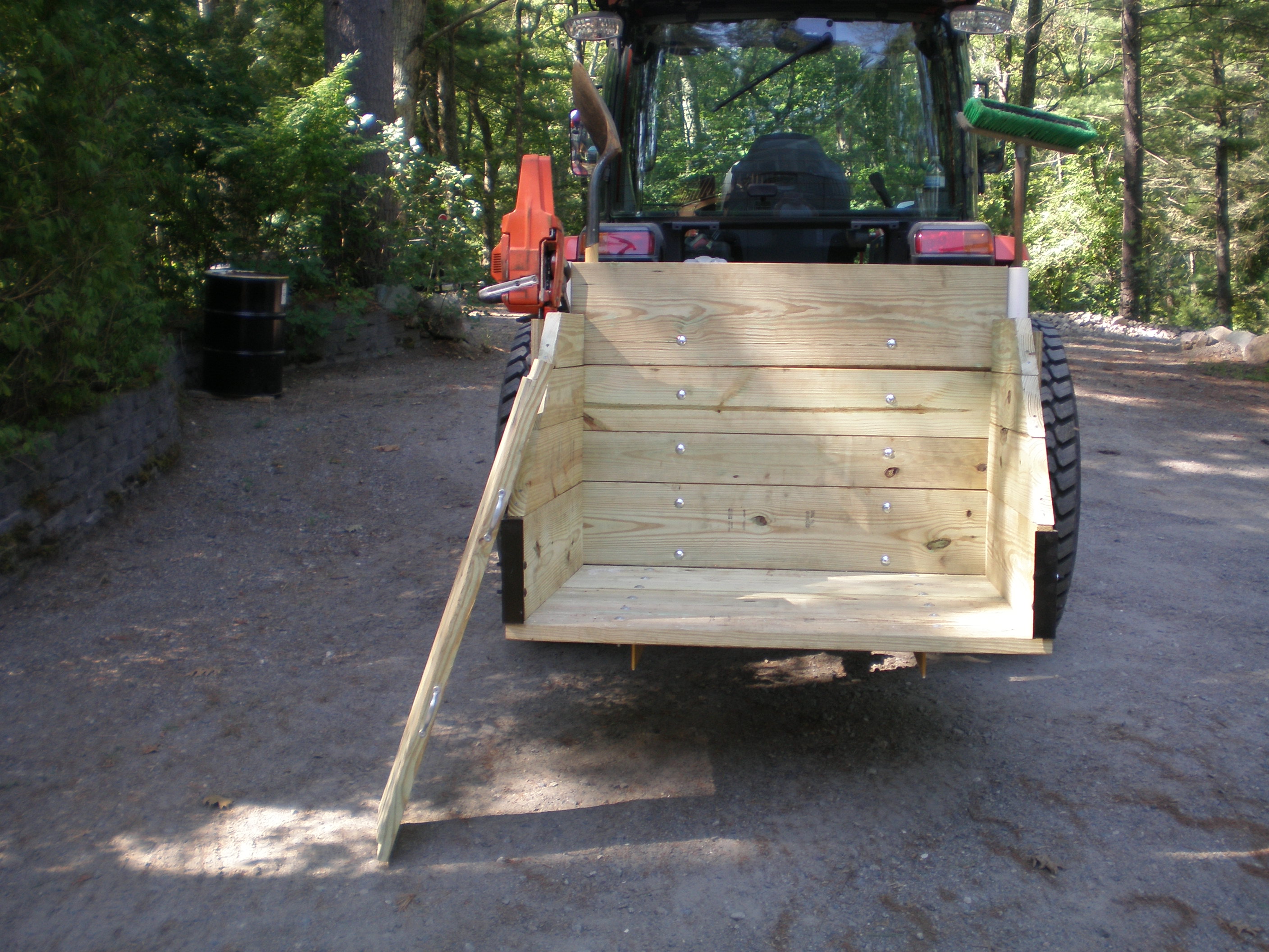

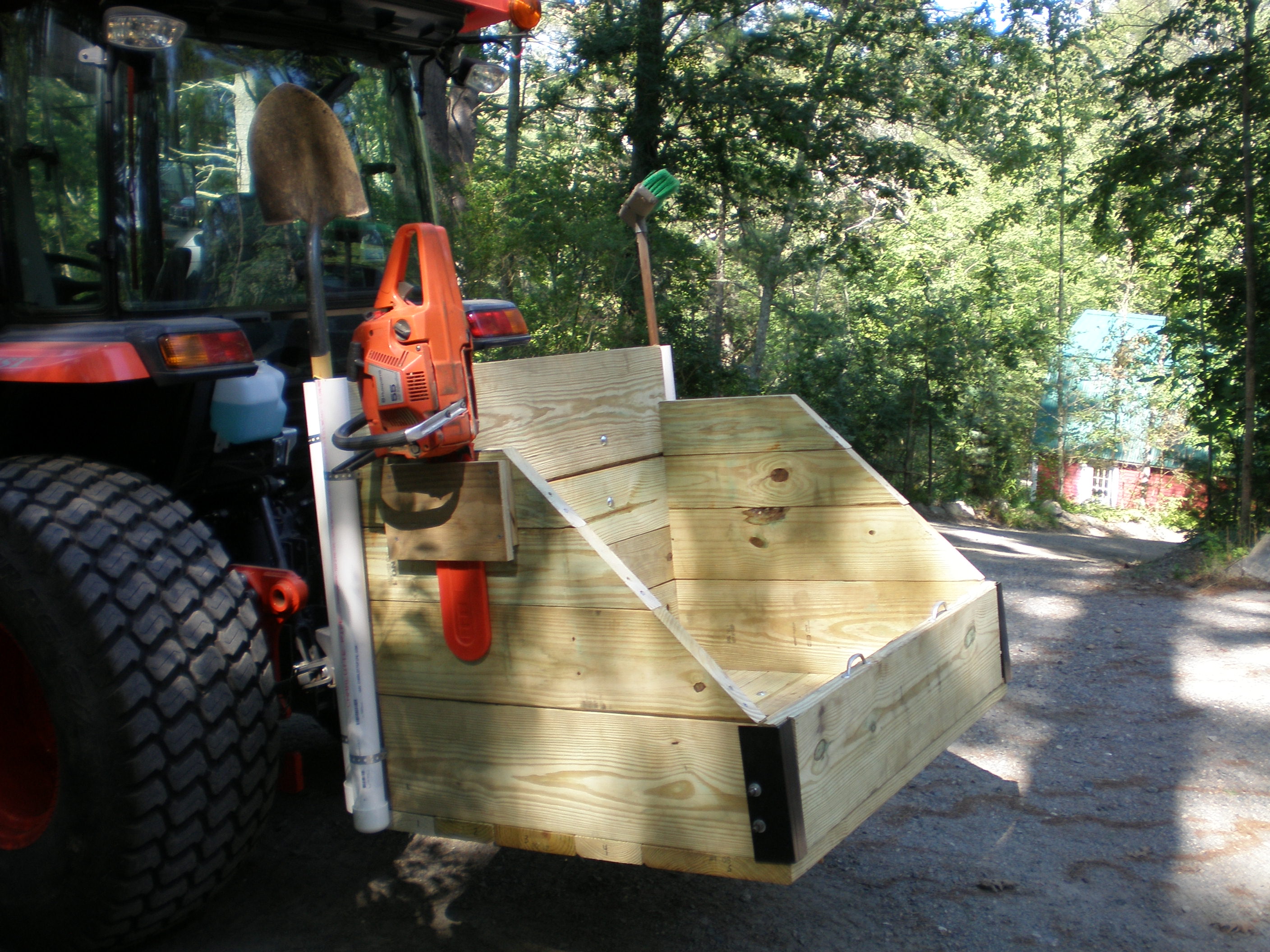

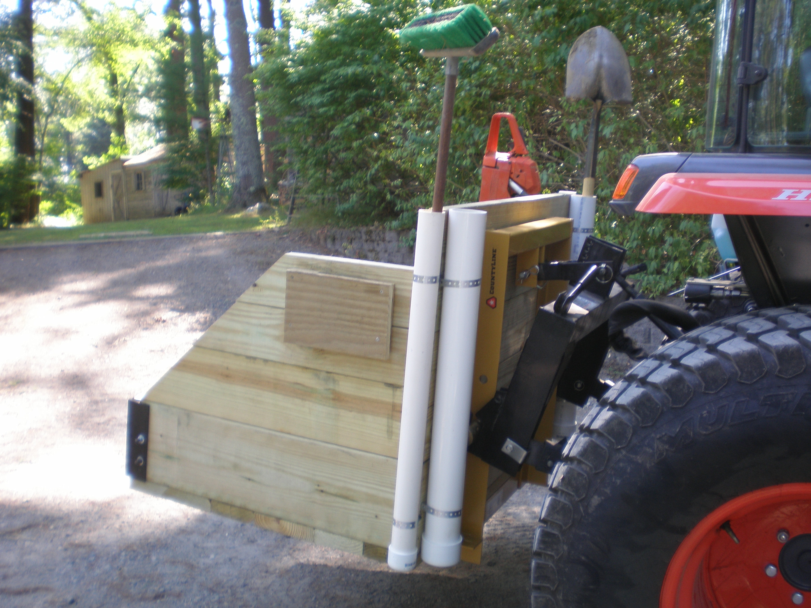

Build yourself a carry-all. I got so many good tips from this site and incorporated some of my own. Look up "carry-all build" and get some great tips.P8270001.JPGP8270002.JPGP8270003.JPG

Is that cement? How did you mount the 3ph attachment points in the barrel
Yes, about 12 80lb bags. I mounted a drawbar and 3ph stabilizers from TSC in holes I drilled through the barrel.
I would do it different though buy a complete 3pthitch adapter from northern tool and use some rebar to keep it positioned in the barrel where you want it; add a chainsaw plastic scabbard; add another 3" tube for long handle tools/chains.
If you haven't added ballast to your tractor you are missing on of the best safety items that just so happens to make it so much more capable and stable.
