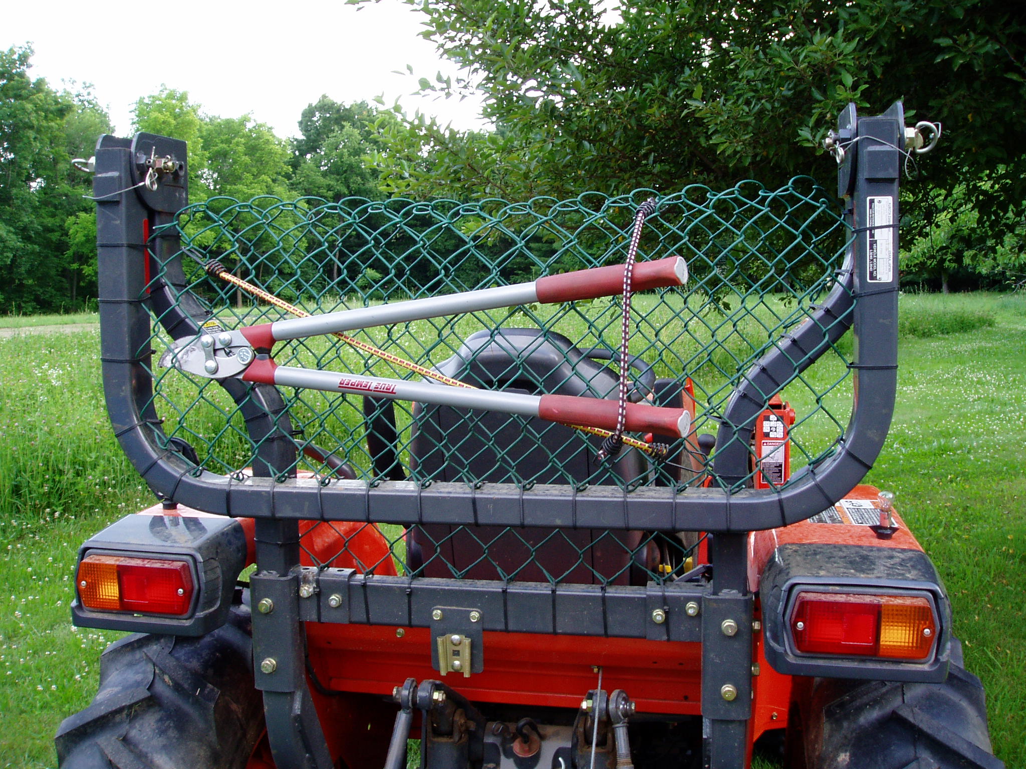

I want some sort of holster for carrying a large loping shear on my ROPs. Also, possibly an axe or possibly a ditch axe while I am mowing fence lines. I have a lot of trees with overhanging limbs that I would like to prune while I am there and thinking about it. I have not seen anything commercially available, but I hope some creative soul may already fabricated something that I could copy.

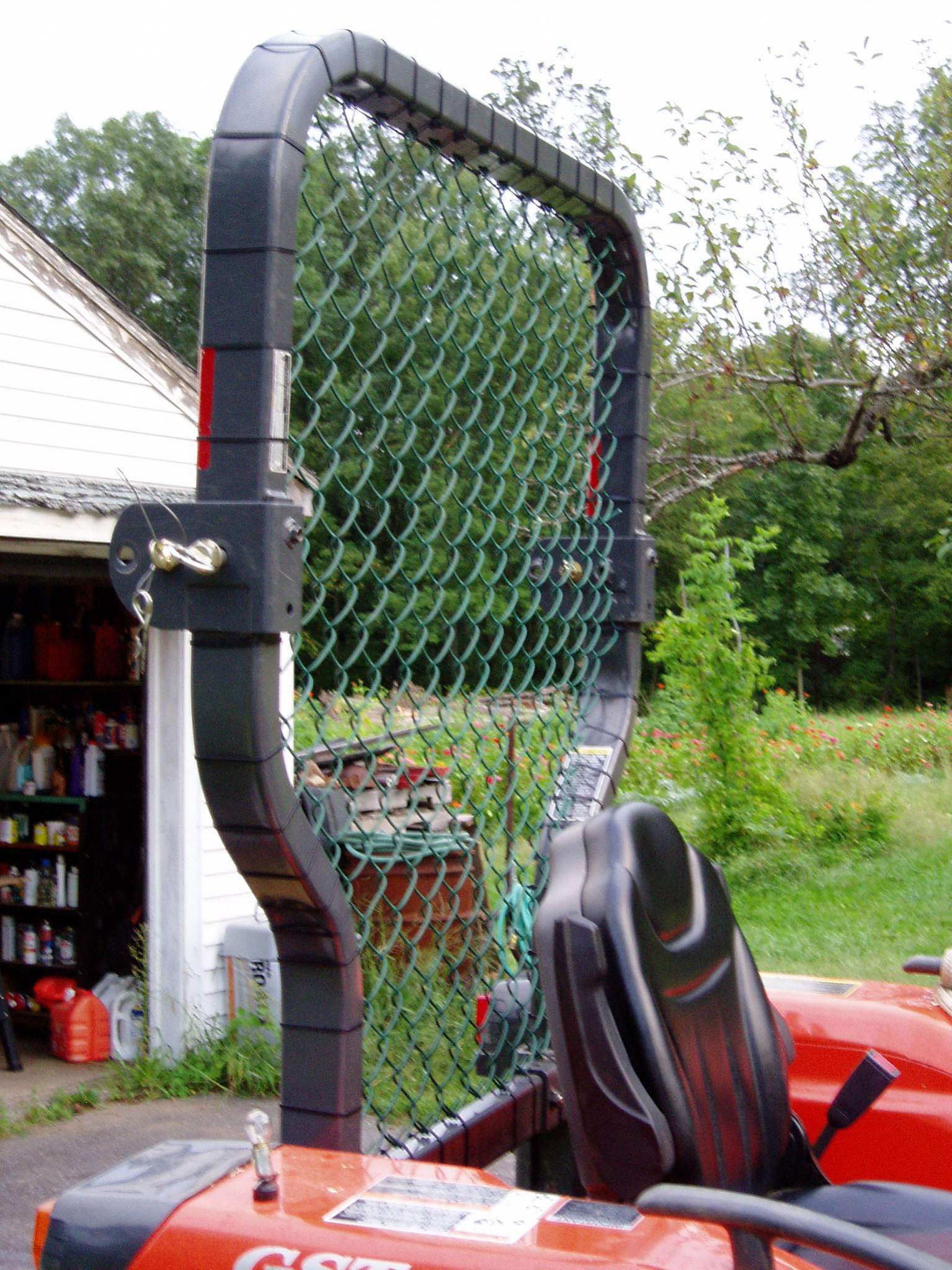

   / tool holster for ROPs #4
This is my solution:
It's cheap and also provide some protection from things coming at me from the aft side.
Yep, that's the reason for my post. Thanks again.
