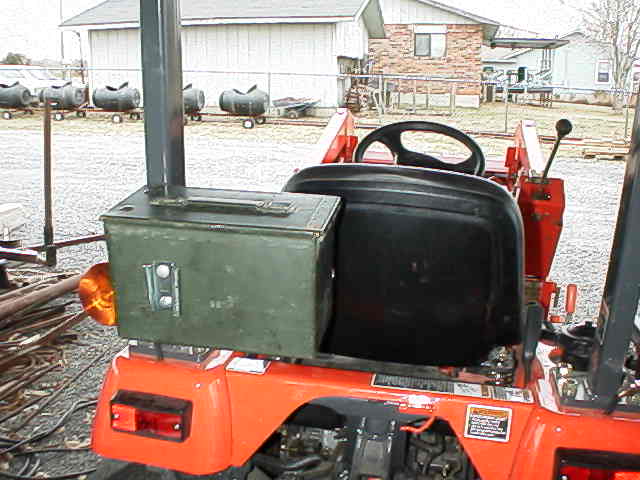

Here is how I mounted a 50 cal ammo box on my BX2200.
I removed the SMV bracket from the ROP and mounted the ammo box on the SMV mount, then mounted the SMV bracket on the ammo box,
Then I mounted a strap using an existing hole under the plate the seat spring sets on and the other end to the back of the box.
The50 cal box holds a lot of necessary stuff.
and I didn't have to drill any holes in my baby.

Good Job!

JimC,
The main thing that I would have done different would have been to paint the box orange before mounting it. :)
I always like to see people be inventive.

Jim... those are good toolboxes... I had one on my L245DT...I now have a new L3010 HST and I need to mount one to it.. The toolbox behind the seat is not very deep. Welcome to the Forum....there are lots of good people with some great ideals for improving your machine.

Good Idea. Those boxes are great for tools. I have a few, but have yet to find the place that I want to put it. I can't put one where you did because of other implements and the backhoe.

I painted it to match the ROP, but have not taken a picture yet.
Considered orange, but figured I could always paint over the black.
