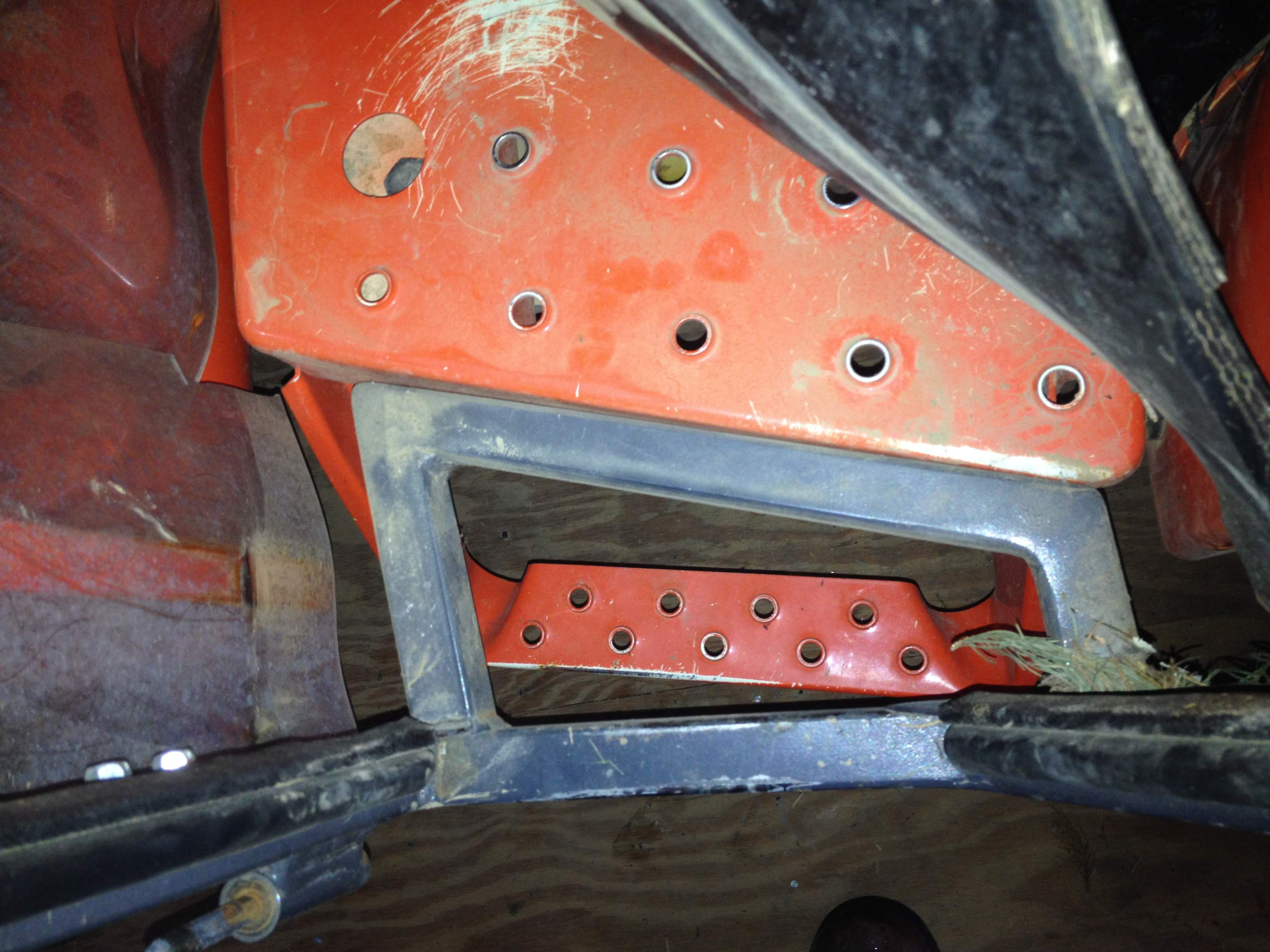

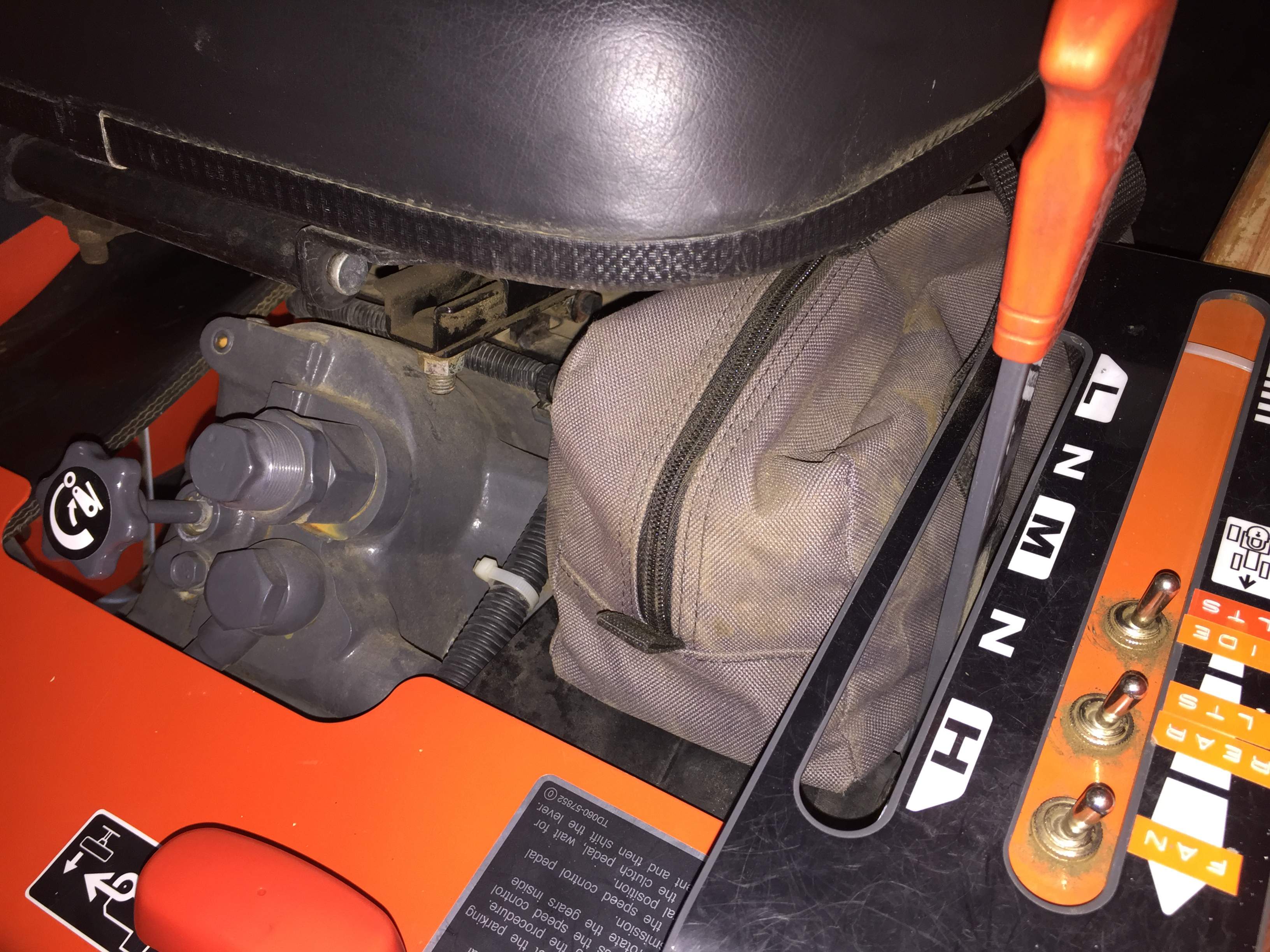

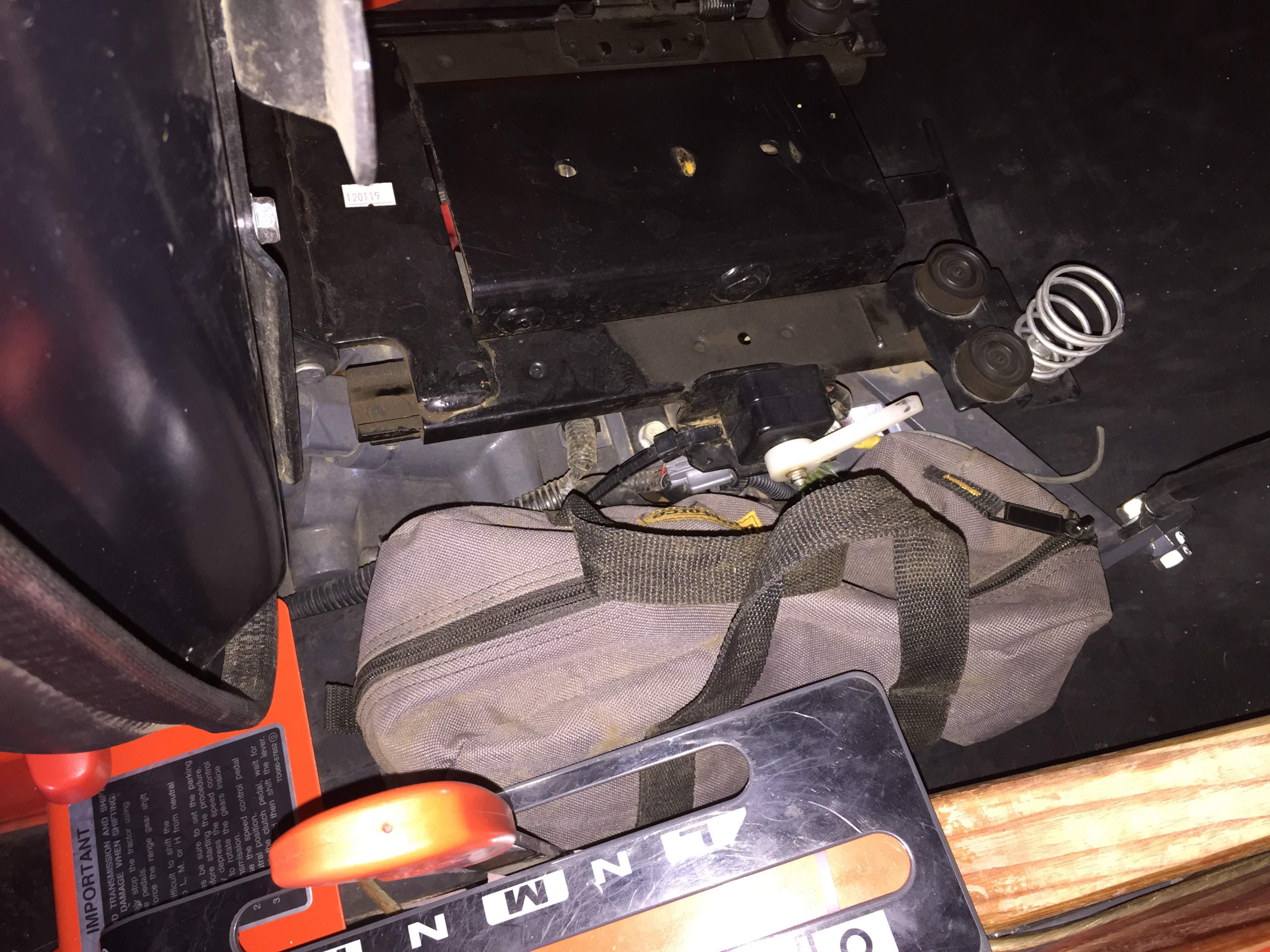

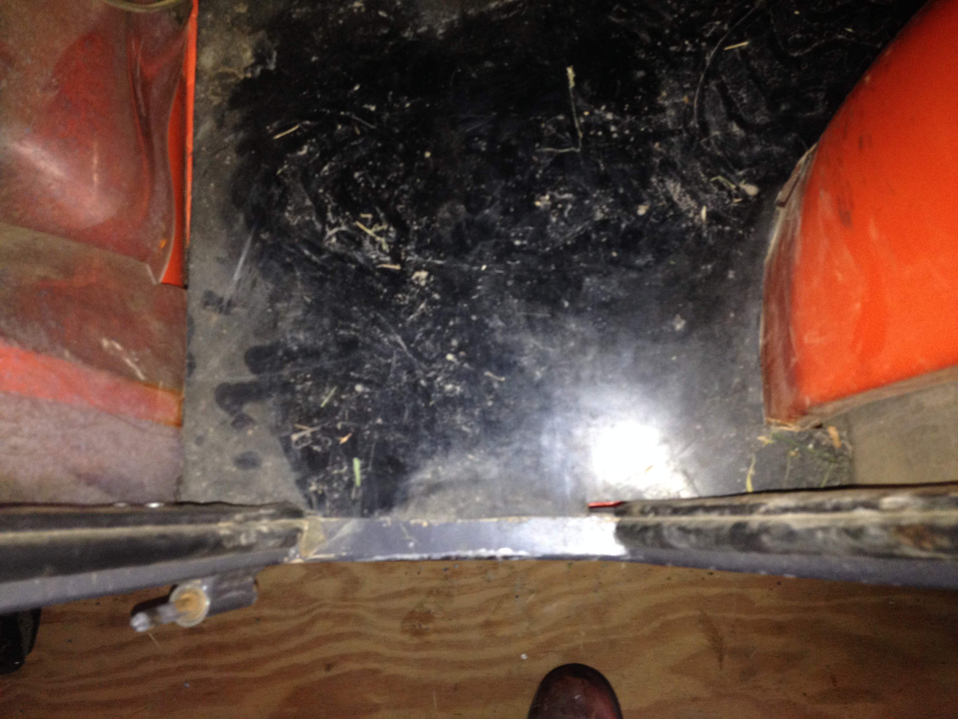

Took a slightly different approach. Having trouble finding an acceptable place to mount a box outside of the cab, I used a heavy duty nylon tool bag. It stuffs nicely under the left side of the seat.
A little off topic - When I built the cab I cut a big piece of cow mat to form a "floor" that runs from the sheet metal under the front of the seat to the back wall of the cab.
The sides of the cab run as wide as the outside of the fenders and it gives a comfortable amount of extra floor space for my 13W boots. Same cow mat material fills in the real floor area to block off the holes & openings. One picture shows the rubber lifted so you can see the trapezoid-shaped additional floor.

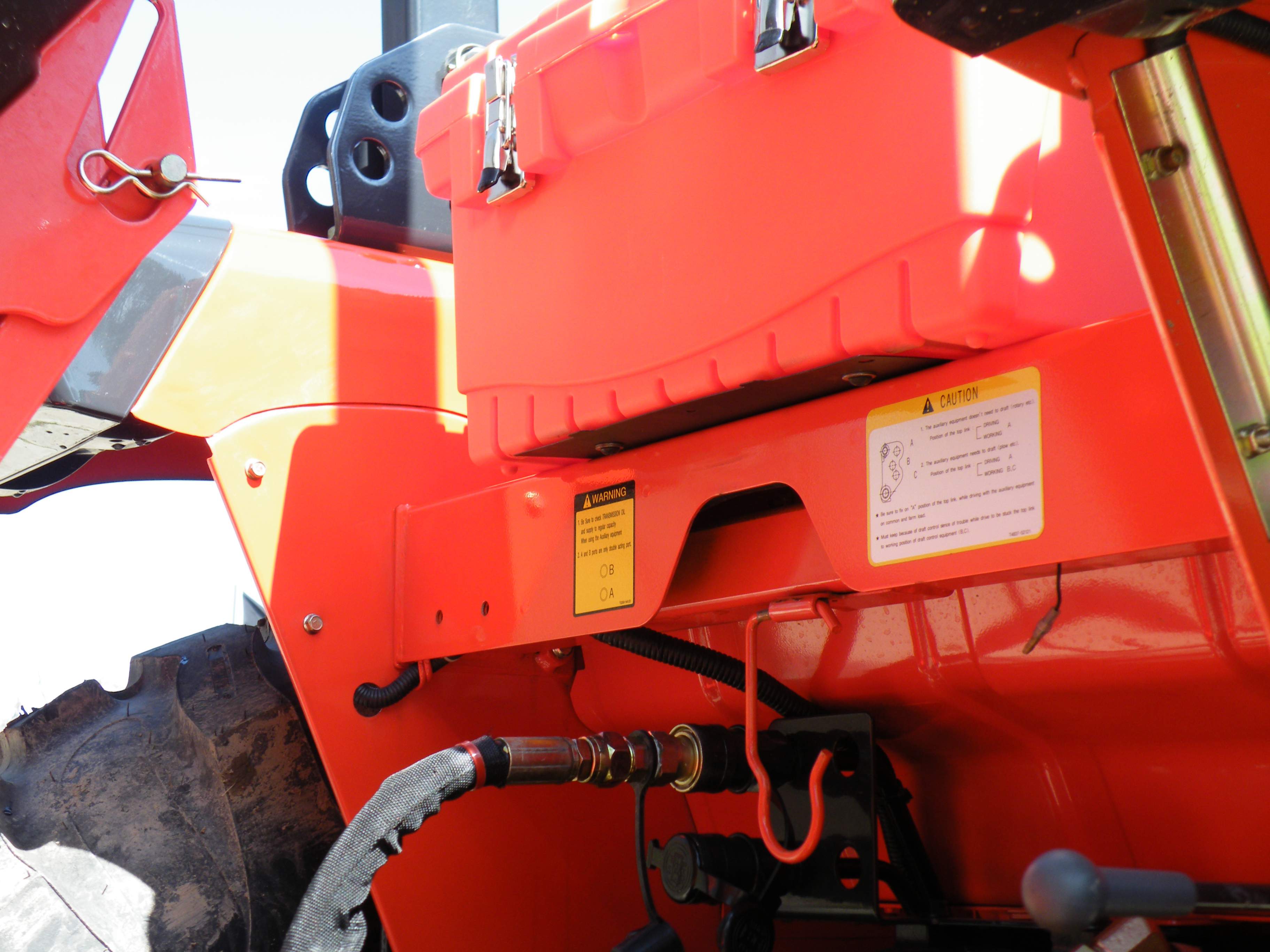

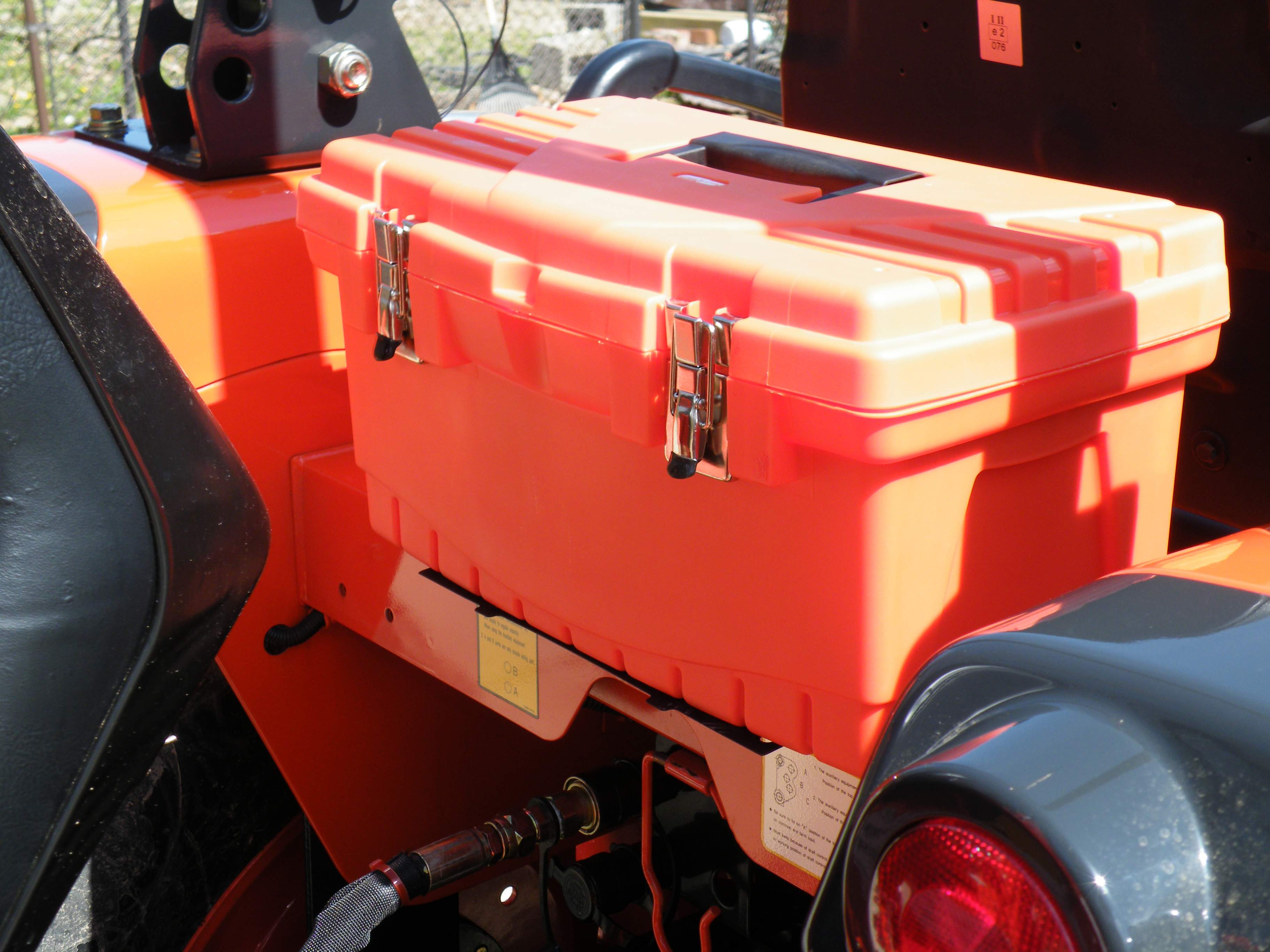

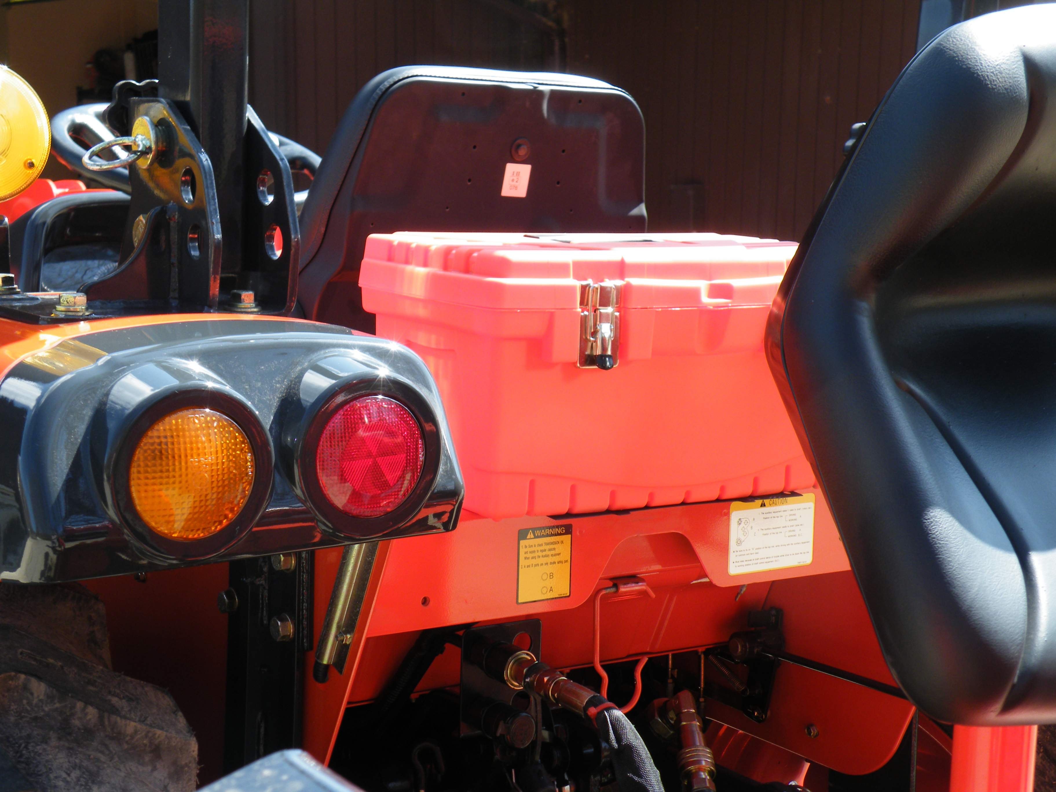

I mounted the box on the rear of my new tractor , works out real nice. If I want to , I can open the rear window and get to the box without getting out of the cab if need be. But mostly just access it from outside.
