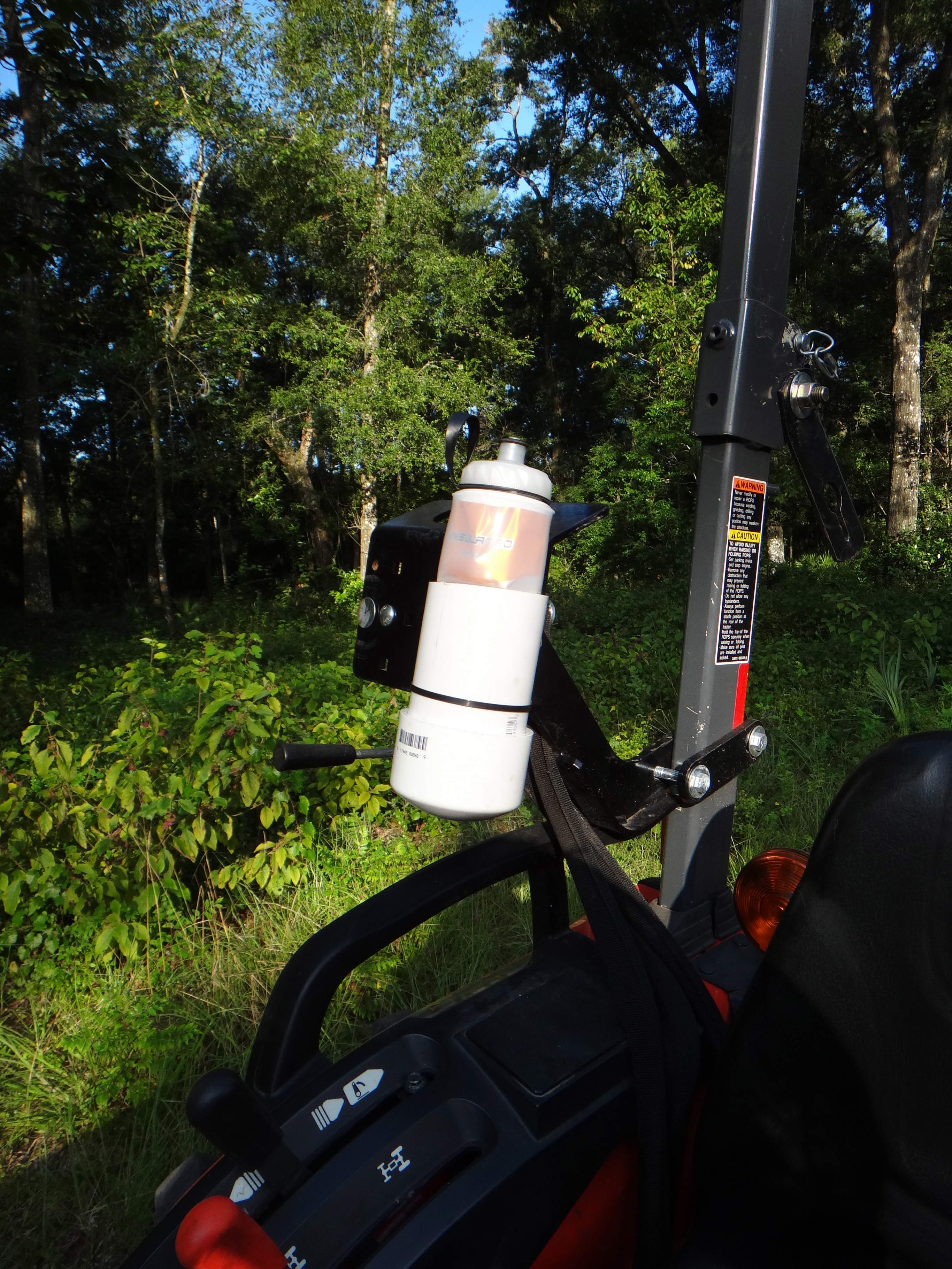

I have a LS G3033 has anyone added a tool box or cup holder. Let me know what's been done.

DRINK HOLDER
I first used lightweight bicycle water bottle cages, but vibration of tractor and brush eventually did them in.
Now I use 3", Schedule-40 PVC + cap, attached to tractor with one carriage bolt and one cable tie. This is an industrial strength installation.
3" cap is not cemented to pipe, so I can remove cap occasionally to clean.
You can get massive cable ties on eBay, if carriage bolt mounting will not work in your situation.
For containers I use 24-ounce Polar (brand) insulated, plastic bicyclist's water bottles. I freeze 1" of water in the bottom, then fill with Gator Ade. Still cool liquid as I finish.
http://www.amazon.com/-24-Ounce/dp/...1377644434&sr=8-1&keywords=Polar+Water+Bottle

A few holes in the bottom of the PVC cap to let dirt and water out?

DRINK HOLDER
Picture update:

that looks like it will hold up well.
