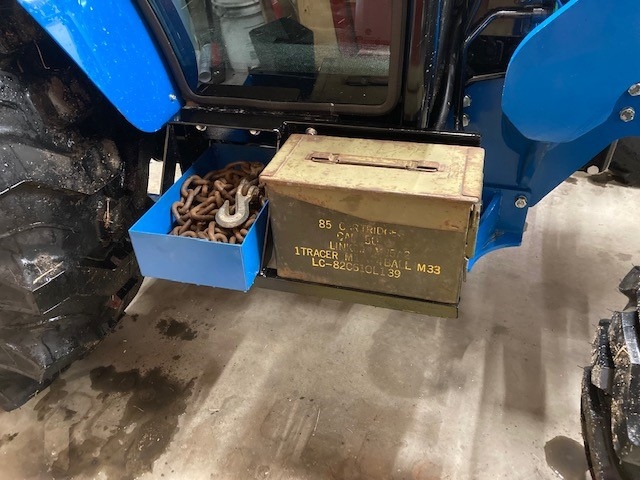

I took the RH step off and built a bracket that holds a chain box (expanded metal bottom) and 50 cal ammo can. I used some angle and flat steel that I had laying around. It mounts with the factory step hardware.

Just a thought, I took some threaded rod (2x) and attached a 50 Cal box to the outside arm of my loader. Its never in my way and right outside my door (left side) when i get in or out of the cab. Obviously useless if i have my loader is off but for me that is almost never and very cheap (maybe $5) to install. Hope it helps.
