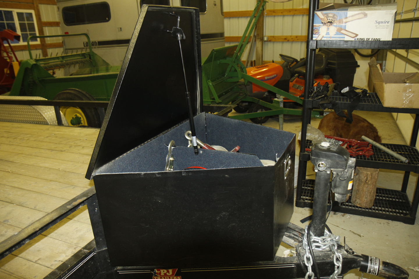

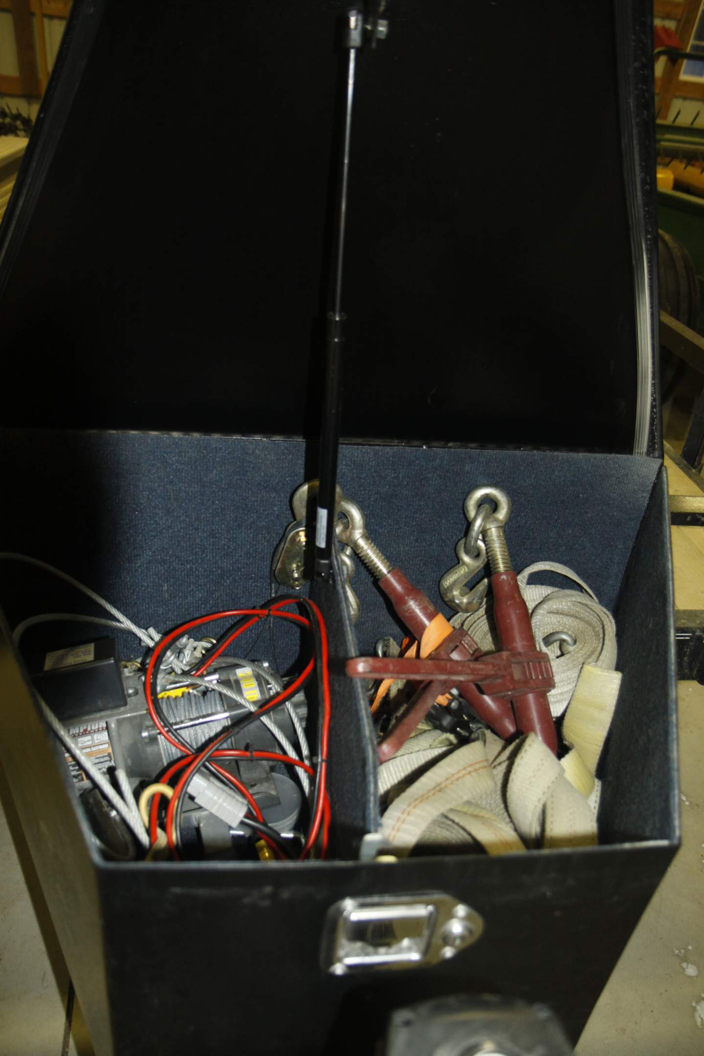

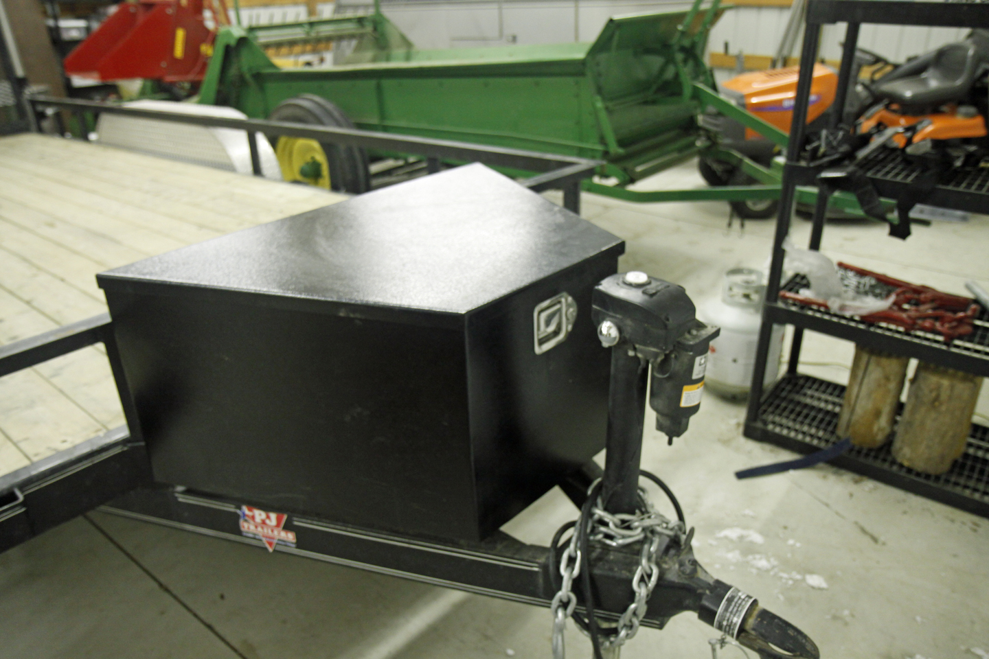

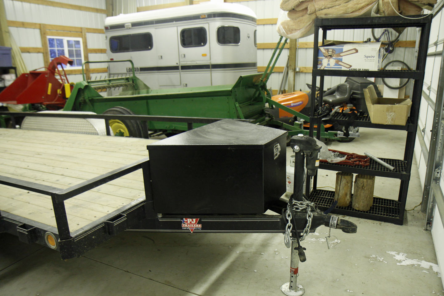

i made my own tonge mounted box, as the ones i found were either plastic or cheeply made metal boxes. i shopped all over and finally gave up. i also agree, lose the front cross piece. it really doesnt make any sence. you wont secure a load to a side rail anyways. add side tie downs. since making mine, i have found a few dscent ones at a local farm supply (where were thaey when i needed them). but i enjoyed making mine anyways. i added an electric tongue jack to the trailer so i could make a larger box. i store a winch, tie downs and binders, chains, etc in there.

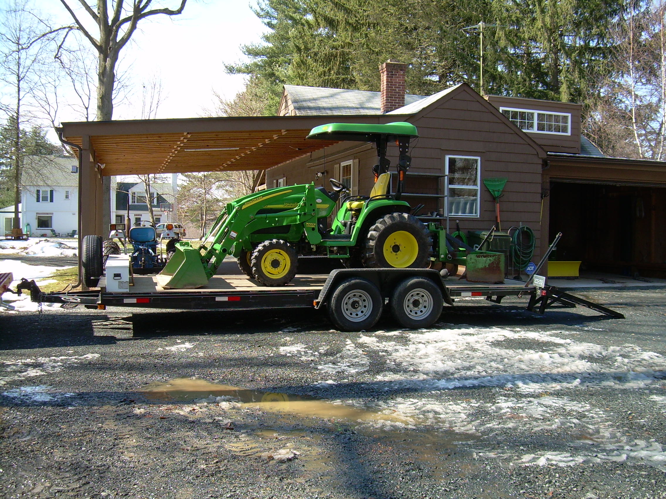

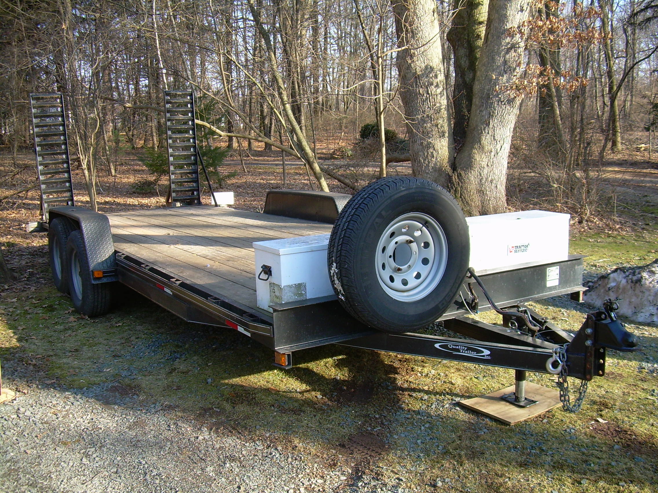

These boxes were on my trailer when I bought it, so I left them, since the trailer is 20 ft I can spare the space they take. Probably would not want boxes on the deck, if it was only 16ft.

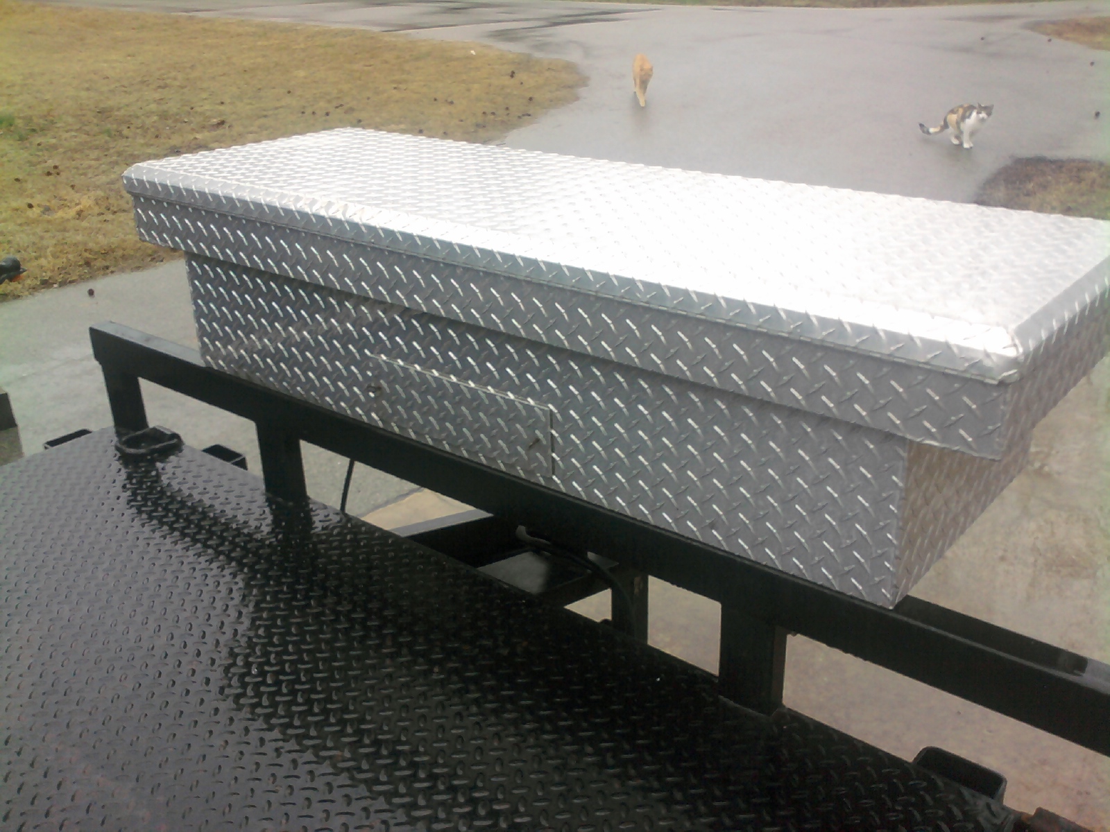

I got a tool box out of a 03 ford Ranger, that I had bought for a re-builder. It worked out great, I had a winch Plate added when I ordered the trailer, basically a 6" wide piece of C channel the was welded flush with the top rail that ran forward about 12" or so then had a brace that ran down to the center support of the tongue. I then added another 6" wide piece of C channel to the front end of the winch plate and ran it side to side about 4 foot, this made a nice flat platform to set the tool box on. I have a winch and battery mounted inside the tool box that also charges off the tow vehicle when hooked up. I then cut a opening in the rear of the box for the cable then took a scrap piece of tread plate I had and cut a piece about an inch larger on all sides of the opening and added thin weather stripping to the cover and used to thumb screws to hold it on when not in use to keep the box weather tight. I have really been pleased with the setup I keep all my chains, straps, boomers, crank handle for the spare tire carrier, and what not in it.
