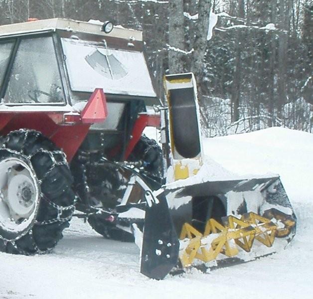

I think a lot depends on the tractor's price, condition and availability of parts. The tractor in question only tested seven hp more on the pto, and one hp less on the drawbar than my 6000 lb, 47 hp Agri-Power 5000 (aka Zetor 5011) as per tractordata.com. I use mine primarily for my pastured poultry operation, but in the winter I seem to pull people out of ditches. It also works my seven foot snowblower just fine. Too big? No, around here they just call it a utility tractor. The tractors on the hayfields are generally around 100 hp on up.
