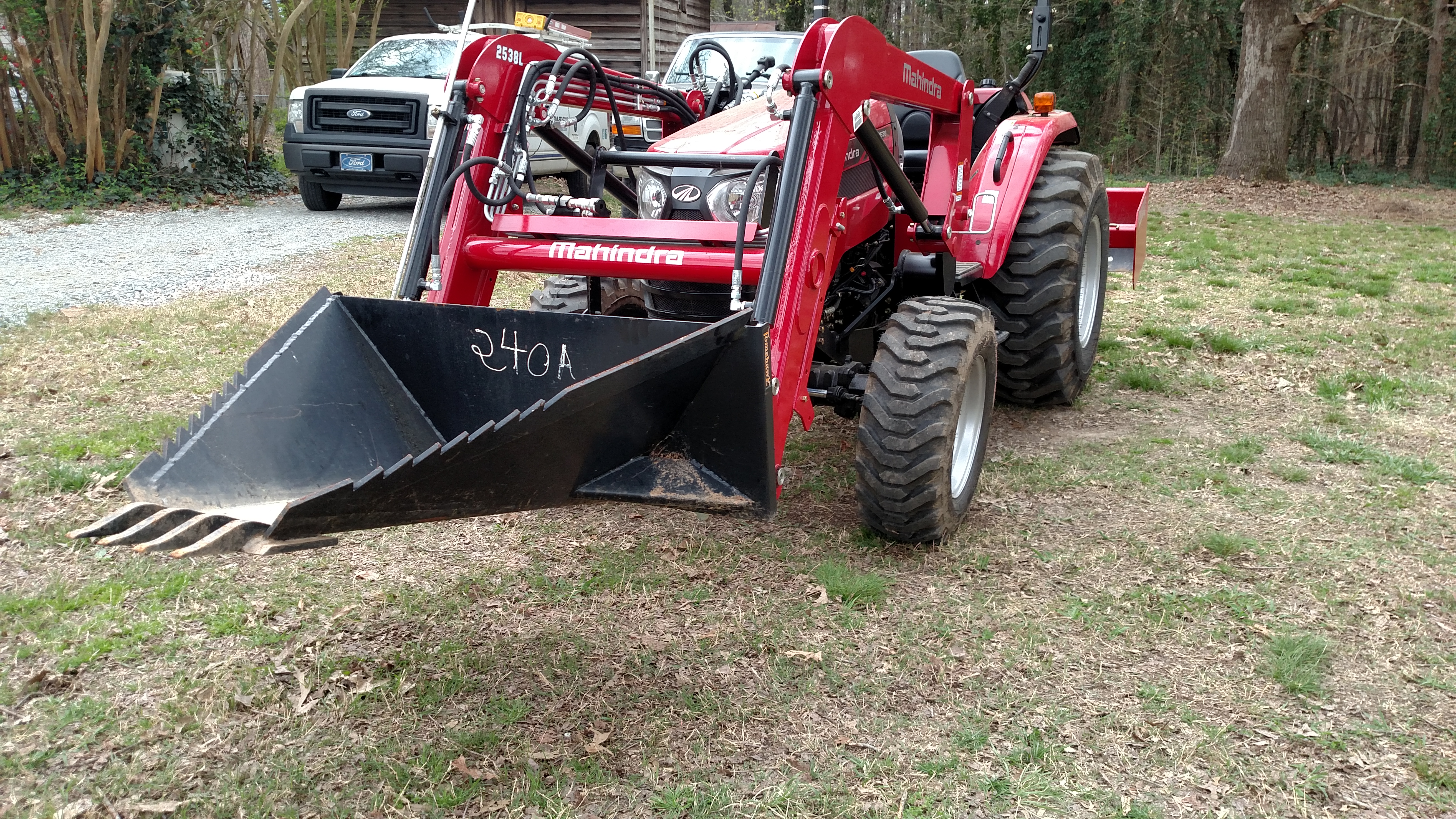

Then in an unusual turn of events I was taking an different route home from work one day and BAM, there it was sitting is a guys front yard. A brand new Tomahawk brand stump bucket for sale along with a few other attachments. I stopped in and it turns out that he had bought three of them at an auction a while back, he uses two of them on his skid steers and he is selling he third. Kind of randomly I ended up fixing an electrical problem he was having on a hydraulic power pack he had been working on for a few days, so he gave me the bucket for what he paid for it at auction, $275. Score! Talk about being in the right place at the right time.

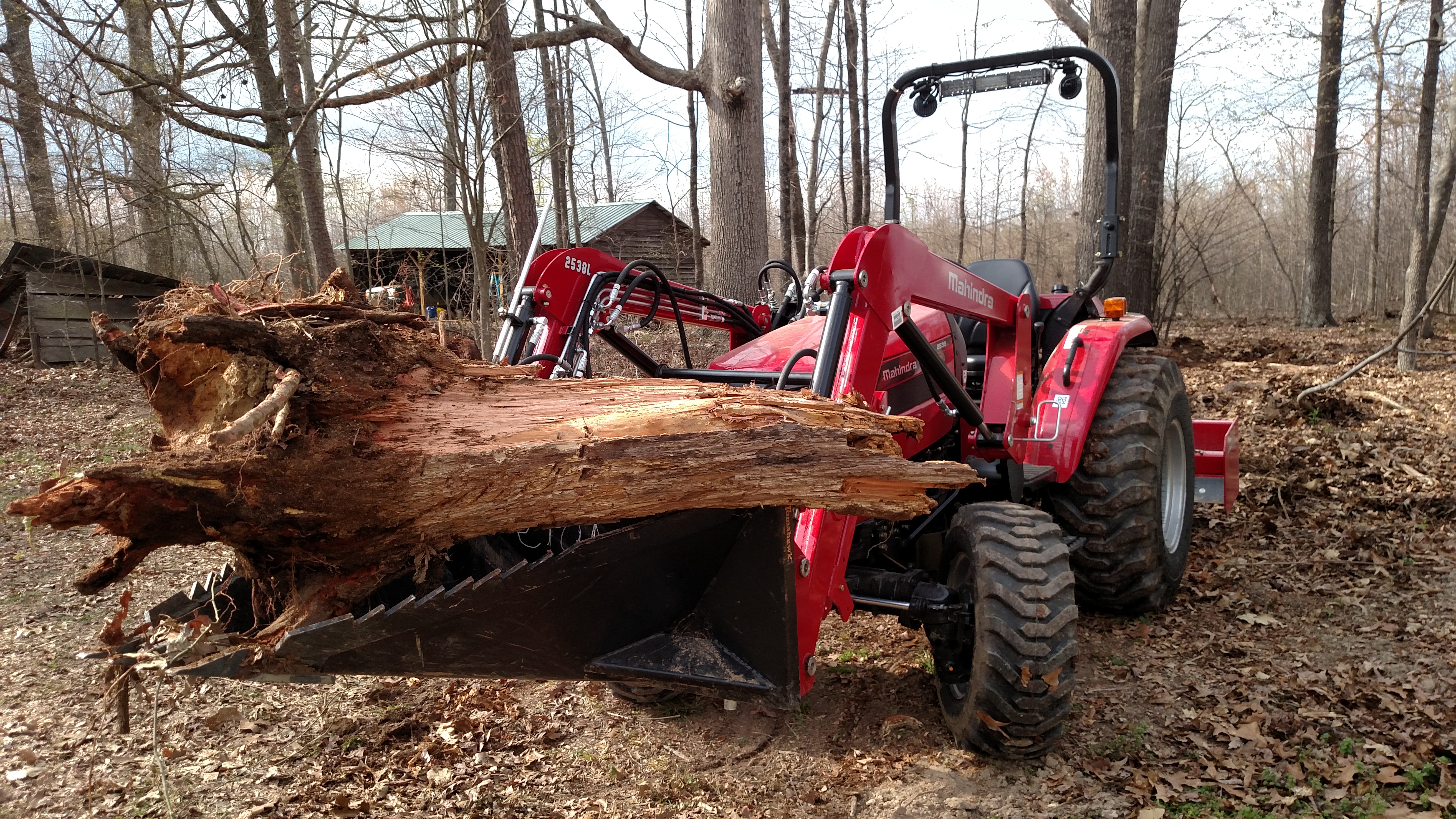

So of course I took it straight home and put it right to work. I had been uprooting trees with a chain choker the day before, and of course when you're doing that you inevitably run into a few that you just can't pull. Well, the Tomahawk stump bucket made short work of all of them. So I moved on to something much larger, see the big cedar stump in the picture below. That took about ten minutes to dig out, but it did it with minimal trouble. Then I popped out a couple dozen more saplings; MUCH faster than using the chain choker. Then I went and dug out 8 concrete footers that used to be under a mobile home years ago, but lately are only good for tearing up my mower blades. To make a long story short, this thing made short work of every single thing I put in front of it. I've gotta say that I am impressed. It only weighs 175 pounds, which as stump buckets go is pretty light. It has the same general design as the Titan extreme stump bucket, but is a lot lighter because it isn't made out of 1/2" plate. Frankly I would be shocked if a compact tractor could tear this thing up. This may be my new favorite bucket! I will say that this bucket has welded teeth on the front, whereas the more expensive ones have pinned teeth that can more easily be replaced. Eh, shouldn't be a problem for a long while.

If you are trying to dig out a stump or a rock then the grapple would not be in the way at all. If you are trying to dig out a tall stump, or maybe a whole tree, then the grapple could stick out an hit the trunk of the tree. I think. But hey, for what I paid for it I have zero complaints. And if I ever get the grapple itch later it is easy enough to weld on one of those add on thumbs, but I doubt it will come to that.

I have that stump bucket and it really is well built. I have a tc45da that I use it on. The only problem with a stump bucket and a tractor is that the loader arms are so far out front it's hard to get enough penetration/weight without lifting the front tires off the ground thus loosing traction. Works much better on a skid steer. It is nice to push the trees over way up high. I let the tines dig in and drive right up the tree. Then just back up and dig the root ball out. About 6 inches in size is max for the tractor. Maybe 10 with the skid steer. It does a great job of digging trenches or loosening up really hard soil.
