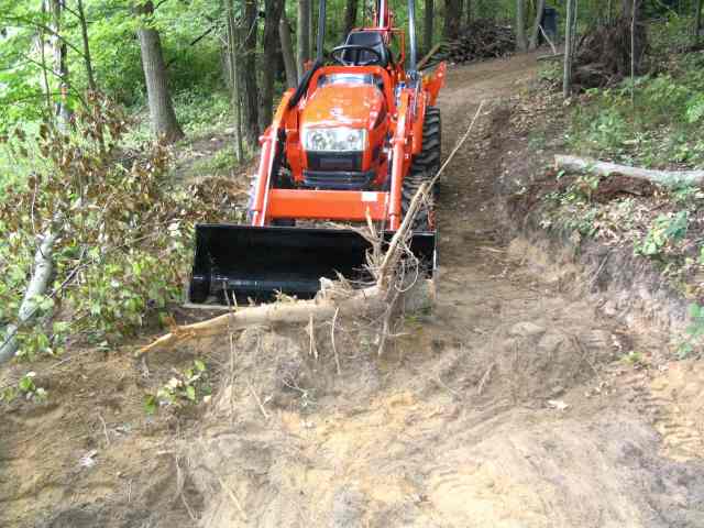

Hey Guys,
Just a little update on my CK20 TLB...I think a may have a small problem. The KB2365 Backhoe may be too powerful! :eek: Now I know that it violates every man rule in existence to admit that a tool may be too powerful but that bad boy BH tosses my little CK20 around like a rag doll! :D
I've been digging out stumps the last two days and when the bucket grabs a root it cannot break I can feel the front of the tractor lift off the ground. I also find it very easy to drag the tractor back-wards with the backhoe when I grab hold of a stubborn stump!
I'm now very seriously considering buying the optional feet for the stabilizer pads, even if they are $65 apiece. I thought it was odd the first time I looked at the stabilizer pads and saw how smooth they are...not sure why they are designed this way.
I agonized between a CK20 and a CK25 for a long time and finally my lovely wife convinced me that the Ck20 was "cuter" :eek: and would fit on our small parcel better than the "big" one. Our main concern was that we wanted to make some walking trails on our heavy wooded property and we wanted to cut as few trees as possible, so smaller tractor = more trees saved.
Man, I wish I would have "super-sized" and gone for the CK25 or CK30.
Don't get me wrong, too much power is usually not something to complain about! But I could definitely use a little more weight/ballast.

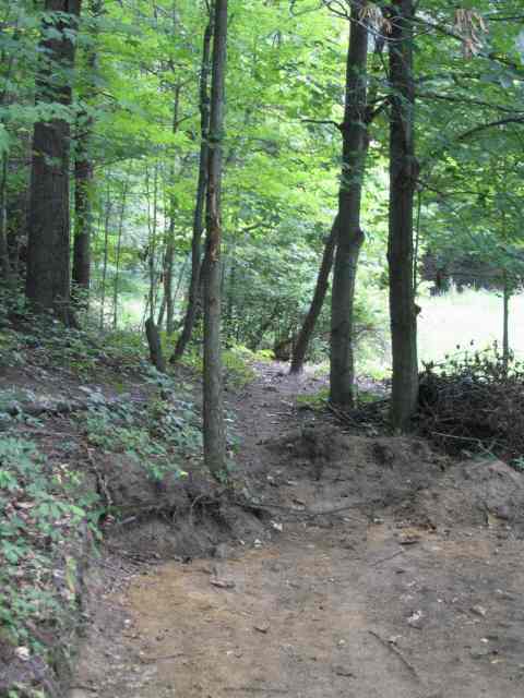

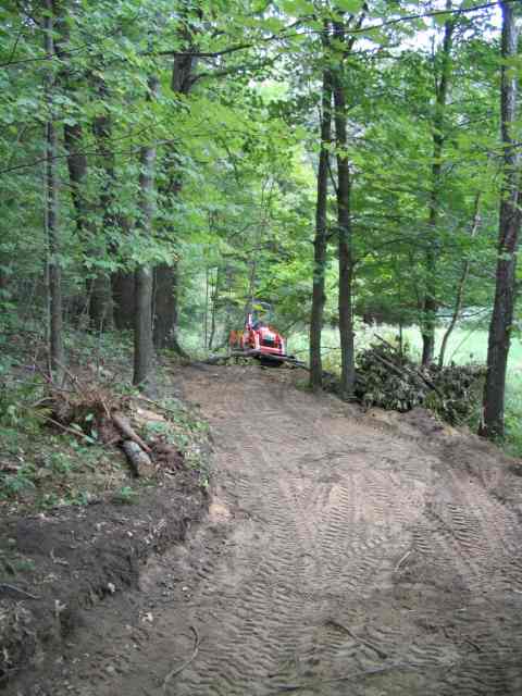

Yes, I've got pic's! Let me preface this by saying that these are not the most impressive stumps ever posted on TBN. It's still alot of fun though! I mean work, alot of work! ;)

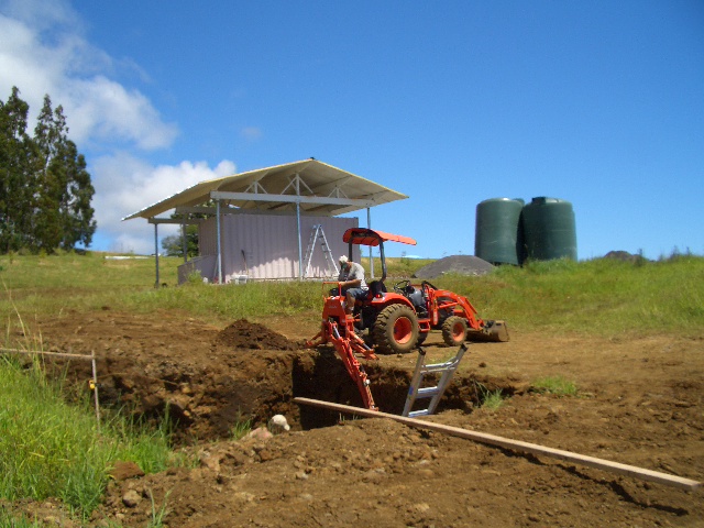

I recently dug a smallish hole, roughly 20'X20', 5-7 feet deep, with my CK30. I found reducing my rpm's gave me greater bh control without any loss of power. I think I settled around 1800 for most of the bh work.
