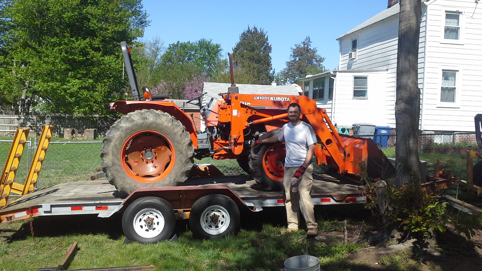

I'm wondering about how much weight my trailer (Hudson HSE Deluxe - 5 Ton Capacity Fender Equipment Trailer HSE Deluxe - 5 Ton Capacity Fender Equipment Trailer , 18' ) can carry in different states legally. My WD hitch is rated at 1,400 lbs.

Since I just drove from Virginia to Mississippi hauling what I figure as 7K of tractor and 2K of trailer with NO problem
and have room left over I'm figuring I could add a few more implements but want to keep it well within limits.
