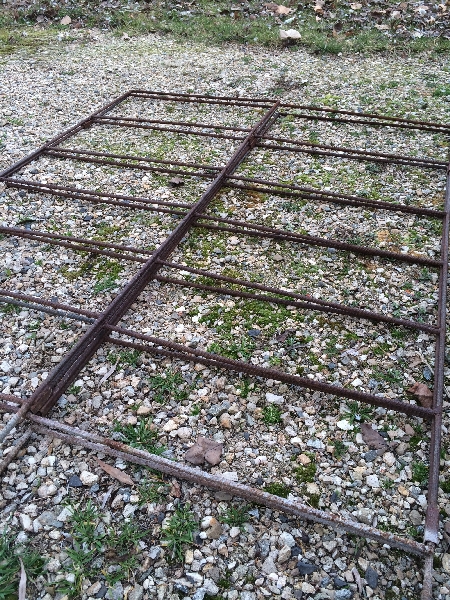

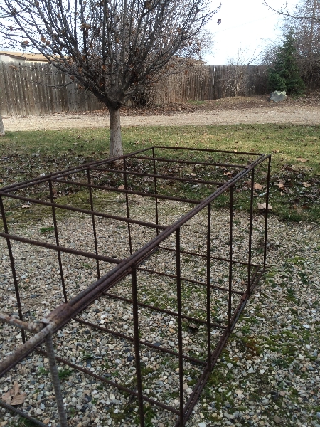

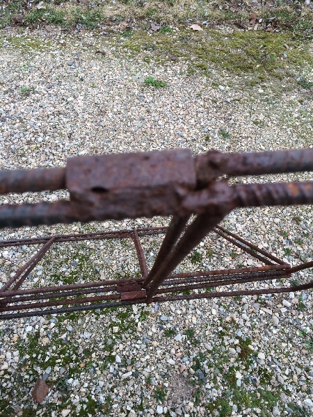

Rebar, each side is sort of like a ladder. I slipped some tubing over the vertical piece on two sides and welded it to the mating side vertical piece so it acts like a hinge. Not sure if that makes sense. In any case it hinge flat or you can pull the sides out to make a square. The vertical pieces extend beyond the bottom about a foot so you can press it into the ground....
Maybe I should take a picture.... ;)
/ Tomato Cages #6
Here are some pics. Flat for storage, opened for placing in the ground and what I used for the hinges. I had these little scrap pieces so I went with square tubing but round would as well.
I have two, the other one is taller for indeterminate type tomatoes. I used 3/8" rebar.
