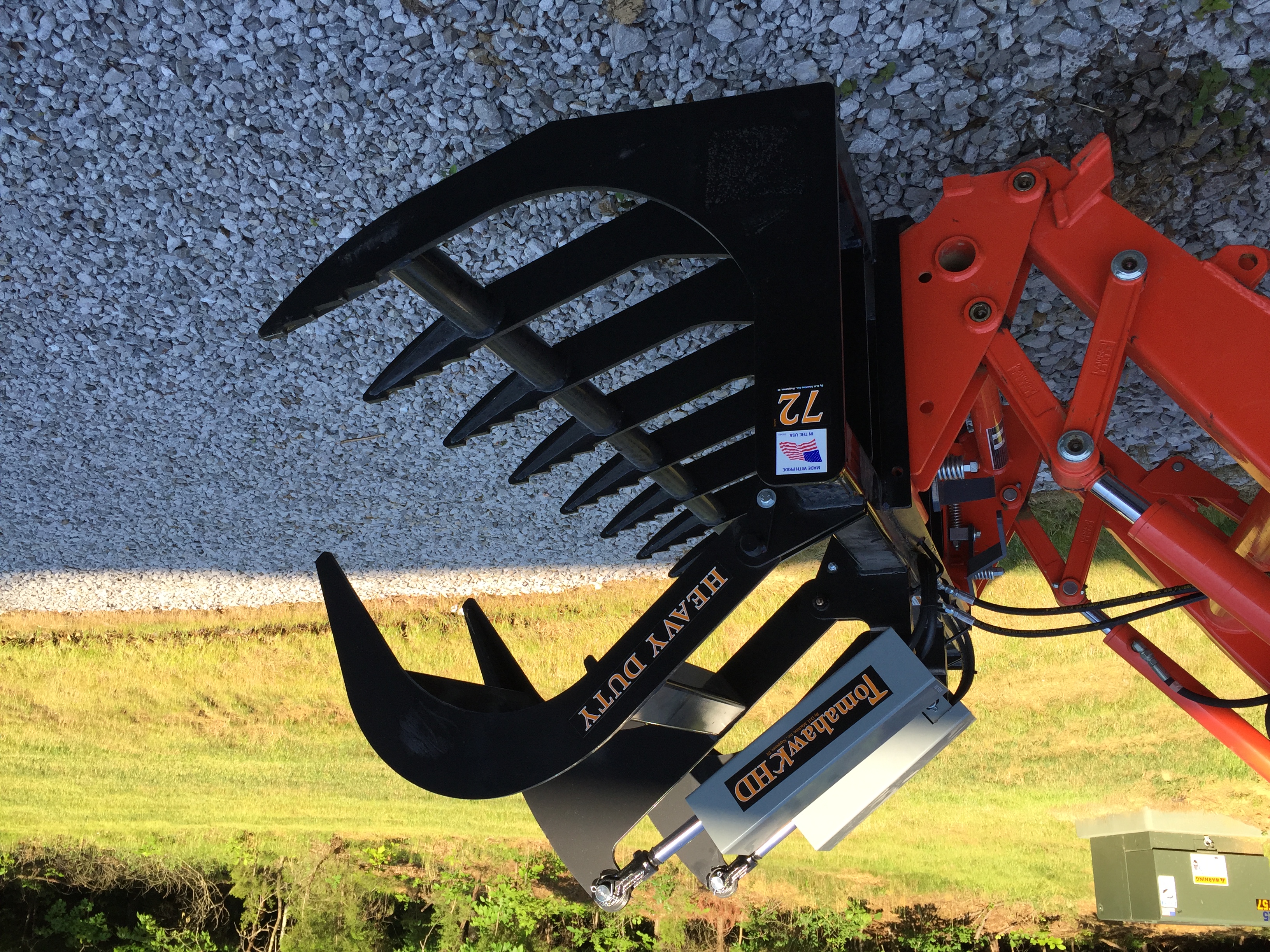

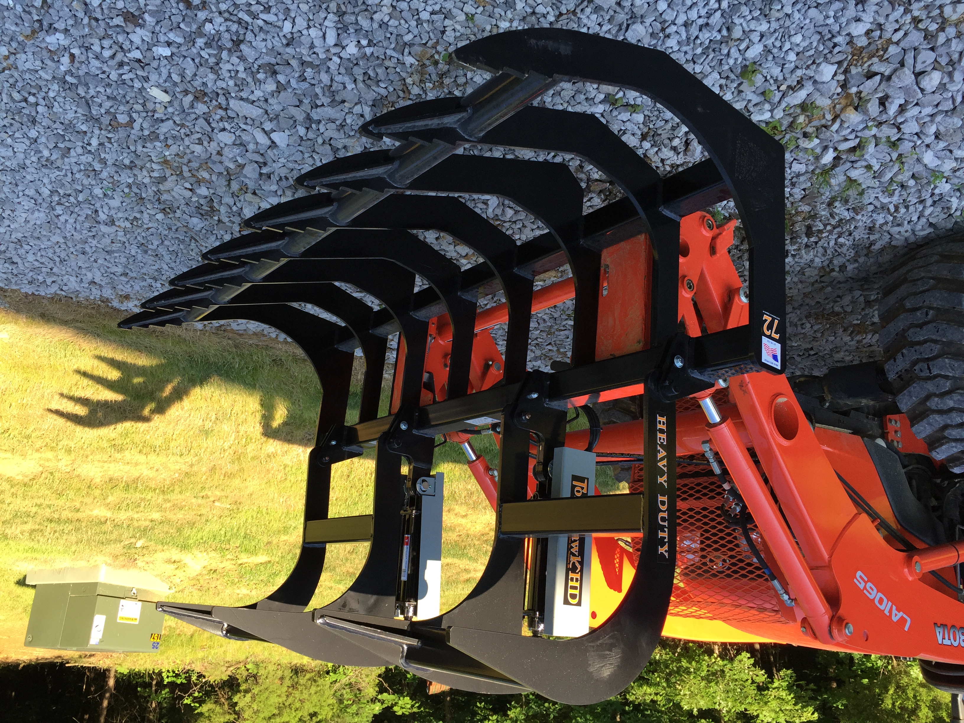

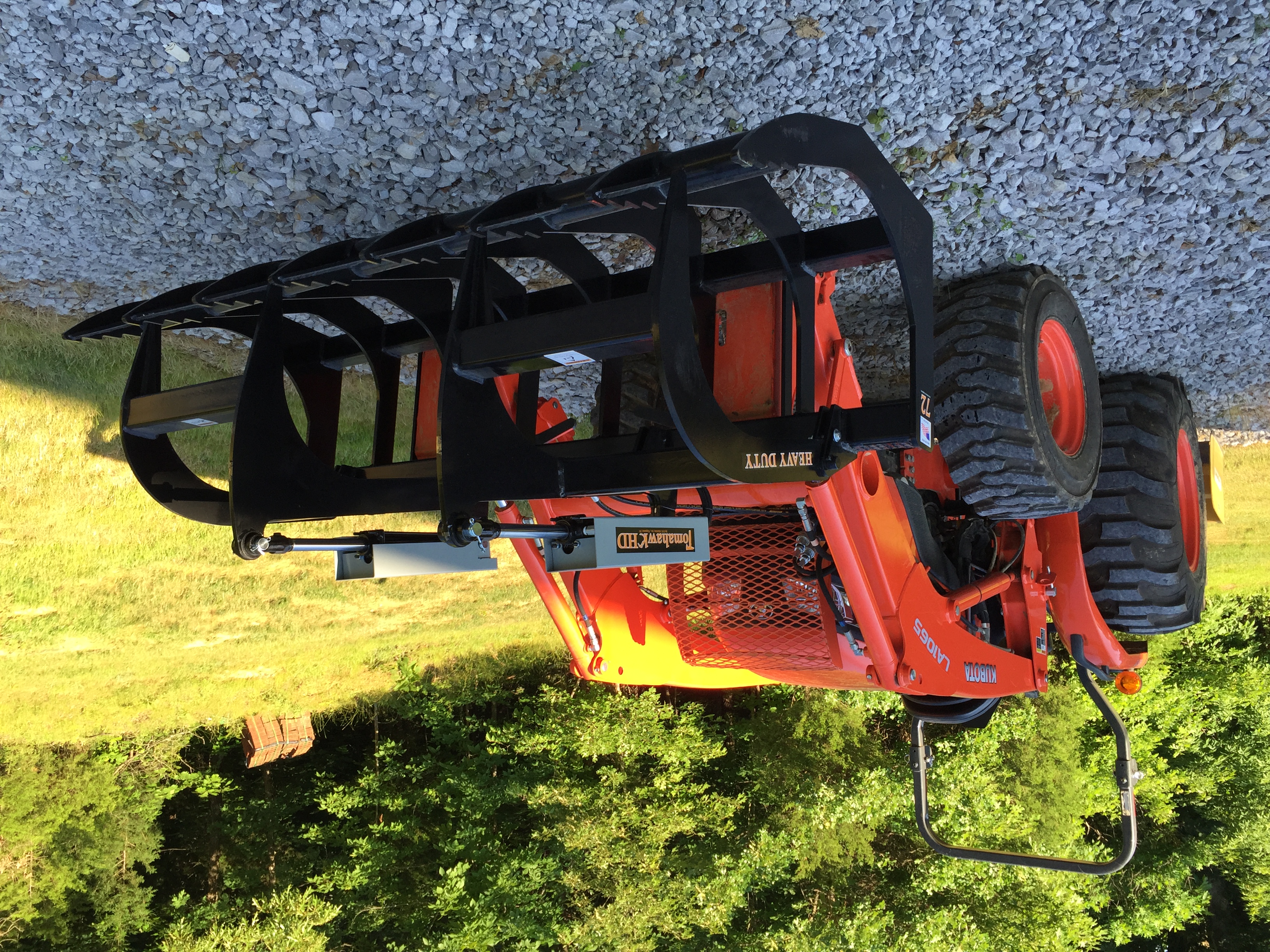

I recently purchased a Tomahawk 72" HD grapple to run on my Kubota MX5200. I've had the tractor for a year and knew before I purchased it that I wanted a grapple. However, I never could bring myself to let go of $2,000+. Recently I stumbled across Tomahawk attachments as I was researching pallet forks. Their prices are really good comparatively speaking. I've learned you typically get what you pay for and I'm leery of lower than expected prices. But the more I looked at the grapple and compared the weight and construction (1/2") to its peers I decided to give it a whirl.
A semi-local dealer quoted me $1750. I nearly pulled the trigger but just out of curiosity called the manufacturer to see how much it would be direct with shipping. Much to my surprise the guy offered it to me at the multi-unit price (5+) of only $1083 plus shipping. Delivered price to my house was $1263! Too good to be true, right? I was a little nervous but upon delivery found the unit to be well made.
I ran it for about 7 hours this weekend making a walking trail through the woods. I pushed, pulled and dug some good size stumps out of the ground and it performed flawlessly. It did everything I'd hoped for and more. Several times I raised one of the rear tires off the ground (fluid filled and box blade attached for ballast). Nothing on the grapple showed any signs of bending or damage. Sweet!
I looked long and hard at ETA Wicked grapples and almost ordered one. They look very well made and have super good reviews on here but it's hard for me to imagine any brand performing any better than the Tomahawk does. I'm very well satisfied with this purchase and will look to them again in the future. The guy I spoke to on the phone was down to earth and easy to deal with. A good transaction.
Here is a link to the unit I purchased (72" dual lid). They have single lid and smaller, lighter units as well.
Tomahawk Attachments :: Tomahawk 72" HD Two-Cylinder Brush Grapple
I think I've attached some pics but they look upside down in the preview. Sorry, kinda new to posting here although I've read nearly everything on here.
