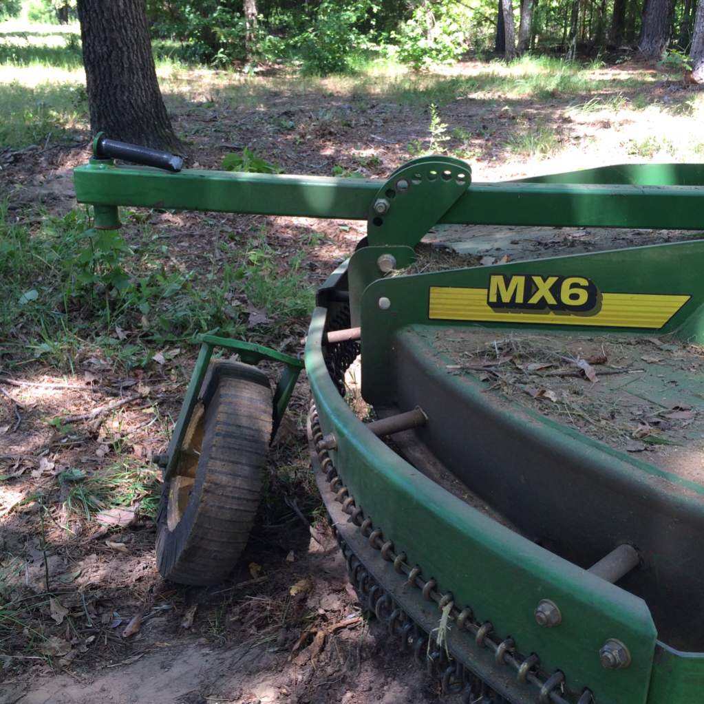

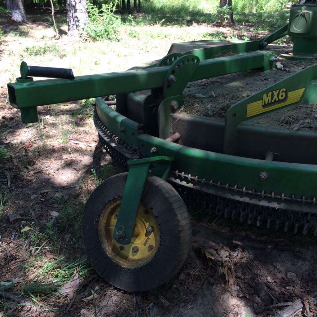

So yesterday I was doing a little bit of mowing and I backed my MX6 into a pine tree. DOH! What stinks is that I was in neutral with the power reverser just about to start going forward. I have actually done this a couple of times in the past, and nothing has ever broken.
Anyway, this time it did break. I snapped the heavy steel pin that drops down and connects to the follow wheel assembly. It sheared it right where it welds to the top of the follow follow wheel bracket.
I'm wondering what your guys' opinion is on welding it back?
Or do you think I just need to get a new assembly completely?
Here is a picture of it:
Sorry that I don't have a better picture of a close-up, I can take one later when I get back home.
Let me know what y'all think.

That's what I was thinking. And as you'll see in the picture that I will post later, I think I can get a pretty good tight weld on this thing.
I just wasn't sure if any of y'all had confidence in welding this part of the mower since there's so much weight and pressure on it all the time.

Some 1/8 7018 rod at about 120-125 amps, get-er-done. Be sure to bevel and clean well first. Probably be a lot stronger than when it left the factory.
   / To weld or not to weld: busted MX6 follow wheel #6
Looks like too if you need to dress up the area you are going to weld you can take a little off the bottom of the bushing with a grinder, it looks to be wallowed out a little anyway at the bottom. I would weld her up and rock on.
