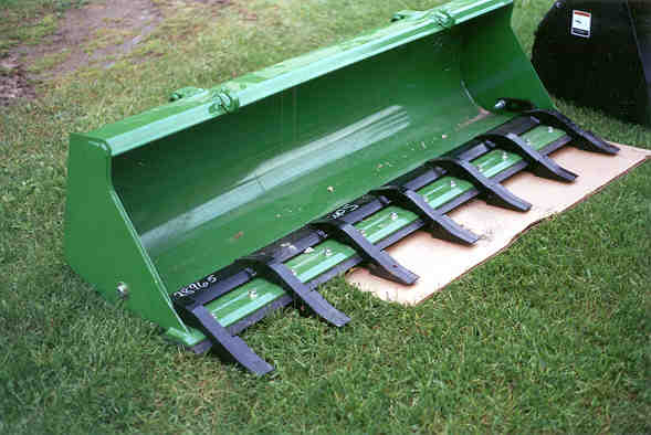

To dig into a pile of material such as dirt, gravel, manure, etc., it is more efficient if you had a toothbar attached to your bucket. The teeth as shown in the attachment will dig into that material pile much more efficiently than if you were trying to dig into that pile with just the bucket's cutting edge. The toothbar attached will cut most jobs down substantially in terms of time. Using another analogy, you would think you converted your bucket into a little tyrannosaurus with that toothbar attached. /forums/images/graemlins/shocked.gif
