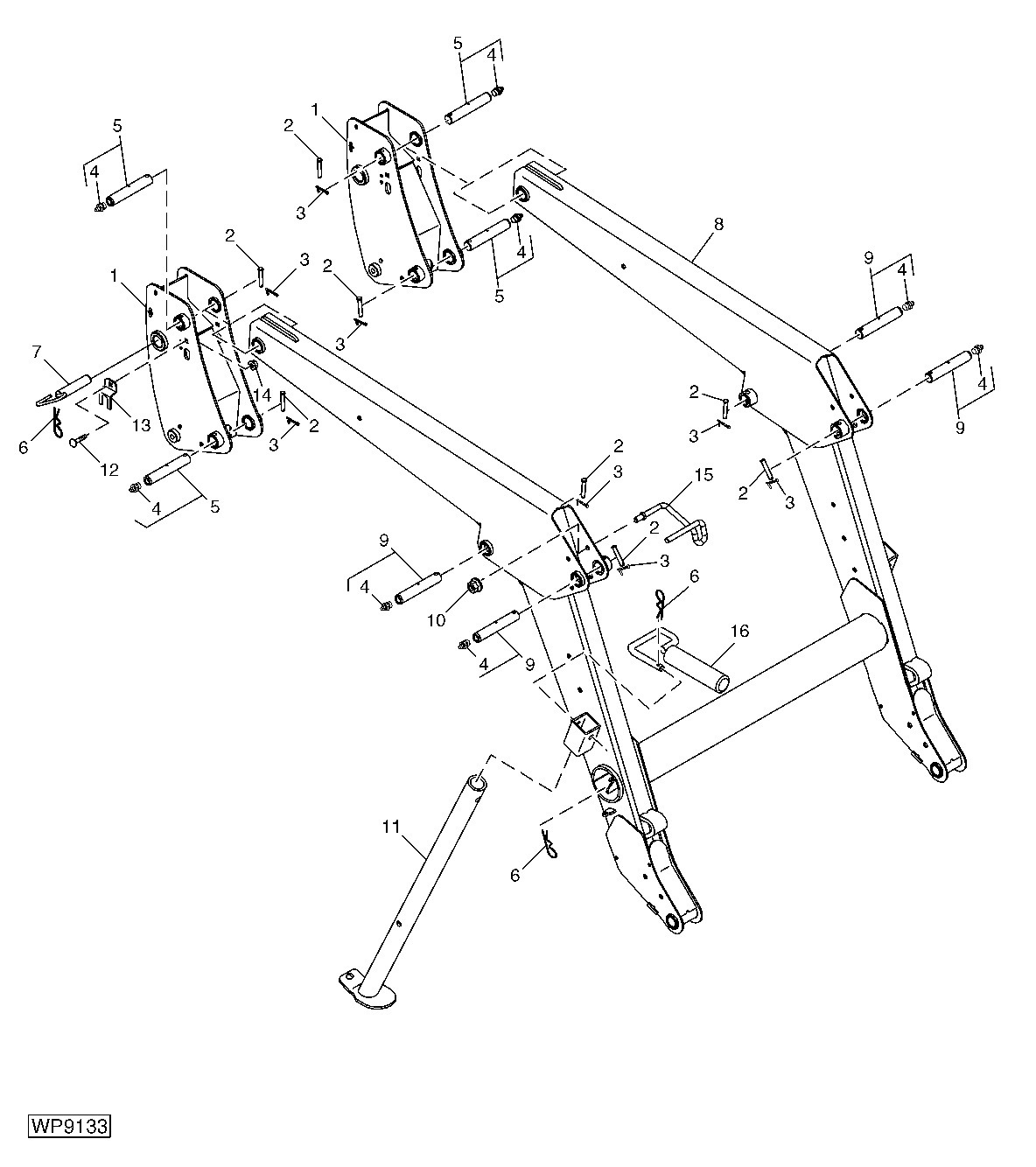

I have a JD 5105 with a 553 loader. It did not come with parking stands.
I was hoping someone might give me some quick specs on the parking stands (length, tube diameter and hole position) so I could build some.
Thanks in advance.
   / To those with a 553 loader #2
Another thought, buy one and make the second one, part number is AW33998. Looks like the price is about $120.

   / To those with a 553 loader #8
I finally remembered about this tonight.
1 7/8" O.D
1 5/8" I.D.
The foot on the bottom of the tube is angled. From the end to the long side is 35 3/4". From end to short side is 35".
There is a hole 5/8 Diameter that is 1 5/8 from the end without the foot. I did not note the orientation but it is for the pin that attaches to the loader I think.
There is another hole 1/2" diameter 23 5/16" from the end. It was not in line with the other hole, but I did not note its orientation. I am not sure what this hole is for.
After getting back to the house I am questioning a couple measurments. The wall looked thicker than an 1/8" like the measurements show and the orientation of the 1/2" diameter hole.
I have never taken mine off, so that is why the hole location is a little fuzzy.
If you cannot figure it out from these dimensions and the diagram in the post I can make quick CAD drawing of it and send you a PDF.
Hope that helps, let me know if you need more info.
#9
Thanks bullseye! I can work with that. I am not trying to make an exact duplicate of the JD part. I just needed the basic measurements to make something that will work.
I really appreciate you taking the time to measure it.
