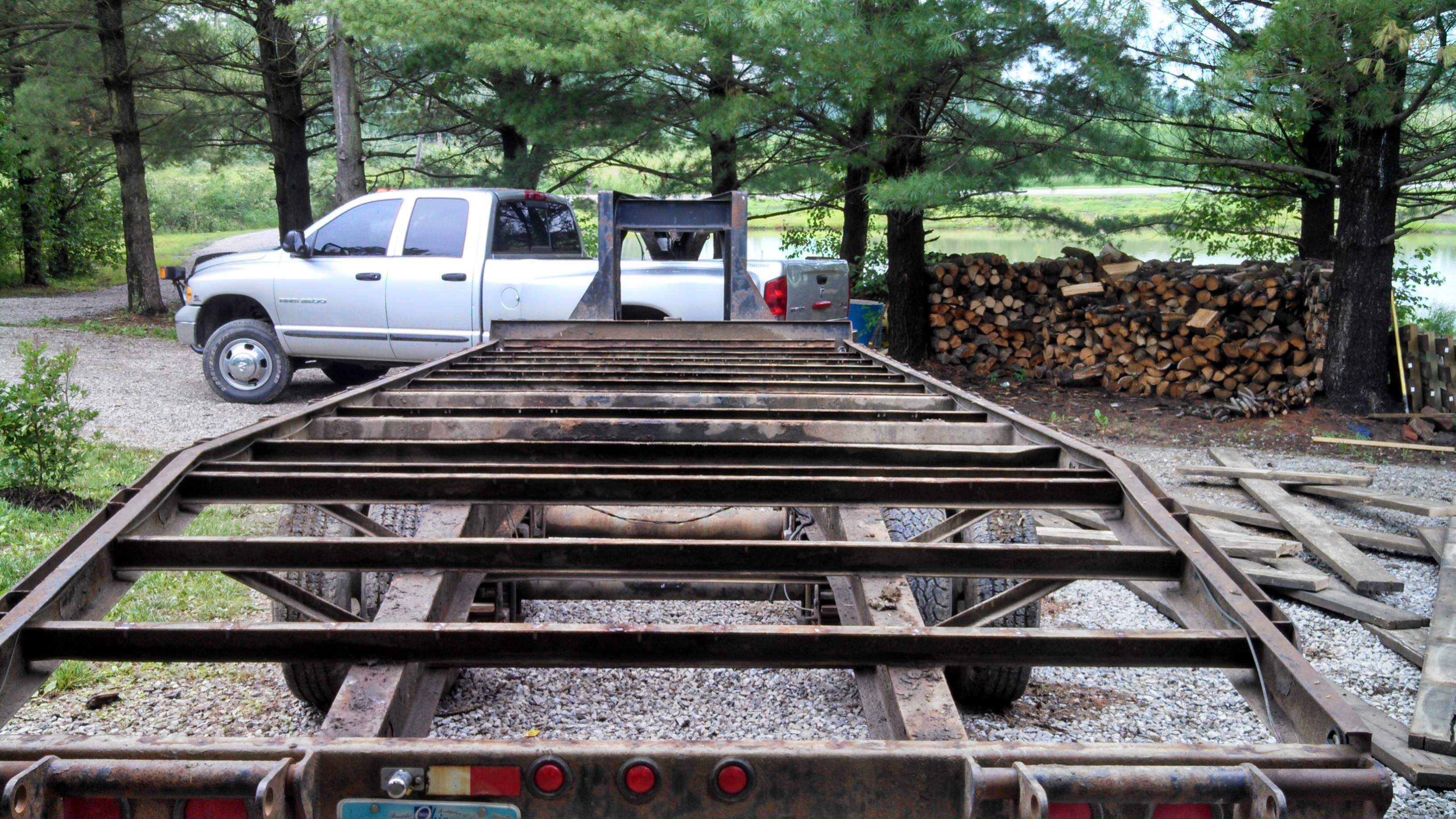

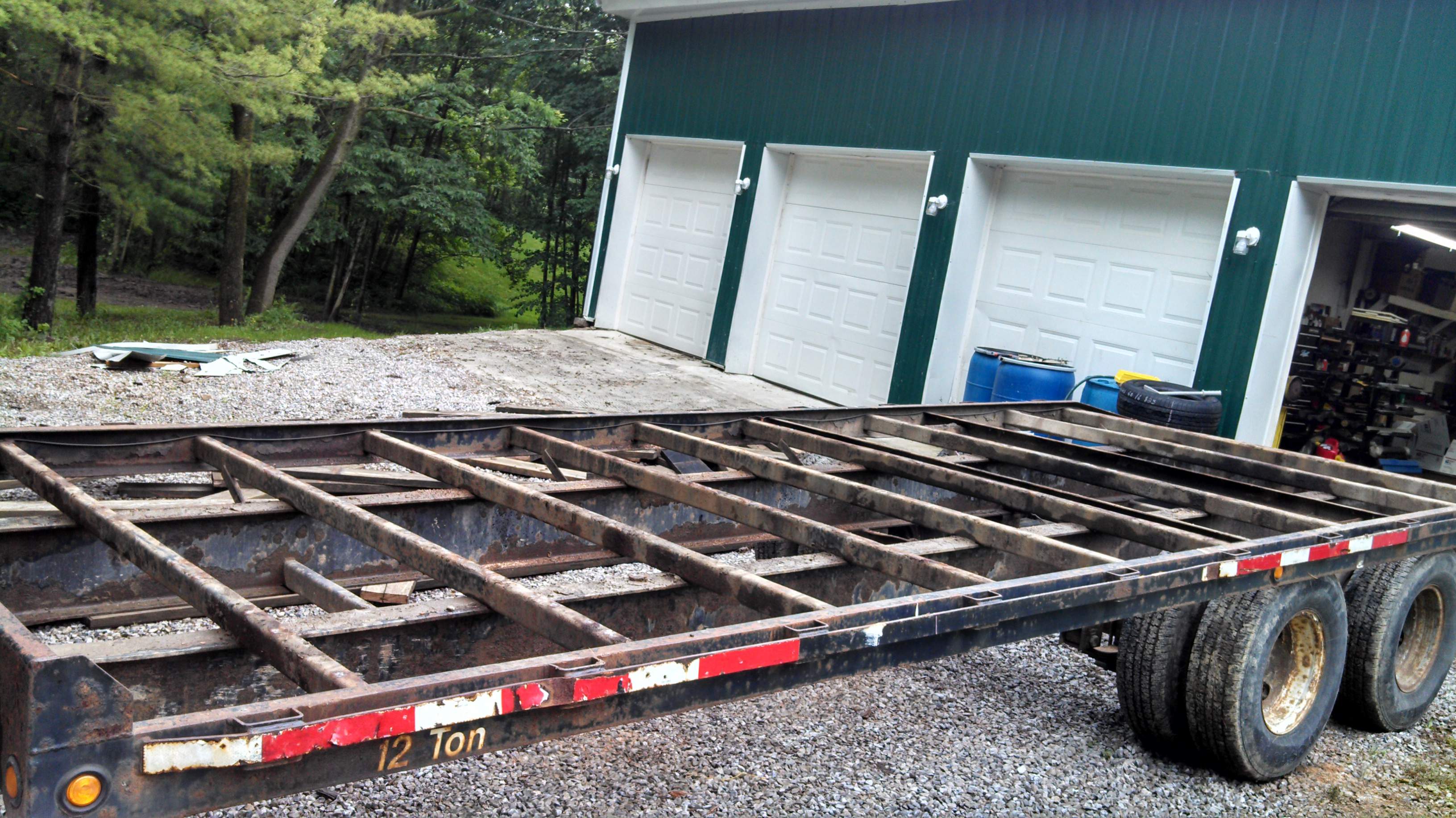

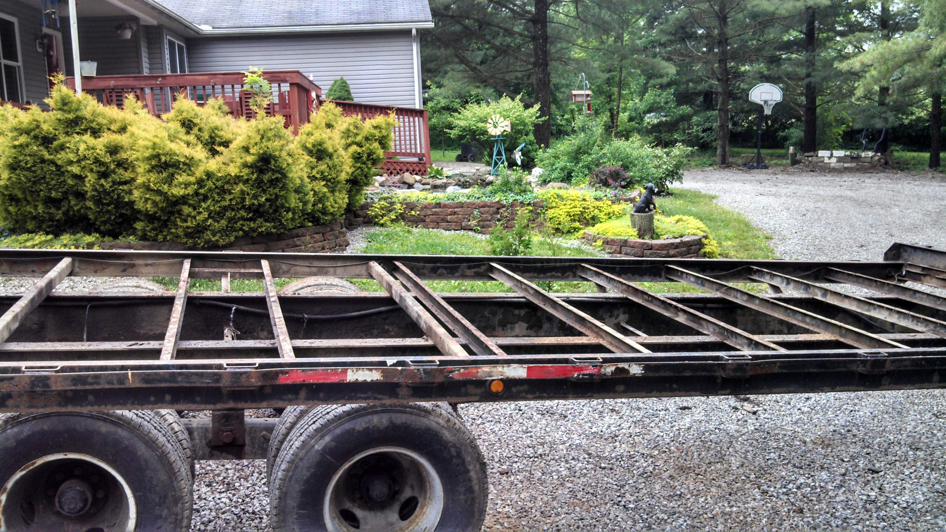

So the trailer I bought and posted about in another thread, I have decided to go ahead and re-deck it with white oak rough cut. $315 for the boards.
Now my dilemma...should I re-paint it??
I am leaning towards not painting it. Because it is alot of work to prep properly, and I honestly just dont have the time. And the biggest reason I think I wont, is because I plan on keeping this trailer for many years. And in 3 or 4 years, if I paint it, it wont look much different than if I skipped the painting this time. Now if I was planning on re-selling with in the next year, then yes I would paint, but I dont plan on flipping this trailer.
So what are some opinions?? If I did opt to paint, painting is the easy part. But prepping :mur: It would take a few days and I'd be covered in rust and grit from grinding and wire-wheeling.

Nice Trailer. Unless you are going to strip it down to steel I wouldn't bother.

If you decide to paint ,I think I would see what it would cost to sandblast or, sandblast myself a little at a time and paint bare metal as I blasted. That's alot of work & time to clean by hand

Take a grinder with a wire wheel to it. Prime it with rustoleum rusty metal primer. Then paint it. That is what I did to mine and it looked as bad maybe worse. The paint was non-existent on the runners. It looks as good as the day I did it and that was almost 2 years ago. You can also get a product called rust mort. It is supposed to kill rust. It is $20 a quart and it goes a long way.

IMHO your trailer frame looks really good to me from the pictures...
Much better than mine...
