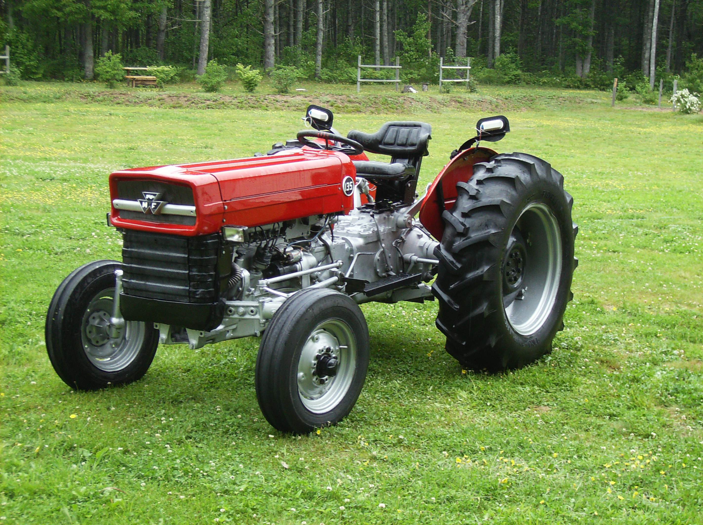

Painted my MF 135 with a gun from a $40 Canadian Tire HVLP set (comes with a paint and touch up gun / regulators for each and all the accessories) outside in my driveway on a calm day in June. You will need to have access to air obviously if you don't have your own compressor.
Took everything off the tractor to paint, did it on sawhorses. I had some base / clear left after painting my 2004 Ram Poppy Red so I put it to good use. Pretty close to original colour. Silver was two cans high heat Duplicolour from Canadian Tire, didn't come in grey.
Depending on the extent of repairs (whether you have cracks to weld or patches to install due to corrosion etc) all other tools are ones you likely already have (grinder, 1/4 sheet sander etc). Not like there is a lot of surface to work, and as you say you're not looking to win ribbons, but at the end of the day you're obviously looking for something more than a roller and drop cloth will provide as well. I've got to say I've seen some nice looking jobs from just rattle can paint jobs for that matter. I worked in my fathers' body shop as a young man so I chose to spray mine.
Several options out there for you to consider, the real question is how much time, money and effort do you want to put in it.
Good luck. :thumbsup:
