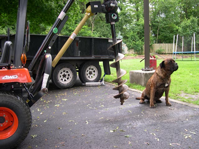

Big Guy,
It was nice speaking on the phone with you. We have had so much rain I didn't get a chance until today to put the PHD (Digger) back on the BX. I made a "stand" for the digger too. I will post that in the "Attachments" forum.
Anyway, attached is a picture showing the ground clearance. The auger is about 42". The picture may make it difficult to judge the clearance. I passed a regulation sized basketball underneath the auger tip (slightly scuffing the ball) in this raised position. How this helps with your decision.
David

Thanks Dave for the picture, yes it does help with the decission as to which unit to buy. I plan to call Northern this week to order a new unit. I have two fences to do in my neighborhood so I'm going to need it. Mark
