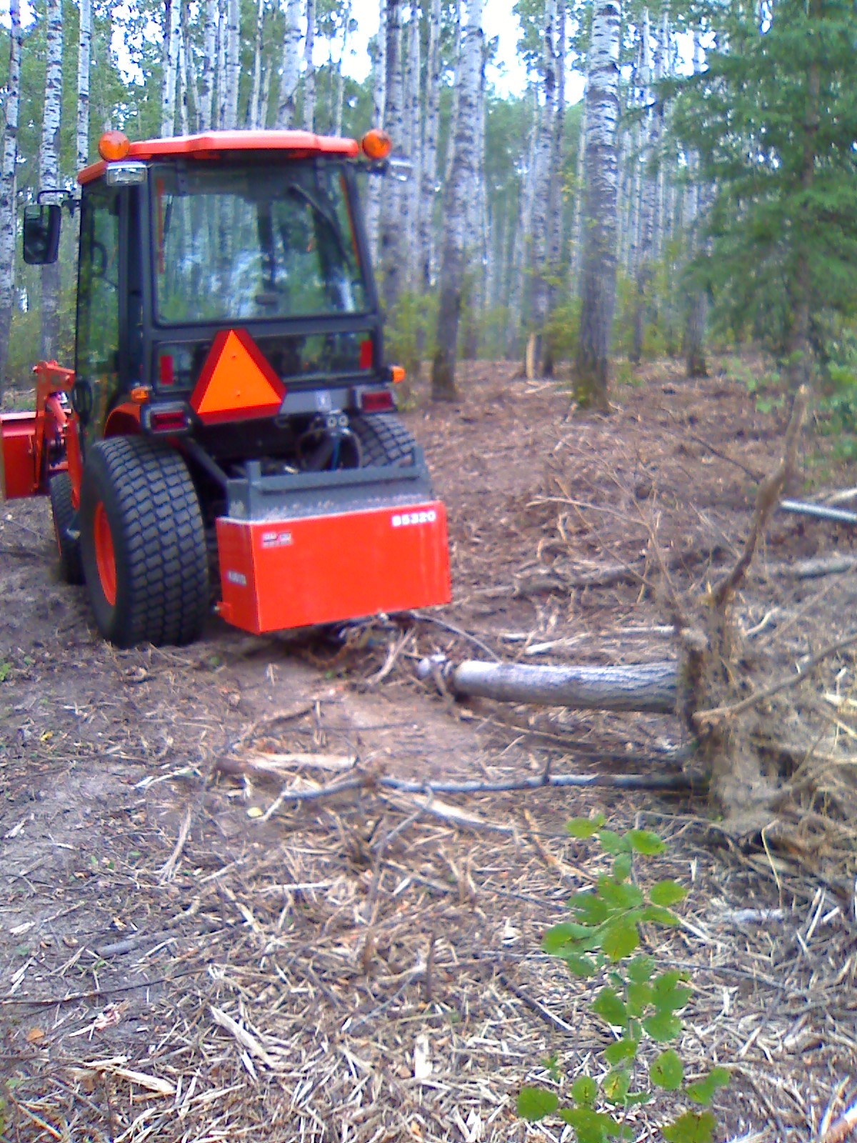

I have a L3800 with a BH77 on the back and never had my tires lift off of the ground. Came close though. My tires are not filled. I would just make a ballast out of concrete and use it when you need it. The problem with the carry all is you have to load/unload the 55 Gallon drum when needed. If you make a concrete ballast that connects to your 3 pt, that would be easier.

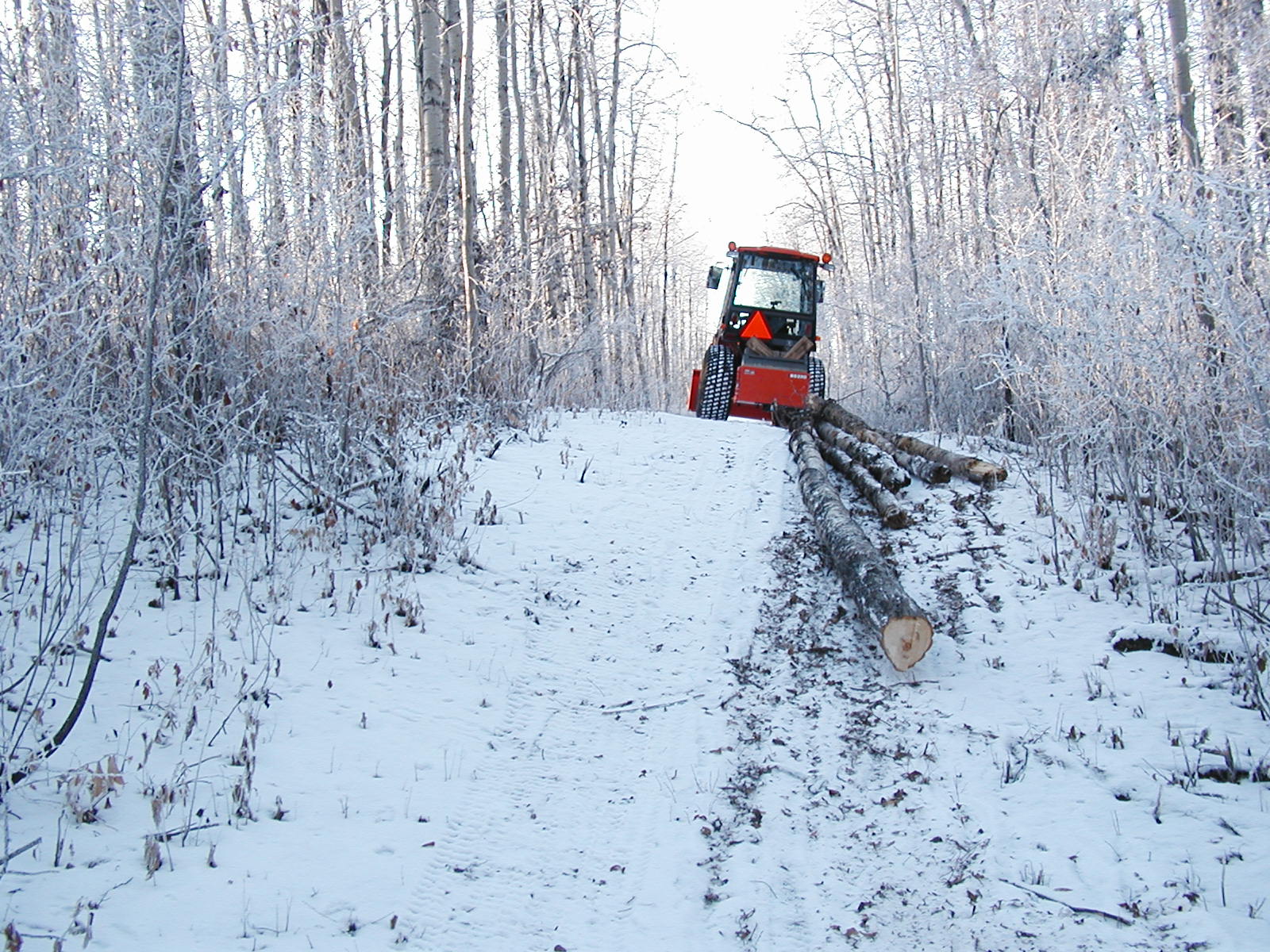

I didn't want my tires filled so I could keep the tractor lighter for mowing when the ground is soft. The dealer had filling the tires worked into the price but switched that to a Kubota ballast box which I filled with scrap steel and concrete. I figure about 900lbs. Works really well with the FEL or if I want to pull something heavy. For pulling I bolted a hitch receiver to one of the scrap pieces of steel inside the box before I filled the rest of the space with concrete. Also embeded a frame in the top to make a space to carry chains or tools.
