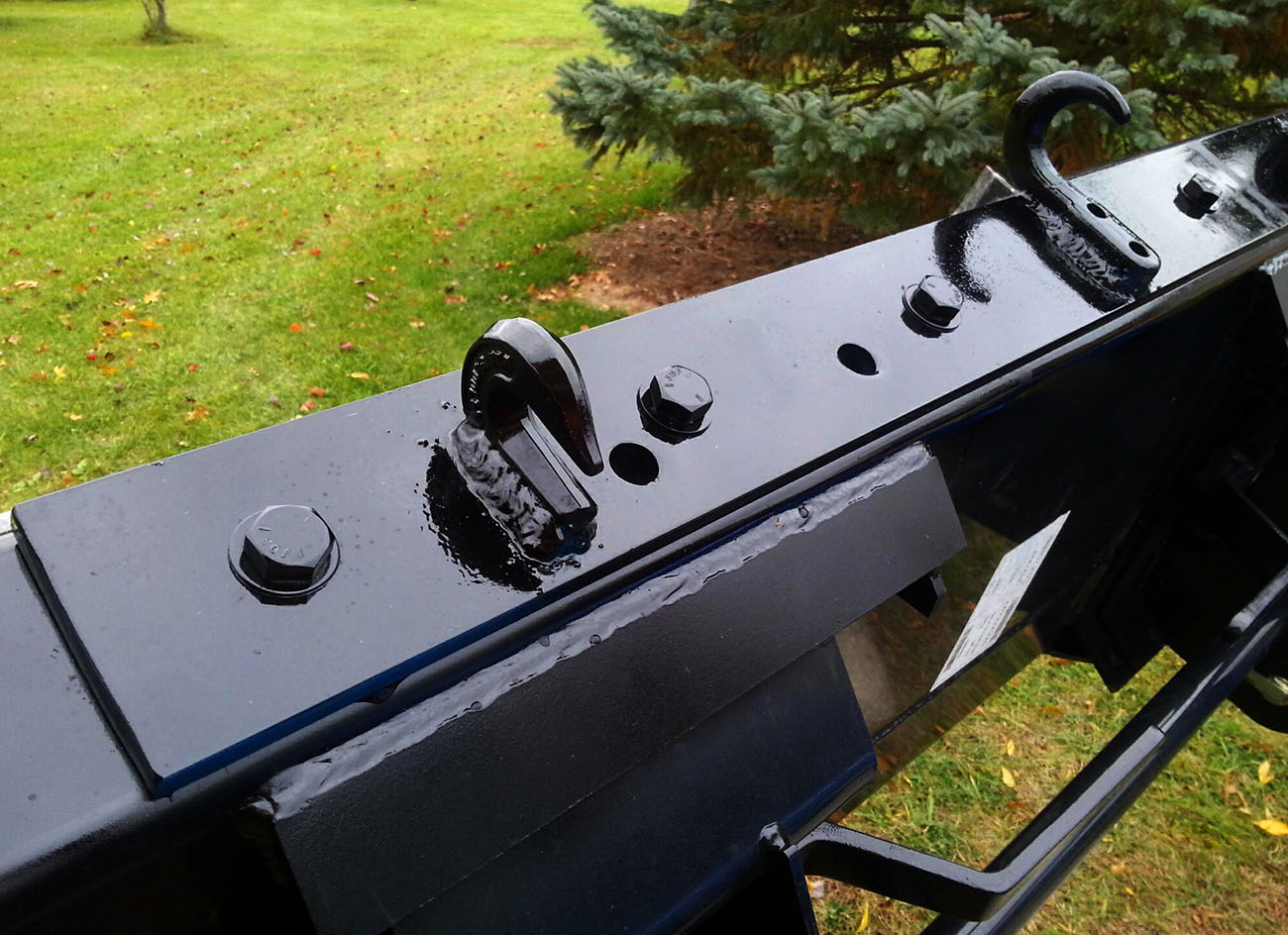

I love to stick weld (use an old AC buzz box) and use oxi-acetylene as well but have been thinking of getting a MIG welder. I did some MIG using external Argon tanks MANY years ago when in HS when I first learned how to weld and have wondered from those who have tried both if the gasless MIG's that use coated flux wire work as well as "bare" wire and a stream of gas? Pro's Cons, etc, etc Tnx !

Thanks Eric I appreciate your experiences with both. My main interest is to weld better in other than flat-down or mostly horizontal type welding or thinner metals.
My vertical up's & down's etc suck LOL. Horizontal welding I can do well enough and I know with some proper training & experience (and proper choice of rod) I could do much better.....it's just so darn easy & fast to weld in almost any position with MIG. It would be nice to have a "MIG" welder w/o having to maintain another huge tank of gas if the flux coated wire works as well.

Hiya Dale and thank you for the great info & advice. Ehhhh, got 2 big tanks already what's one more? <g>.
Somewhat off topic from my original post but am wondering if you think MIG can be used for steel up to say 3/8" thickness? That is about the thickest metal I can see myself welding, like when I just welded on hooks to this 3/8" plate steel. If so what current rating machine & wire diameter would be appropriate or needed?

There is no" single best" process,but there are best processes for various jobs,skill level,expense and any number of other considerations. If majority of projects are 1/8" or less,gas shielded is a good choice. On the other hand many homeowner machines handle either process but will weld thicker running flux core. Then of course there's the question of welding outdoors where flux core get's the nod.
