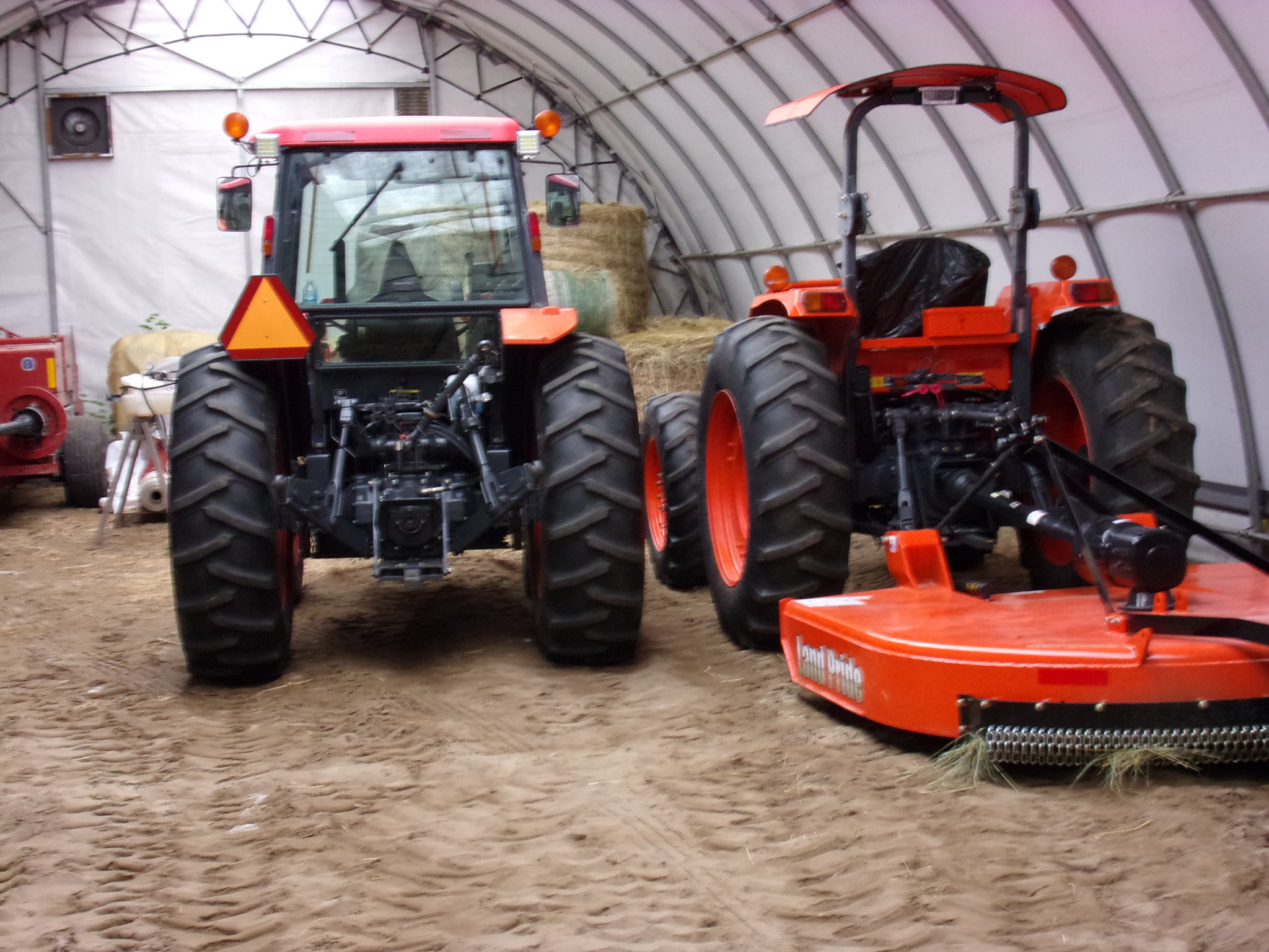

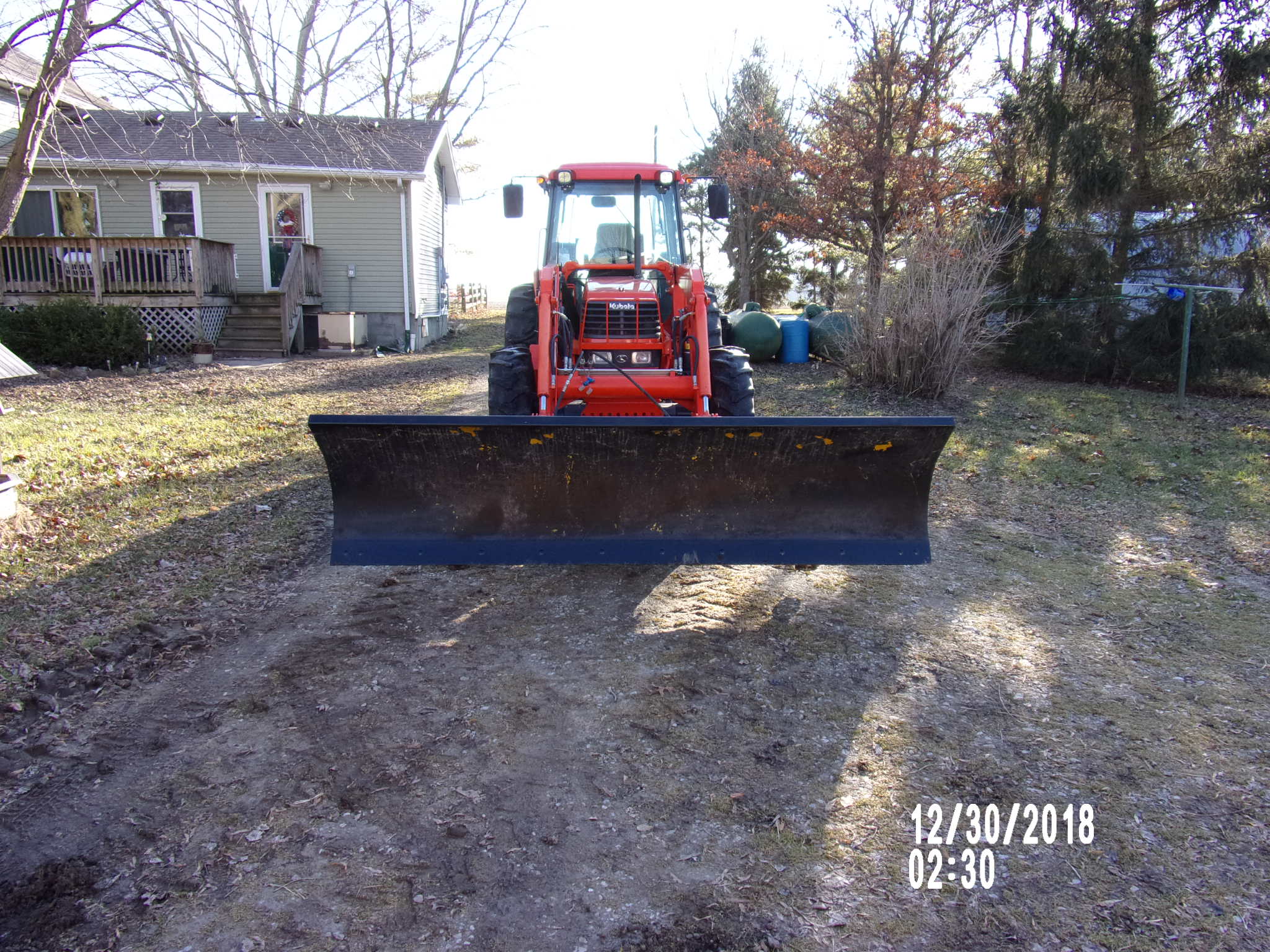

I have 2, one with and one without. The one without stays in the barn all winter. Nothing beats a cab for moving snow, putting out cattle feed and any wintertime chores and I too have used my cab in the woods. You just need to be cognizant of branches.
