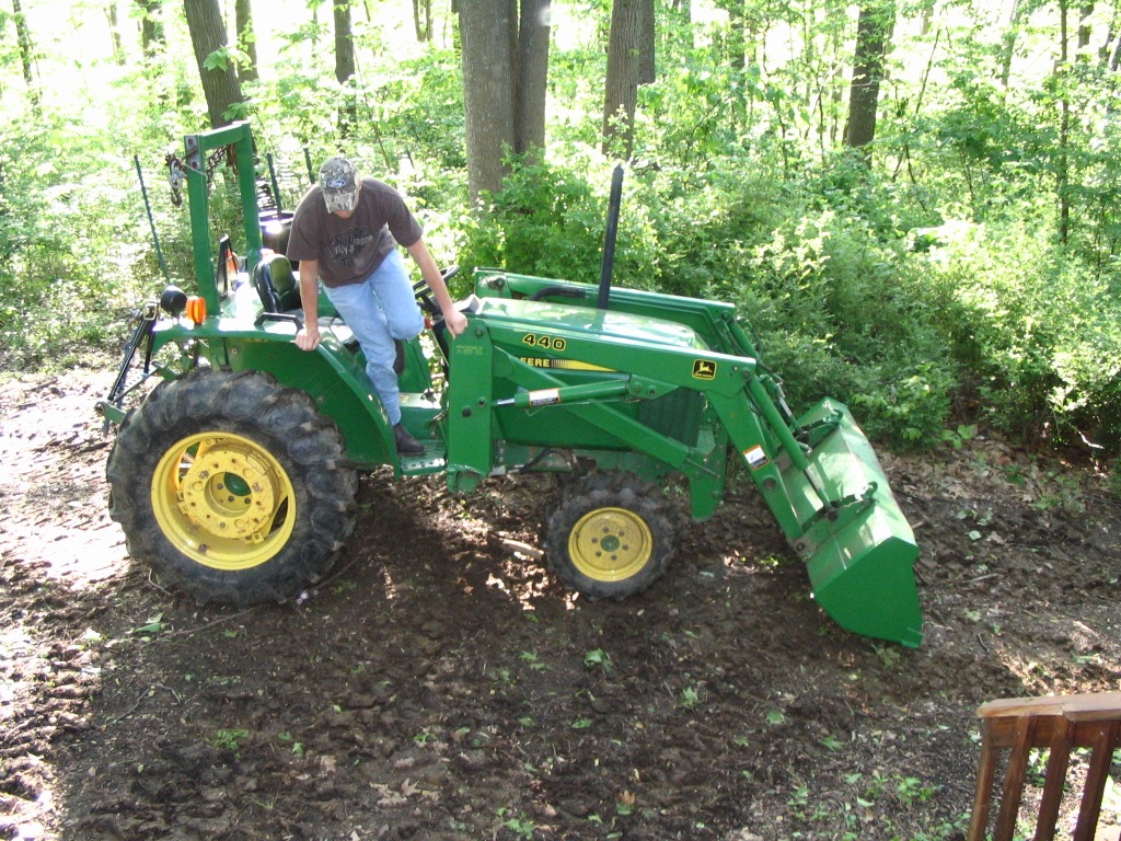

My son was using my '96 870 when a hitch pin on the TPH lift arm fell out.
The lower arm fell down and he inadvertently backed over it, snapping off the front pin which bolts into the case.
J.D. wanted $98 for a new one! I turned down both ends of the pin to 45 degrees and had it welded. Working fine so far. The only parts I've needed in 12 years have been battery, filters, etc. One fine, tough tractor.
   / To all JD670 thru JD1070 owners
That one is a beauty. It's either reconditioned, wasn't used much and spent its life parked indoors. Great machine and continued good luck with it. They started the 850's with 11.2 rears but the one I'm looking at being an 870 has 12.4's outback so just wondering if this size came from the factory
