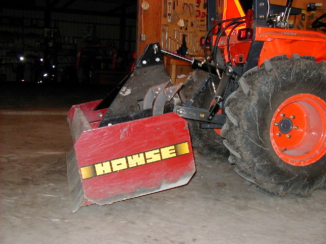

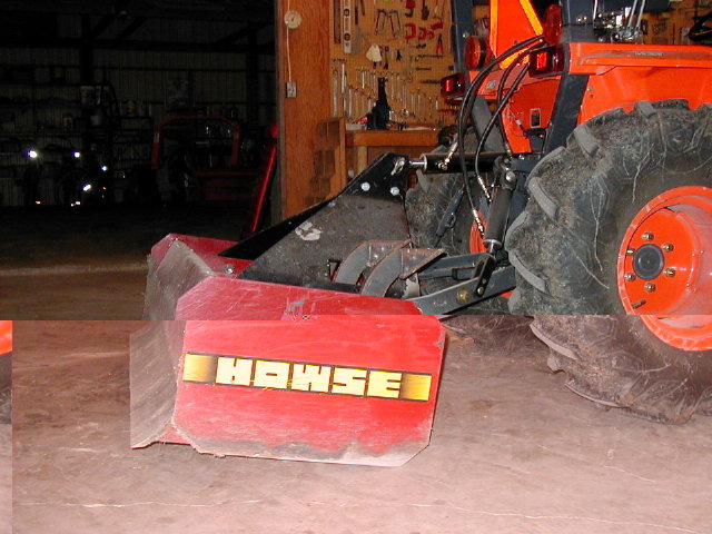

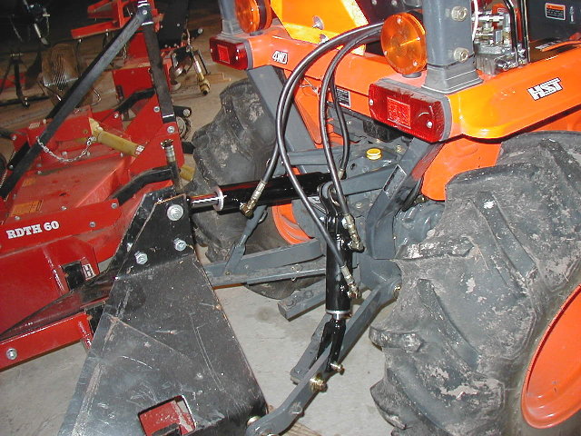

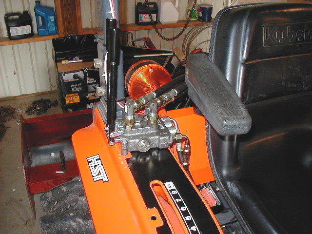

I can at least get you started. The Top 'N Tilt refers to a double acting hydraulic cylinder to replace the exiting top link on your 3-point hitch and another double acting hydraulic cylinder to replace one of the two side links. That way you can hydraulicly tip the top of an implement forward and backward with the top link and tilt it side to side with the side link. So you need two cylinders of different sizes, and four hoses (two to go to and from each cylinder). Now that's IF your tractor is already equipped with two pair of remotes. If not, then you need a two spool valve, and two hoses to go to and from the valve and a hydraulic outlet on the tractor.
The first photo shows the two cylinders I put on my B2710, the second photo shows the hydraulic valve, and the third and fourth photos show how my box blade could be adjusted forward and back. And of course it could also be tilted side to side.
