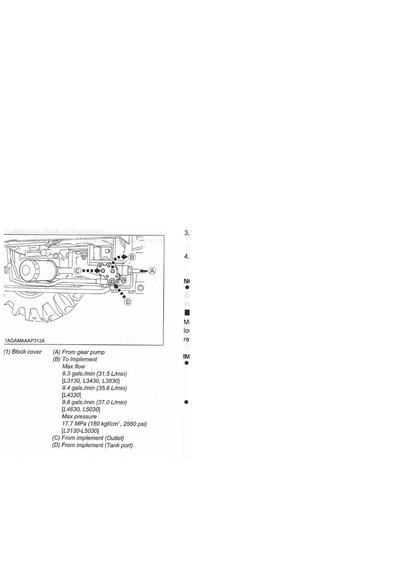

Mad, attached is a document from my manual.
I wanted to have you look at it and comment.
From what you said, I will be connecting to "C" from Implement (outlet) and D (tee) from implement (tank port)
TIA

</font><font color="blue" class="small">( I will be connecting to "C" from Implement (outlet) and D (tee) from implement (tank port))</font>
In their diagram the implement is the loader. So...
"C" is connected the PB line from the loader . Disconnect this line and run it into the CCM valve's inlet using either of the methods I described earlier. Connect the CCM PB port to "C" on the hydraulic block.
"D" will get a Tee fitting and both the loader and CCM valve's return to tank hoses will connect here.
Simple.
