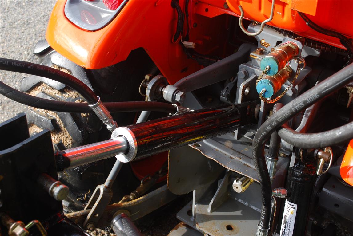

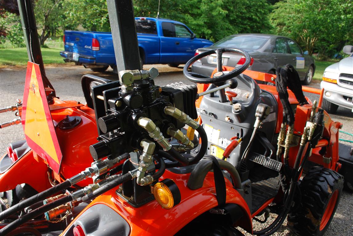

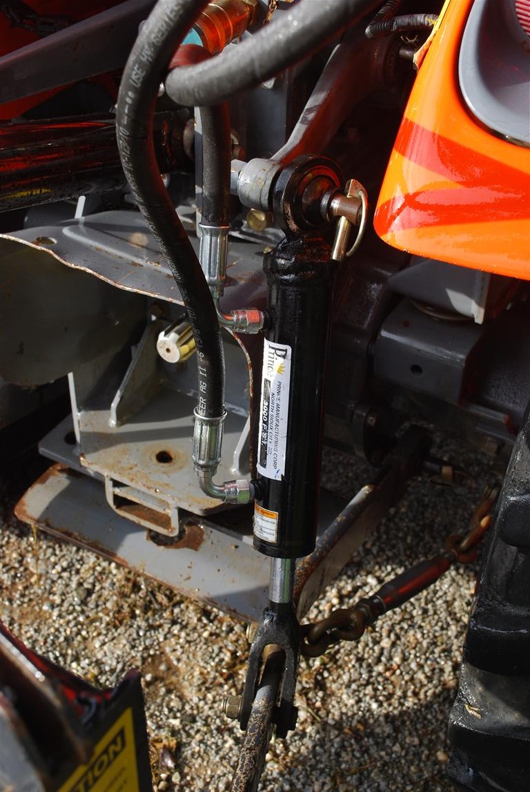

I made one for the CK 20. I tied it into the hydraulic block coming of the pump just behind the right hand bearing box for the front end loader. If you are intrested i can send you a list of what you need to make it. You will need to do a little welding and custom fabrication but it can be done if you are good at that kind of stuff. All said and done it cost me about $900 - $1000to make it. All the hoses had to be custome made so that added a bit to the price tag. The valve is a prince valve with float on the third arm cylinder for when you are running a rotary cutter. It also has a power beyond port for later growth if you need it. All the hydraulics are quick attache so you have 2 more remotes if you ever needed them and didnt need the TNT.
