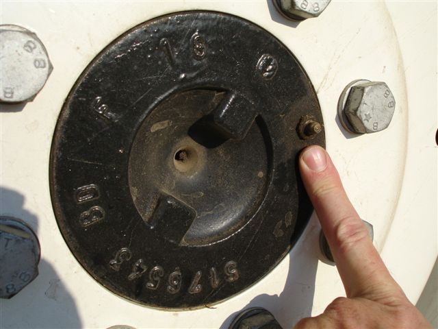

Here is a picture of a zerk fitting on the rear wheel of a TN 70A. Do I grease it? How much ? will I "blow" a seal??? What kind of grease? Same grease as I use on FEL?

Yep that looks like a grease zerk to me too Bob. /forums/images/graemlins/wink.gif
Suppose we should give it a pump or two of grease since it is a zerk?
OK I'm pulling your leg a bit. Any grease in a zerk is better than no grease in a zerk. Just don't pump a full tube in there and ruin your day. /forums/images/graemlins/grin.gif

I am in no hurry to grease it until I know what I am doing. haste makes waste. I hope some of the TBN folks can let me know what they do. next call, to the dealer!

Having recently purchased a used TN65 I understand your questions about the various drain plugs and zerks. These are things that need to be known if one is to properly maintain a tractor.
Per my manual the zerk on the real wheel is for NLGI 2 grease or Ambra Gr9 (if you prefer NH brand). I believe the procedure is to pump it in just until it oozes out the back side of the hub, and to do so on a regular basis based upon level of use.
You seem interested in properly maintaining your investment. If you do not have an Operators manual then might be a good idea to pick one up. The manual I have has a maintenance section that seems to do a good job of covering the what, when, where, and how of routine maintenance procedures.....plus it has decent illustrations.

My manual is in the mail (literally) and I am not sure if it will ever arrive. next week, I will buy one (ouch$$).

I called the dealer. yes, grease is a good idea. Did it today.
