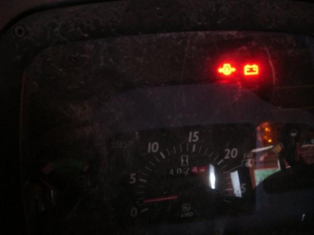

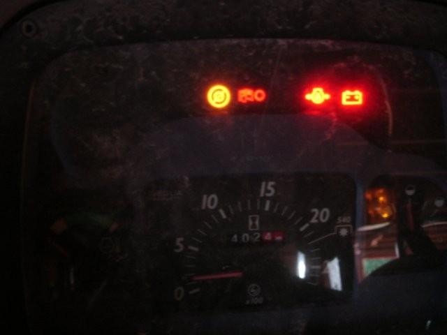

After the dash does its self-test routine, is the PTO light lit? If you push the clutch pedal down slowly, can you hear the pedal switch click when the pedal is about 85% down?

I will take a pic of the dash, so that I do not mislead you. it will take a few minutes for me to upload.
Yes, the clutch switch does click about 85% on the way down. but, just like the picture, I will check it and get back to you.

   / TN70A won't start?
Answers to your questions.
Yes, at 85% I hear the clutch click.
Here is the picture of the dash lights when the key is turned to the on position.
Here is the same dash a few seconds later with the key in the on (not start) position.
RickB, thanks for the help. Have i answered your questions?

   / TN70A won't start? #7
Questions answered. Time to check the fuses, and check the start solenoid for power when the key is turned to 'start'. The PTO NSS appears to be closed, and the clutch pedal NSS appears to be closing.
