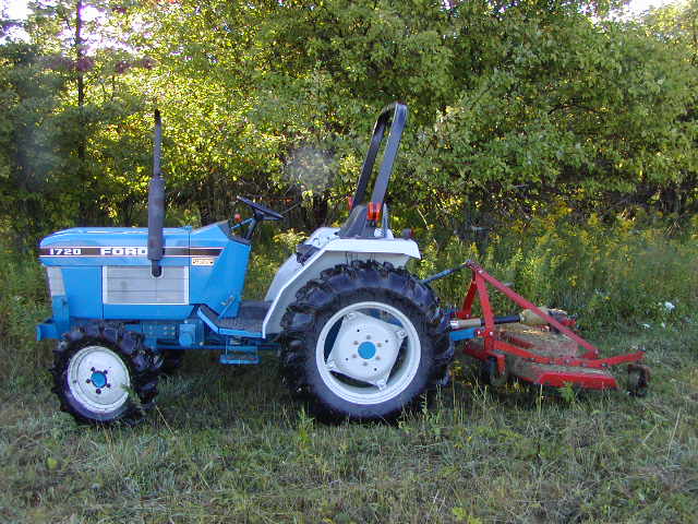

I tried attaching a photo of my 1720 with loader off for mowing, but it didn't work. I'll post it after I figure out how.

The 1720 is great in the woods, but is on the small side for mowing the fields. The TN65 with a large mower would make much faster work of the place. With the backhoe I could clear out several stone foundations, dig footers, and clear out roots of brush I've cut to clear fields.
I'll try attaching a photo of my 1720 again.
