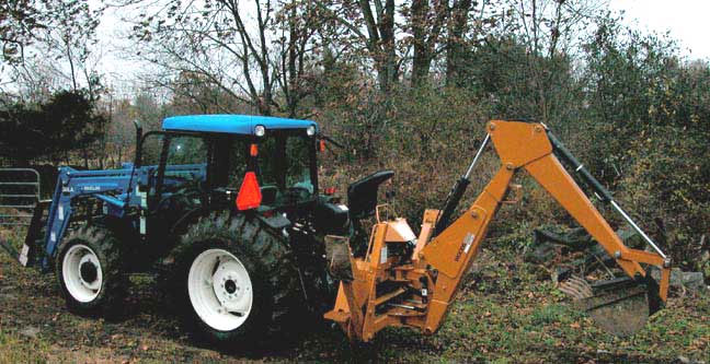

   / tn with a backhoe #5
I've run a Woods 1050 3pt hitch backhoe on my TN75D for years with no problems. My dealer who is adimant about using subframes on anything smaller than a TN had no problem with this setup. This is a very heavy hoe and has a very substancial frame that bolts to the upper link holes on the tractor. There is no movement of the hoe vrs the tractor. I previously ran this sam hoe on my TN75S. True Cat 2 hitches adn tractors just can't be compared with Cat I.
Andy
   / tn with a backhoe #6
Here's a picture of my TN75 with Woods 1050 backhoe.
Andy
   / tn with a backhoe #7
Nice setup you got there Andy. :cool:
   / tn with a backhoe #8
Andy
very nice machine!
Bob
   / tn with a backhoe #9
Thanks, and guess what. One more payment and it's all mine!!!!!!!!
Andy
