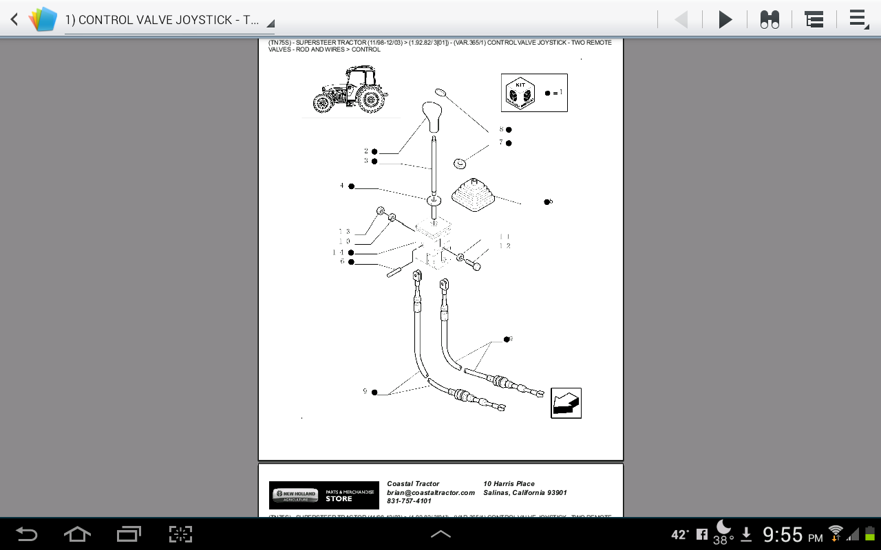

As the title says I am having trouble with my loader joystick cables sticking. I have tried lubing them to the point of trying to force lube into them with an air compressor to no avail. I feel I have got the point where it is not going to be fixable. So, my questions are- Is this common? (I have not seen very many people having this problem.) My options, as I see it, include buy the new joystick/cables assembly for close to $400, risking the same thing happening again. Or, buy something like the prince loader valve, eliminating the cables and any future problems with them, but necessitating plumbing lines up to the valve. Anyone deal with this?

I deal with these on vineyard tractors that have lots of hours under corrosive and dusty conditions, but haven't replaced any yet.
Have you disconnected the cables from the remote valve and tried moving? Thinking the remote valve might be binding.
Also, those cables are about $105 each. Not that that is cheap, but you don't have to replace the joystick.
   / Tn 75s loader joystick cables sticky
Yes, I have made sure that it was the cables. Also, I have been to two dealers and my joystick is only available as a unit. The one that you pictured is actually one they sold me that was wrong. They showed me mine and said I couldn't just buy the cables. The other problem I am running into is we are having subzero temperatures and the cables are so stiff they just don't move at all!
