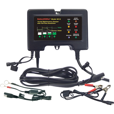

I need a new battery in my 2007 truck. Its died a few times in the shop when the tint guys were doing the glass and again when they replaced the roof skin, they kept using. Now it has died twice on me at home. Both times was when I used the factory remote start, it doesn't start than the radio and lights stay on killing the battery. It's fine the rest of the time. So here's my question. I've learnt a little on here about desulfation. Is my battery beyond repair or is it a prime candidate? Is the process like preventative maintaince or is it reactionary repair?
Thanks for all and any help and suggestions.
I use this truck as a service truck so it needs to be reliable.

That bottom line of yours says it all, New battery time.

Figure most 2007 stuff is built in 2006. It owes you nothing and life is too short. Don't be cheap, get a new battery.....lol

i'm no battery expert, but i think sulfation generally happens to batteries that are left unused for long periods of time. it sounds like this isn't the case with yours. i've seen some pictures of home-brew units to fix this, but it looks like they take a lot of time to do the trick - likely a lot longer than you can go without the vehicle. i'd say buy a new one for now. maybe take a chance and keep the core and build / buy a desulfator to see if it works.
around here when batteries go for long periods without maintenance or use they often end up freezing in the winter, and then the resulting fluid expansion puts the plates in contact with each other, rendering the battery useless. i've never had the interest to see whether a desulfator works yet myself, though it might be a fun project to try sometime.

We're trying one of these at work for cars that are in storage for extended periods of time. Unfortunately it will be years before we find out if it actually extends battery life ;)

I typically replace them at 5 years regardless. The battery is the most abused item in my truck. I don't want to take a chance in my wife's car. So the DDs get new batteries. If the batteries are still good, I put them on a trickle charge and use them on our smaller equipment. My charger has the de- sulfurizing feature, but it won't revive dead batteries.
