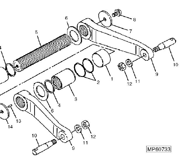

I am trying to remove the pin in one of the arms on the 3 point hitch lift arm on a JD TLB 110, I believe these are the same as JD 4000 and maybe 3000 series tractors. I have looked for drawings in the JD parts web site, I have tried loosening the nut and tapping the pin out and unthreading the pin and not luck. Can anyone tell me how the pin is in there before I try harder, is the pin threaded, pressed , pressed on tapper?

Here is a graphic from the parts list, no detail in the service manual. Looks like the nut and lock are whats holding it, other than any corrosion. Might try a pneumatic air hammer or arbor press? Pin has taper, or maybe just stuck?

Thanks that is the page I was looking for and can not find, now that I know how the pin is in there I can try with more force. What section did you find this in?

Before you try removing it..... spray some Kroil penetrating fluid on it.... That's the best penetrant I've found.......
In the 70-Hydraulics Section, 32-Rockshaft Control Lift Arms

Maybe try some heat and then the penetrating oil.

I gave it a good spray with kroil and applied some pressure pushing on it then a couple of good hits and it came out. Thanks for all your help, it sure helps when you know how its assembled.
