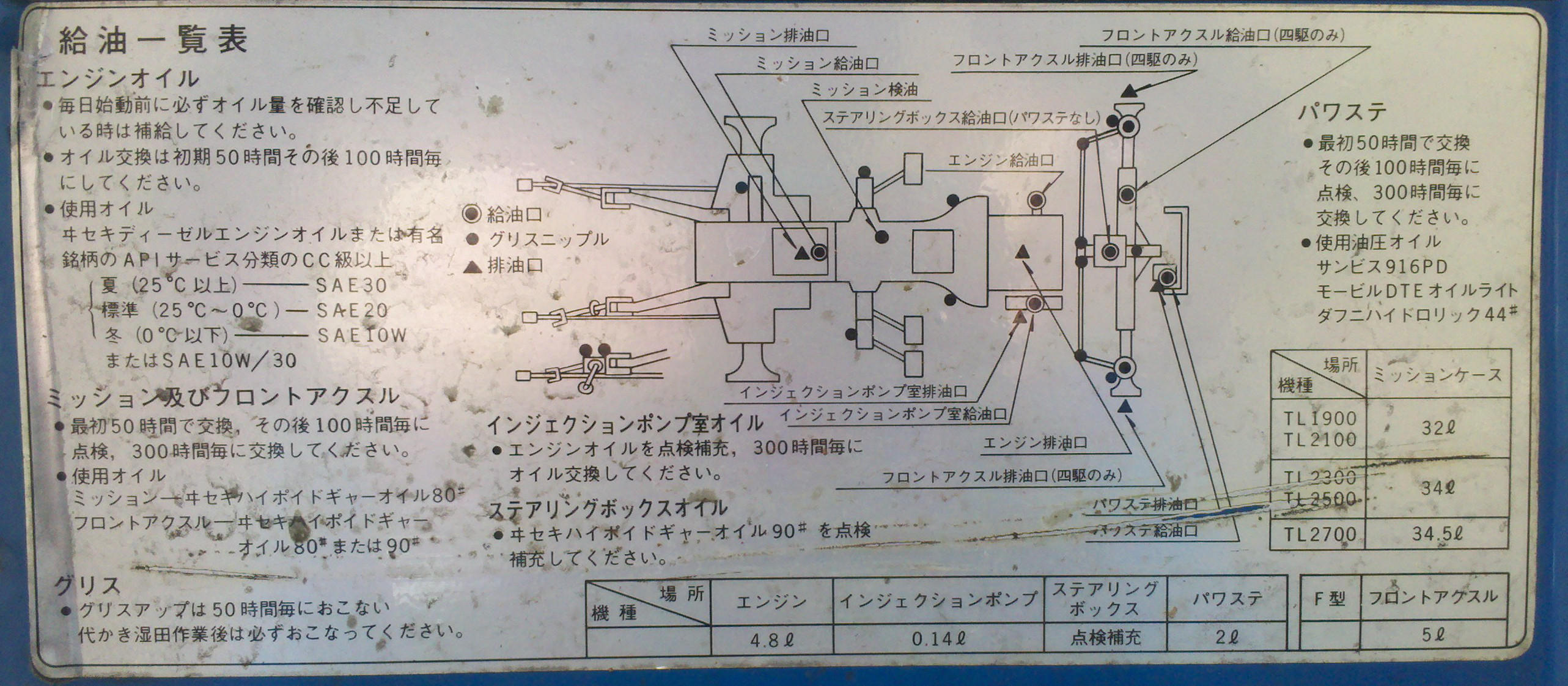

I have a 1985 iseki tl1900. Can anybody tell me about the hydraulics on this tractor. Should I use standard tractor hydraulic fluid and does it go in on top of the transmission? Also how much does it hold. I have read some other stuff on it and I think there is supposed to be a dipstick on top of the transmission housing but mine only has a cap there. Thanks for any help on thus subject.

The way i interpret this schematic under the hood of my TL1900 is that it takes 32 litres:

Forgot to answer your other questions.
Hydraulic circuit and transmission share the oil, all the Iseki manual of similar tractors state that the oil to be used is gear oil SAE 80
There is a dipstick on mine
