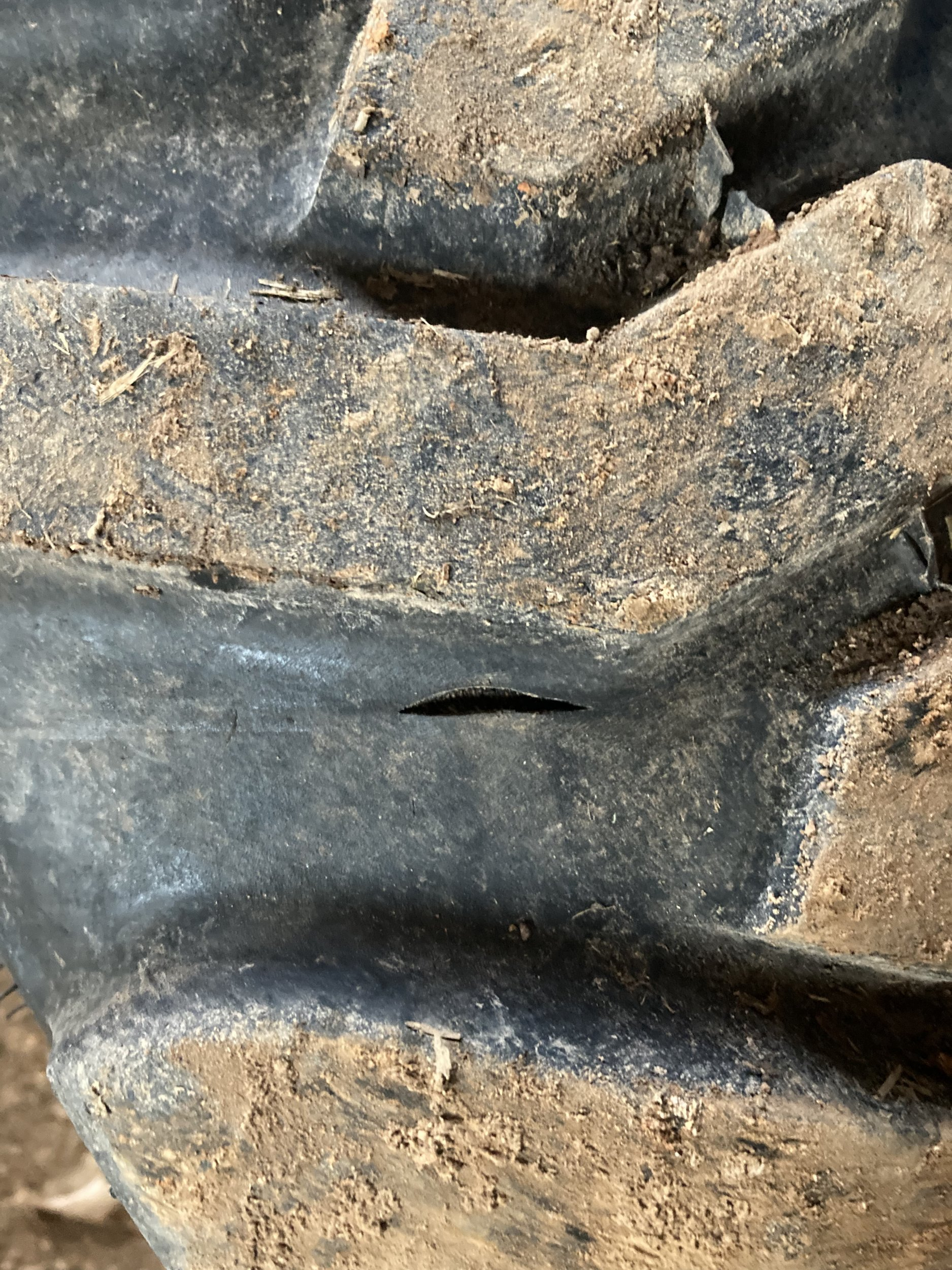

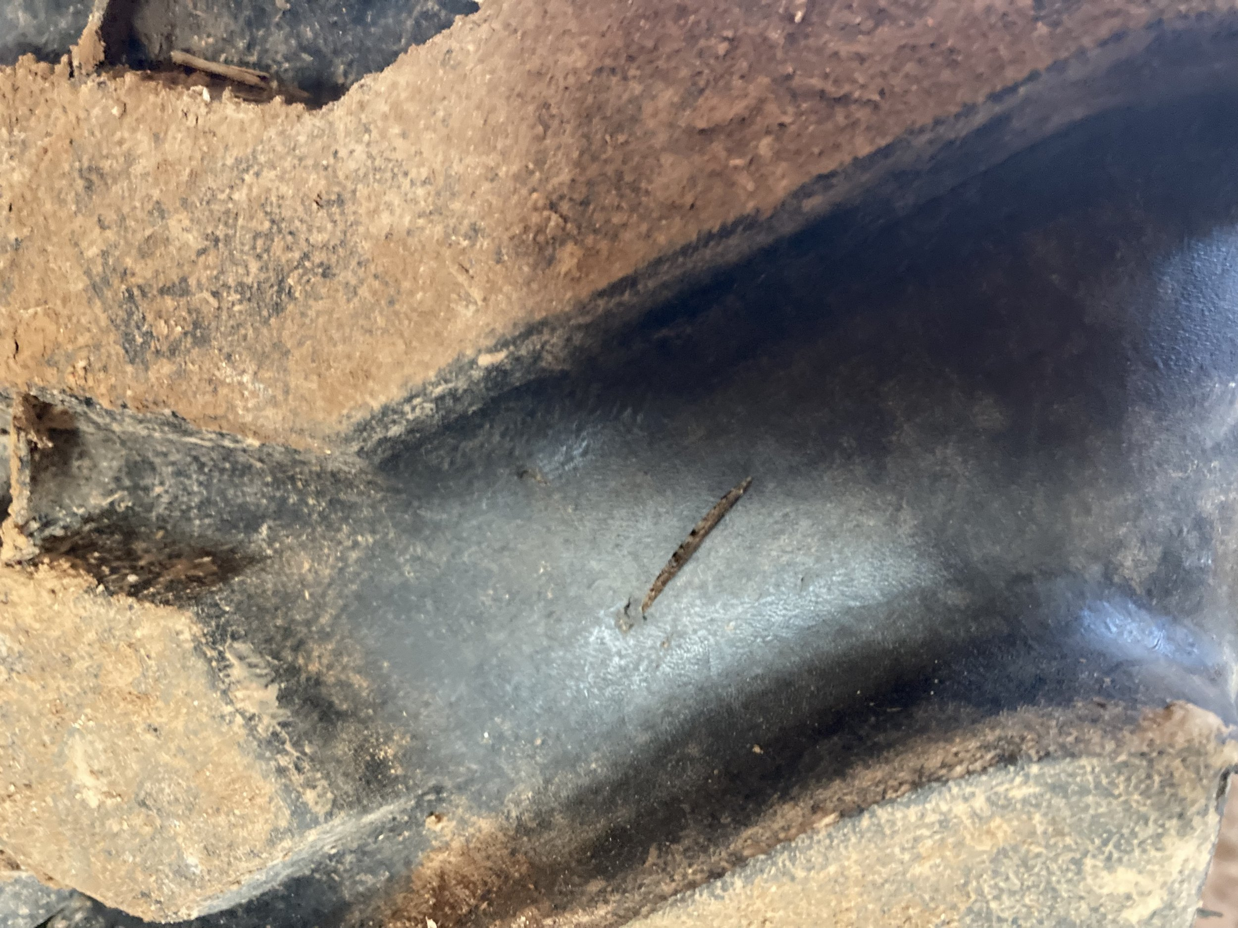

Both front tires on my 2020 MT345e have a cut in between the treads. Does anyone know if the tires are covered under warranty? I haven’t been able to reach the dealer today.

When I bought my 6530 new in 2007, the front R1s had already started concentric separation rings at the start of the lug. I later went by my "have any kind of tire for anything" Titan dealer and he got in touch with Titan. They wanted pictures which he supplied and a matter of a day or two I had 2 new tires without cracks. I guess you would say that's honoring your warranty.
Fast forward, 2022, the new tires developed the same thing but over the years they have only slightly enlarged; nothing to even talk about. The rear Titan R1s have shown zero implications of cracking.
My take on their tires is that they have a tough rubber compound to resist wear and as a result don't include a lot of plasticizers that, when the tire is flexed in use, keep the rubber supple.....but that condition also leads to premature wearing. Damned if you do, damned if you don't..........

I had a couple of the same cuts on one of my rear tires when I bought mine in 2015 (I have R1's). My dealer told me he thought it was cut by me running over some glass. I had only run the tractor around my yard at that point, so I didn't think that was the case, but they weren't too deep, they haven't changed in the years since, and it hasn't caused any issues. Perhaps they are a side effect of the manufacturing process?
   / Titan tires warranty #6
Torque cracks.
Nokian skidder tires in the 28L size iirc, did that after little usage. They were warrantied them.
