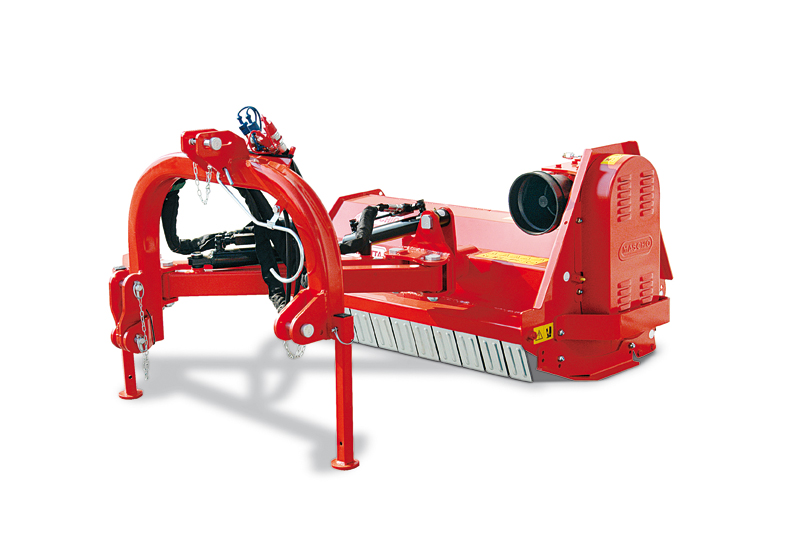

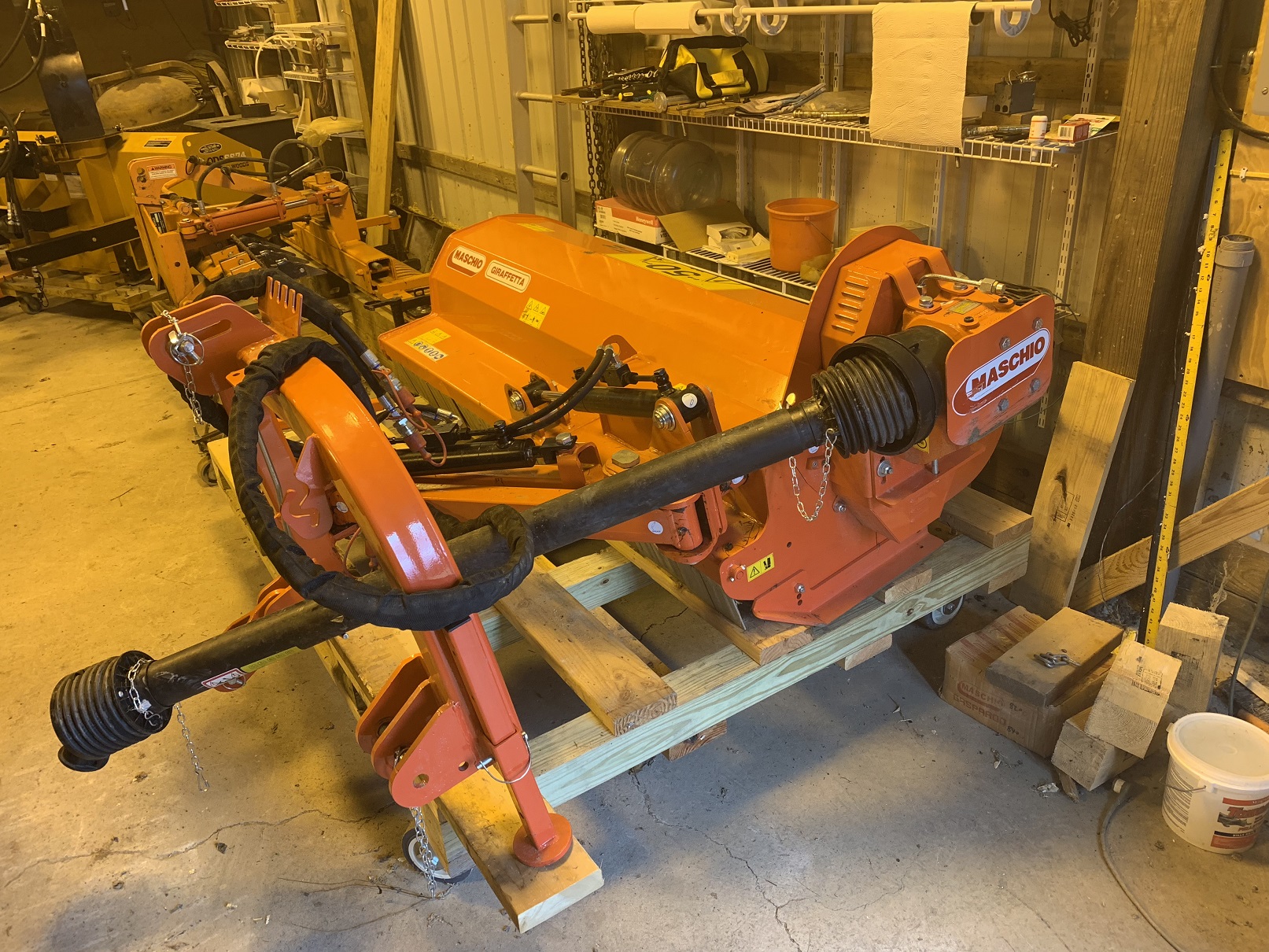

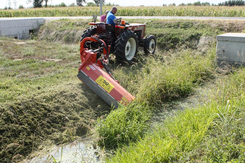

I have a Maschio Girafetta 72" offset flail which is similar to the Titan design. It works well for mowing the ditches along my 1.25 mile private road. It sure beats backing down the slope with a brush hog. I also use it in the vertical position to cut back branches & undergrowth that encroach on the roadway.
IMG_0398a.jpg IMG_0399a.jpg maschio-giraffetta-mower-1.jpg maschio-giraffetta-mower-2.jpg
I strongly recommend getting hammer flails as standard knives take a beating on rough ground and heavy growth.
