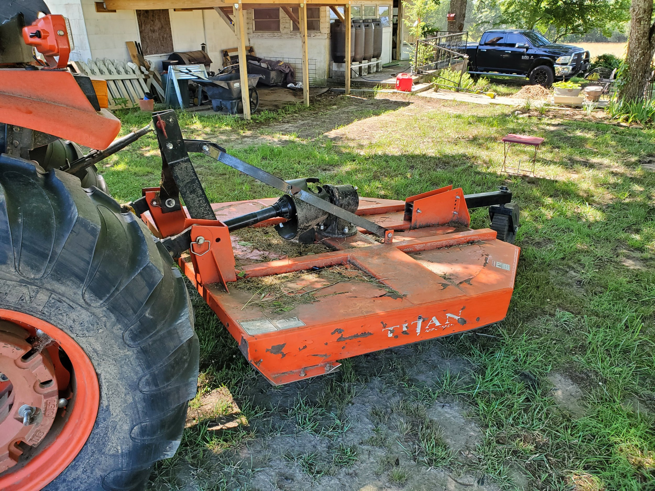

I have a titan implement 1306 cutter that I believe the clutch has gone out on. Anything other than light grass just doesn't cut and sounds like I'm loosing blade speed. The clutch gets super hot too. Where can I find info on replacing the clutch disc's as well as the specs for the bolts etc.

Check to see that the clutch disks are clean first. I would try somewhere between 25-30 lbf.
