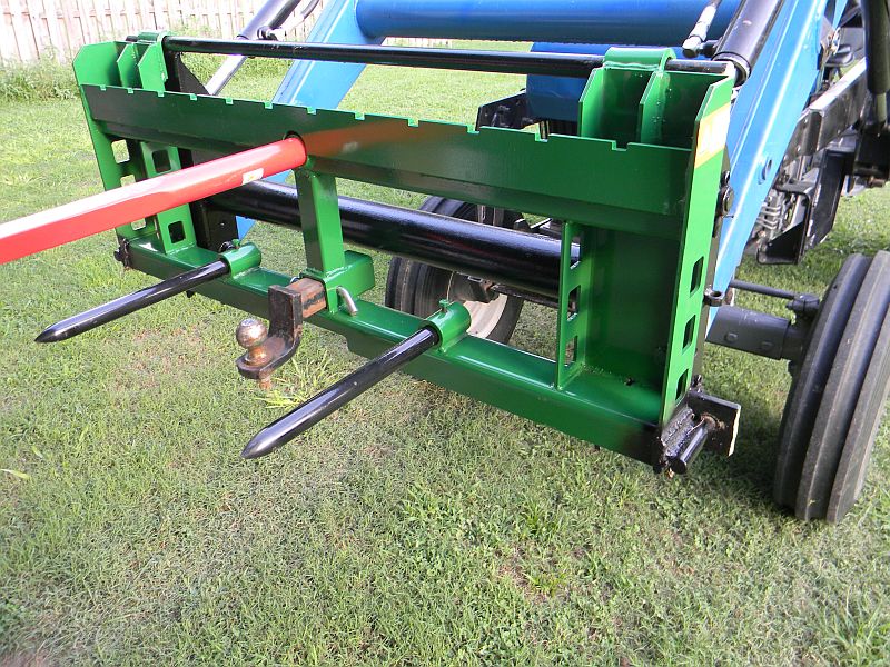

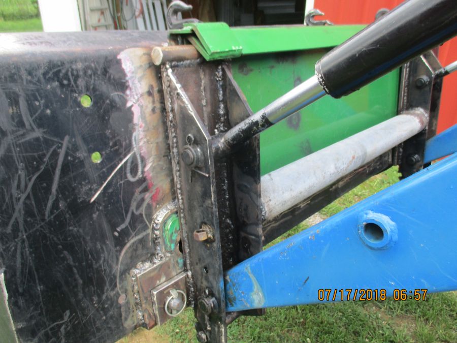

I have been asking a lot of people about converting this Bush Hog loader to quick change. My neighbor help me with this. We used all the scrap metal around here and what we could find.
We burned the brackets off the loader and welded plates on the bottom of them. Had to saw pins off the hay spear and make my own. Bush Hog loaders are wider than John Deere so pins fall right where bracket is. Not the best looking thing in the world but will do what I need. The bucket will fit on the same way. I ordered one of those Titan weld on plates. In hindsight the hooks and pins were all I needed.
