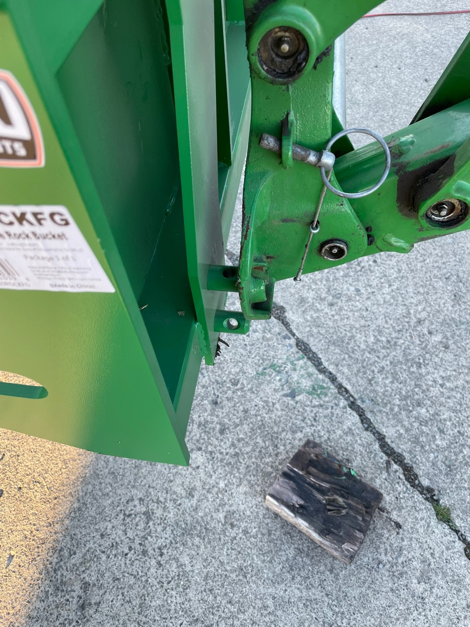

I want to share my experience with this attachment with the other forum members. For some reason, I cannot leave a review on the vendor’s website.

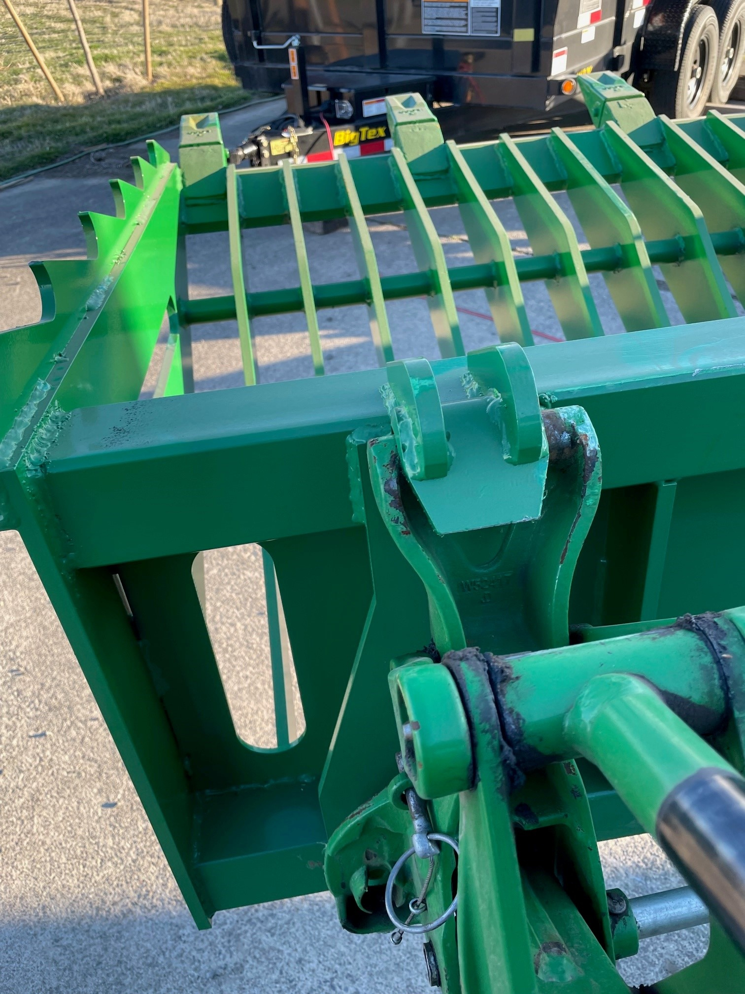

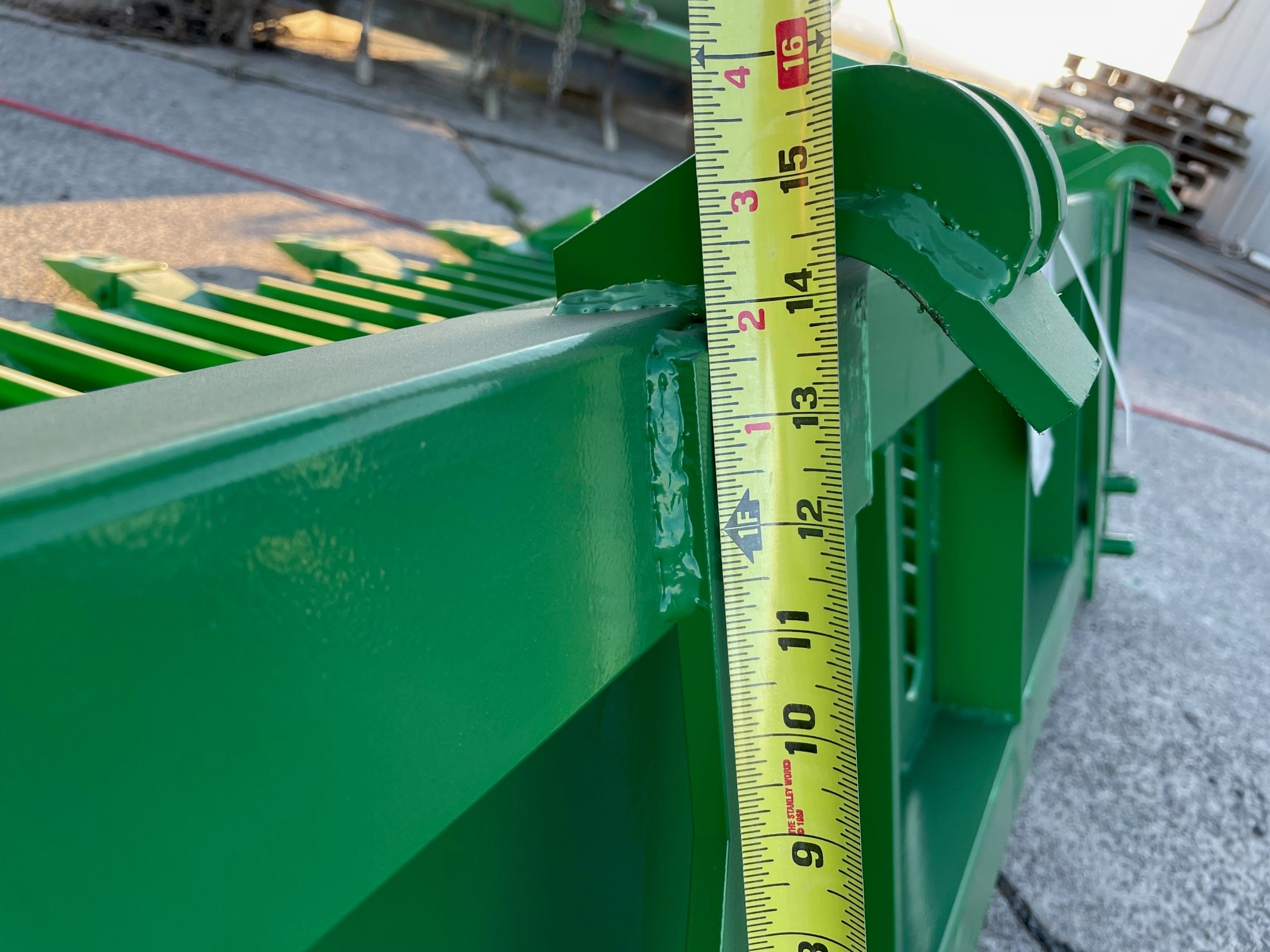

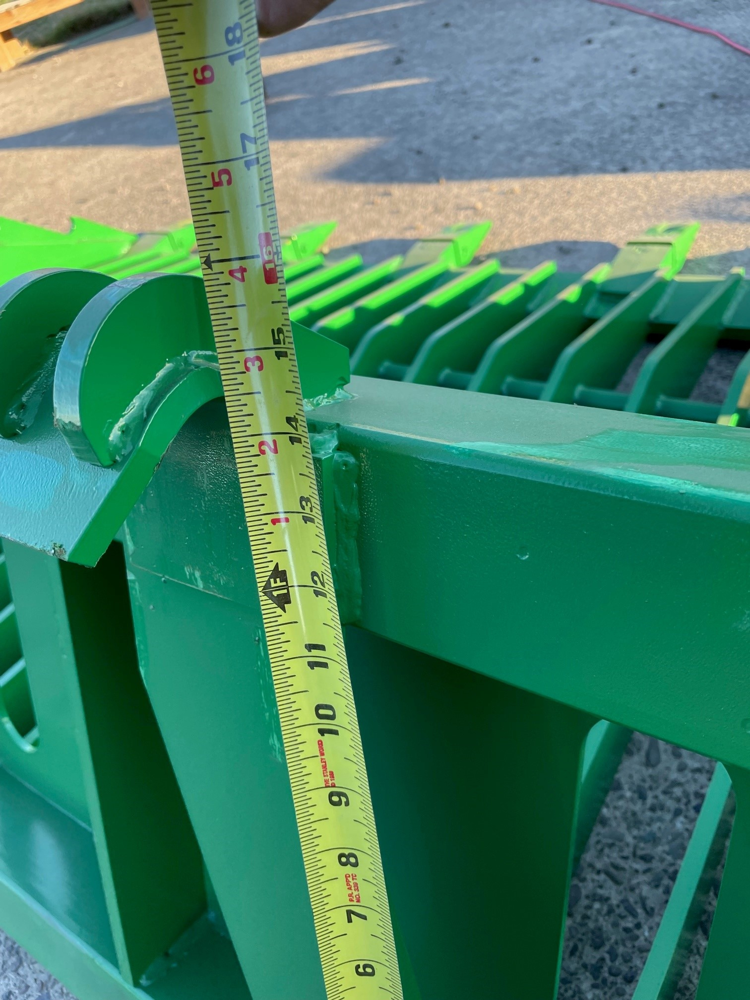

I purchased this rock bucket for my John Deere 4052R. The attachment appeared to be very sturdy and stout. Unfortunately, it would not fit on my front loader on the left side. I found the distance on the attachment between the hook and the pin was 1/8 of an inch short on the left side. (See photos)
It took one email and four phone calls to get this resolved. Once I reached the correct person and sent some more photographs, the issue was resolved quickly. They arranged to have the implement shipped back at their expense and they quickly shipped a replacement. I was very impressed by the speed of the shipping. Unfortunately, the 2nd implement had the same defect on the left side. I refused that shipment. Titan refunded all of my money.
Ultimately, I purchased a rock bucket from Redline Systems, which fits perfectly and has worked very well for my needs.
I hope this post is helpful to anyone experiencing a similar problem.
