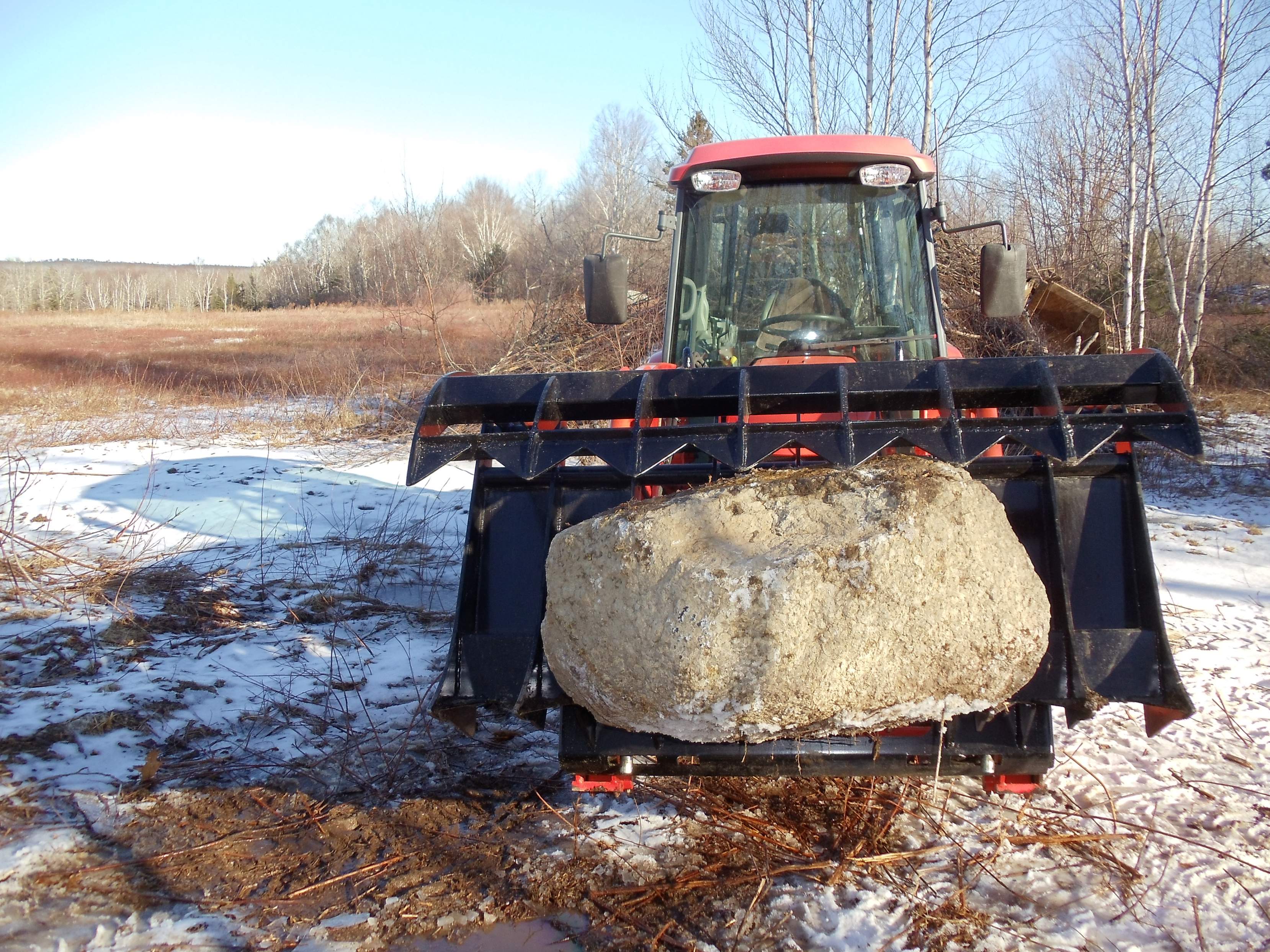

I just got the 60" Root Grapple Rake and think it was very well built. I found that after using it while picking up a rock I bent the top tines (two) . I had a friend weld some gusset plates between the top tines, and a couple of hooks on it. This has made it so much stronger then before . I've been moving trees and rocks with no more than missing some paint . I'm very happy with mine so far .

First One,
You only had to weld on the top tines, correct?

Yes , that is right, and a couple of hooks . Made all the diff. in mine to make it stronger. I needed it to be able to move some lg. stones ,that's why I had it done. But mine is not 1/2 " steel either , it's 3/8
