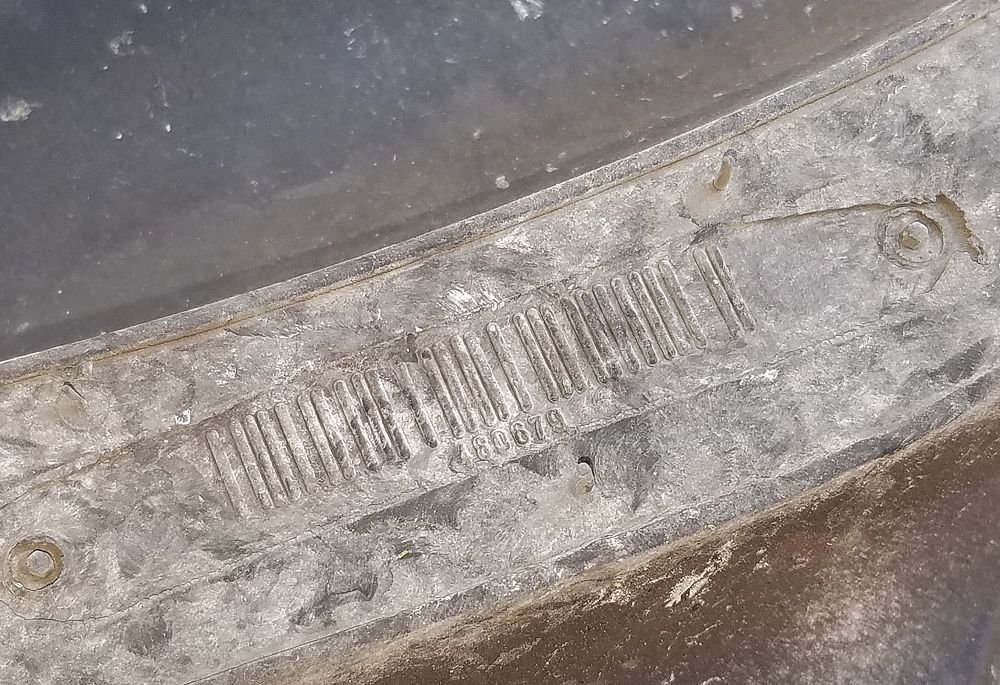

I JUST changed my tires, at a cost of $1400,,, I now have WAY more traction!! :thumbsup:
Maybe your L118 needs a set of these tires,,,:D
They even molded the tire size into the top of the tread bar,,,
Does that give me more traction?? :confused:
:laughing:
Seriously is it not there so a shop can tell the size when there is a stack of tires on their side? Just what I have always assumed...yes I know what that means is why I am asking.
   / Tires started slipping this year #10
That was meant as an LOL moment,,, heck, one of the bars even has the bar code on top of the tread,,,
They put the flag on the sidewall,,
