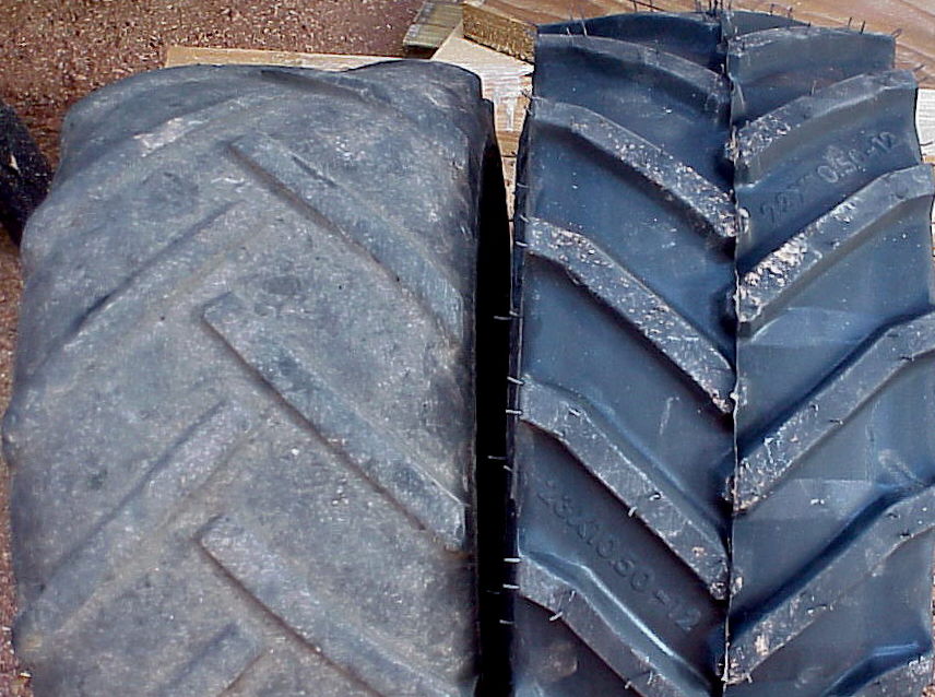

Here is a side-by-side photo of my worn out OEM Carlisle Super Lug tire (520 hours; used on our rocky decomposed granite 'soil') next to the new Carlisle Tru Power tire that I purchased from Tire Wholesaler Selling Tires for ATV and Trailers.
The price was the same for the Super Lug and the Tru Power. Delivered, the total cost was $145.68, more than I would have thought - $72.84 each, but much less than the lowest local price of $93.00 + tax each.
I received them in about three days. Local suppliers said they would need about 5-7 business days for the higher price!
CAUTION:
The caution is that (as you can see in the picture) the Tru Power is nearly 1" NARROWER than the Super Lug OEM tire, and 1-1/4" TALLER. Both are 23 x 10.50-12. The Tru Power is 4 ply rated, as is the Super Lug OEM.
Practically speaking, the difference in width and height (only increase ride height by 3/4") should make no difference, as the diameter of the worn fronts and not-so-worn rear tires differs by that nearly that amount.
One ADVANTAGE of the narrower width is that my tire chair probably won't take so much paint off the side of the PT! the 1" decrease in overall track is negligible IMHO.

On these tires, I was just looking at the site and only saw ATV 6 Ply tires. I love the tread on those, wonder if they would work (26 . 12. 12) are my tire size.

Oh One other thing. I have both Super Lug and Tru Power. I put the Tru Power on the inside and the super lug on the outside. I figure my balance from tipping is in the outsides and my traction on the insides. but oddly, for me, the Tru Power feel / look less tall than the Super Lugs...

Carl,
Even if your tires have a different diameter when inflated, from different manufactures, there is a way to make sure they are both putting the same amount of tire on the ground. Raise both wheels off the ground, and take a fiberglass or cloth tape measure and measure the center of the tread around the circumference. If the smaller tire is at the correct inflation pressure, let some air out of the larger tire to match the smaller tire circumference, and then they will be equal.
