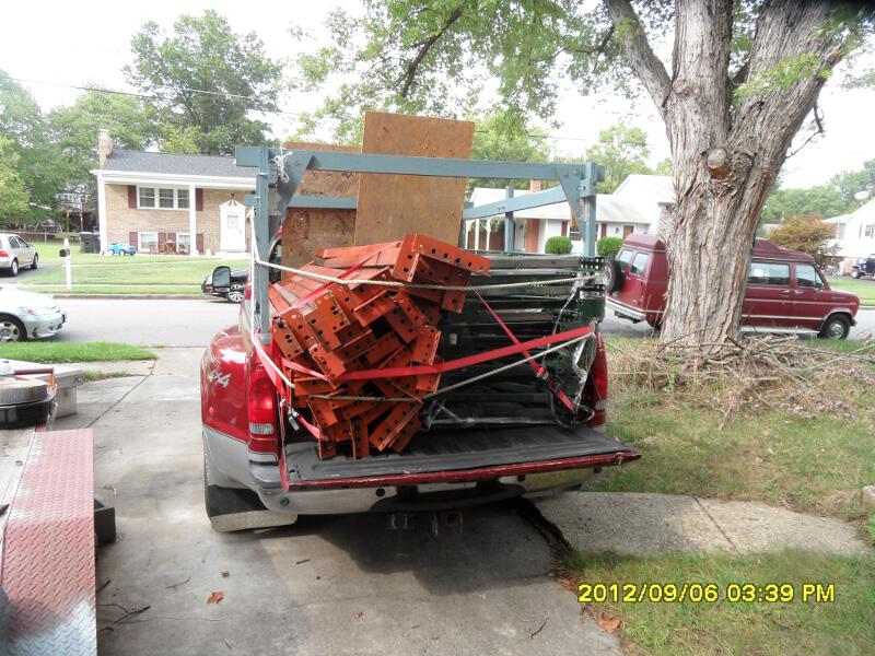

We've had this discussion a number of times. I needed a multipurpose truck, I can't yet afford one for every use. I wanted the dually for stability and payload capacity in a Crew Cab, 4x4, configuration. Per spec my "rated" payload capacity is about 1,000 lbs more than the same truck in SRW.
Just the little load of pallet rack I picked up, with what I had in the cab, approached the rated payload capacity of the SRW configuration.
It may be called a 1 ton but it's rated at about 4,240 lbs payload capacity.
The reason I want the lift is ground clearance, not looks.

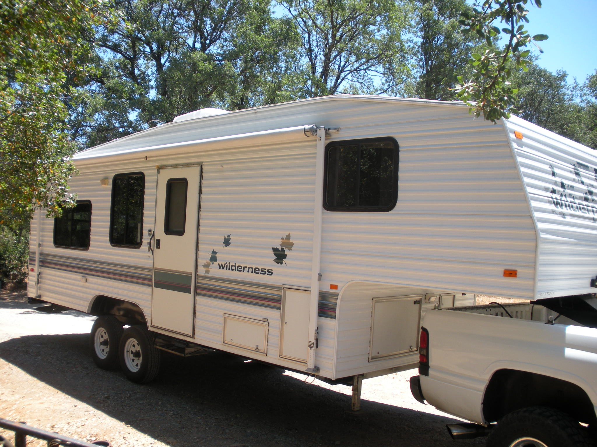

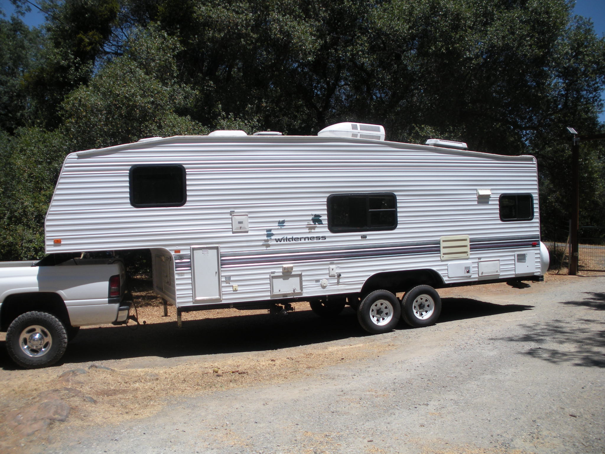

It is kind of hard to see, but just looking at the 5th-wheel wheel-wells, you can tell it sits 4-5" taller by how much open wheel-well there is. Ours is a '98 27', and had the axles flipped under the springs already when we bought it 3 years ago.
If it were not for that axle flip, the back bumper of the 5th-wheel would be real low, and the back of the trailer that is over the bed, would be in extreme danger of hitting the tailgate. The pinbox is adjustable, but not to make up for that much.
My truck is stock RAM2500 4x4. If it were to have any lift on it, the 5th wheel would need to be lifted further.... In the picture, the driveway is not level, so it does not show the truck/trailer level. On flat pavement the whole package is nice and level, and pulls like a dream. The 5th-wheel is a medium size, 27'.
Seeing some of the newer 5th wheels out there, some appear to have taken this in to account in their design. Still, a little lift, and the 5th-wheel needs some lift.
