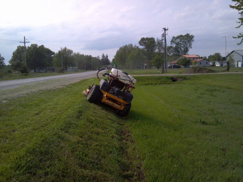

Decided to purchase a Hustler Super Z. I have one hillside in the 5 acres that I mow that might cause me problems with traction. I currently mow it sideways with a 4WD Kubota BX2200 and it handles it with turf tires. I used a demo zero turn from the dealer and lost traction going down the hill or trying to turn around on the side hill. My questions: I was thinking of using the Carlisle 101 Chevron Ag Tires. Anyone using these? And if they do not solve the problem, filling them with Antifreeze for added weight. Would that cause the machine to run rough as my lawn is not smooth to begin with? I saw a clip on Youtube of a guy that swears by the Carlisle 101's but for all I know he is Mr. Carlisle.

I think ag tires might tear up your lawn. Before I went to ag tires, I'd gain added experience with your Hustler and see if its a "do-able" situation. Other option - mow the hillside with your Kubota. Advise given by somebody with a big lawn & no hills.

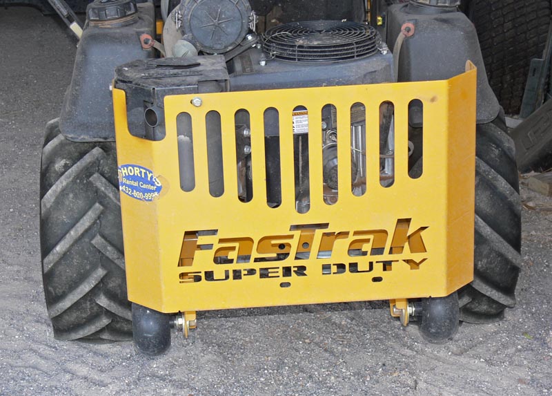

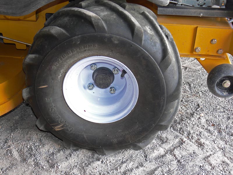

I don't know if these are what you are referring to
But they helped my mower.

I stumbled across a article about Hustlers ATZ & how they increased traction on slopes. One of the things they did was to reverse the bar tread tires. I tried it this morning & I think it helped. I didn't notice any difference on making turns on grass. Here is a link to the mower Hustler Turf
   / Tires for Zero Turn Mower
Any thought of why they reversed the tread pattern? I would guess that it might give better traction going down hills. I would like to see more traction on side hill mowing.
