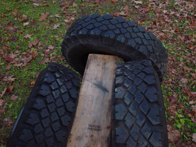

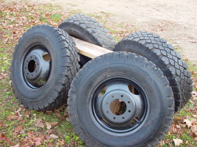

I have a set of four older M & S Goodyear 7.5 16 LT Workhouse tires and rims with extra off-load grip (see attached photos). They are basically unused in excellent shape even though they are old. The problem is that they only have a D load rating of 2540 at 60 PSI. What I would prefer to do is use them on my F250 for mostly off-road logging and trailing of lumber short distances since they have much better off-load grip. My my F250 uses M & S 235 LT 16 tires rated at 3500 at 80 psi so I am concerned that putting these lower capacity tires on this truck could be problematic? However if I am using my V-10 F250 for pulling heavy loads off-road or very short distances am I ok with the lesser weight capacity tire? The truck itself would have very little load in the bed but the trailers I would be pulling would be rated at 14K. I would be using a weight distribution unit so some of the weight of the trailer would be redistributed to the truck.
If this is not possible I am then considering just using them as spare trailer tires or just sell them at this point.
Appreciate any thoughts. Thanks

You say these tires would be used "mostly" for off road. As long as you stay off the road and remain at lower speed and gear,you should be safe. On the otherhand,I would avoid using any tire that does not meet the spec for your truck for use on hard pavement at highway speed. Murphy's law would be in full effect.

Any modern tire that is 6 years old or older is a grenade waiting to go off. I would not put them on my truck or trailer because with my luck I would not make it 5 miles down the road. Especially on the truck since you will be losing load capacity.

With those 4 tires, your allowable load would be just over 10,000 pounds. Probably OK for an F250, but still on the edge even for new condition. However you say they are older. How much older? There should be a production date on them. A few years are fine. More than 6 is not good. Age and oxidation will make a good "looking" tire into a time bomb.
14K pounds is a lot of trailer. If a tire blows on the trail, will the truck be stabile enough not to roll? I'd be concerned about damaging your truck. If its a just an off-road beater truck, then have at it.

Thanks for the responses. I will follow your advice and not put them on my truck or trailers at this point. I am not sure of the age but am sure the tires are at least six years old. I bought them at an auction two years ago thinking I would use them somewhere around the farm. They were owned by the city and apparently only used a few months for off-road work and then it just sat in their garage. Online I see they are listed as a "Workhorse Extra Grip tire - Studdable On-/Off-Road Work Truck Tire For Commercial And Farm Applications".
What I was thinking was using them in an area this winter with the F250 4X4 where I will be logging. The problem of course is switching back and forward between the tires when I want to go over the highway. On the trails I go very slow and everything is pretty flat so even with a tire failure can't see a big problem.
I see new tires that are similar to ones I have going for around $190 a piece. So if I sell them I would hope I could get at least $300 for a set of four with rims. For someone considering just off-road farm work might not be a bad deal.
