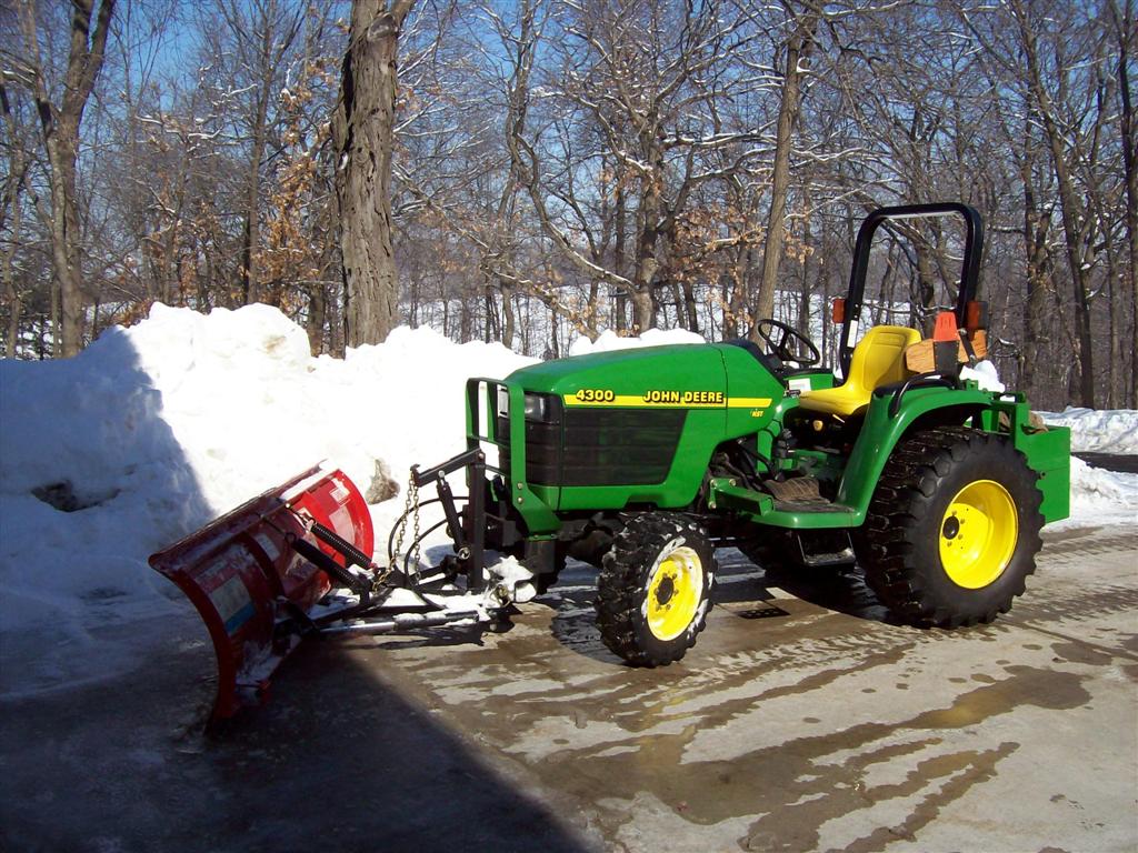

Have R4's on my 4300 and don't find them a problem at all on my grassed yard. Hold up very good in my woods working on trails and brush hogging, as well as pulling out logs and trees. Some slippery on snow when fresh and forming ice (such as our last 6" storm this past weekend but chains on the front tires cured that problem very quickly).
